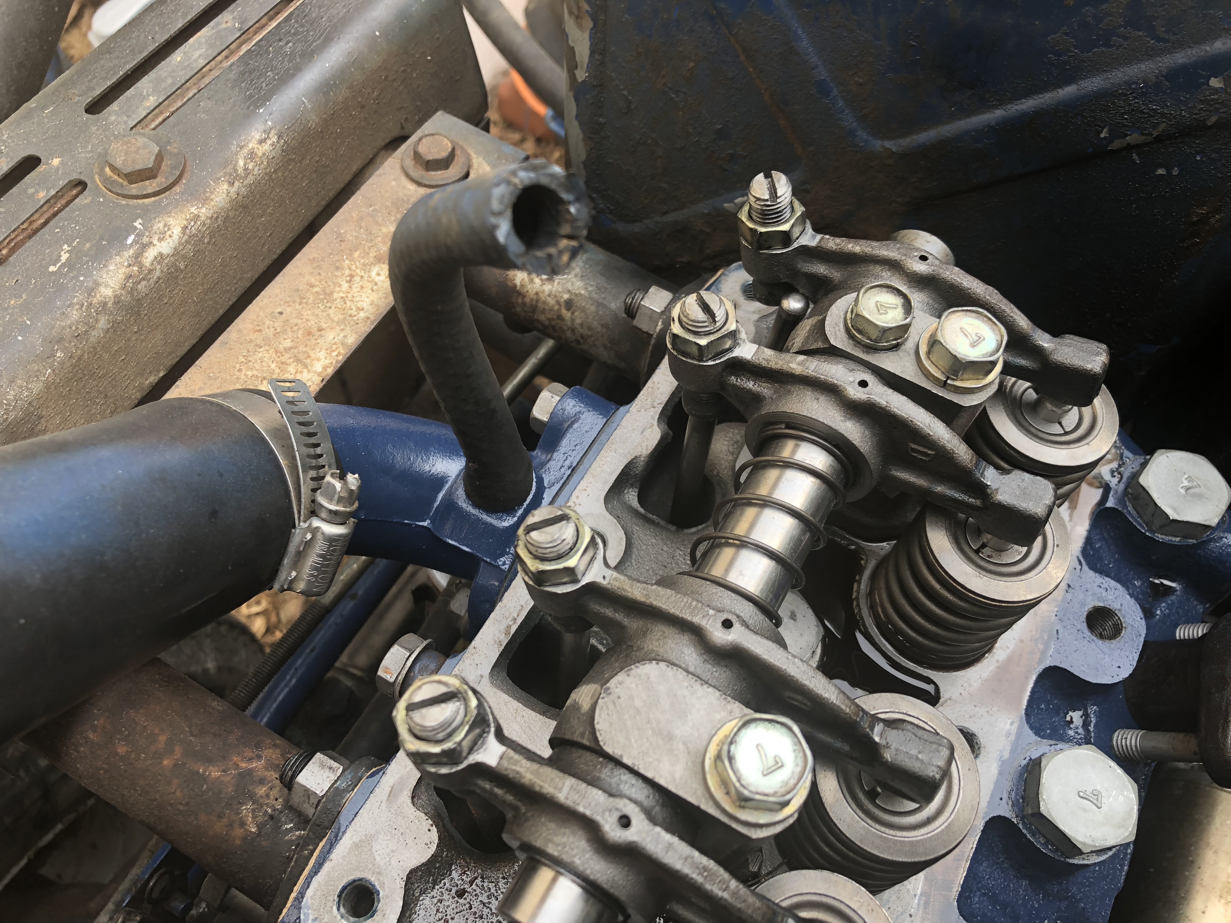

I can not find my manual, Im not sure where it went, but no manual can be found. Im thinking I did the valve adjustment procedure incorrectly, I was just adjusting for tolerance off of the paper that NCW included with the pistons, and gasket set. Is it possible for someone to help me out with a few pictures of the valve adjusting procedure?
When I get home I have a few things to try, but the first thing is compression check and will put some oil in the top of the cylinder to help soak the rings if its low. Then pull the valve cover and see if Im getting oil up there and do a by the book valve adjustment. There should also be something in the manual about a ring seat procedure. My friend at work was saying that I might have to run it at certain throttle positions for a certain length of time to seat the rings properly? Does this make sense? Ive got the wife looking around for the manual, I looked for an hour or so before bed, but couldnt find it. Im hoping it didnt get thrown out during some junk mail stack cleaning. :confused:
   / 77 Satoh Beaver S370D wont start, low compression
#137
Compression is at 350 for both cylinders, at least I have consistency. Im suspecting I have a valve adjustment issue, but I still cant fine my manual. Im not really sure what to do right now, i think ill put some oil in the cylinders while i take the valve cover back off. Im getting smoke coming out of the crankcase vent, if that helps a diagnosis.

Tractor is running pretty good, I had a little leaking on the valve cover, but I tightened to 20ftlb and that took care of it. I had them at 15ftlbs by the bolt chart on the paper NCW sent, but I guess it needed more. I still cant find my manual, so hopefully I can find it soon or I guess Ill order another one. My issue was an improper valve adjustment, each cylinder needs to be at TDC, and that matters, lol. I had to take off the radiator to get to it, which was a lot easier than I thought it would be. I found TDC by using the balloon trick. I put the compression tester nozzle on a glow plug and attached a balloon to it, then rotated the engine until the balloon blew up and kept going until the balloon was sucking in on itself and back and forth til I found an equilibrium and that was TDC. I used my feeler gauge at 0.014” and all the valves needed adjusting. Cylinder 2 was way off because when I did the first adjustment, #1 was already at TDC, and #2 was around the bottom of the stroke. The push rod, as you can see in the previous picture came loose, and was not helping my non-starting situation. Luckily no damage was caused by my rush to get it back together.
