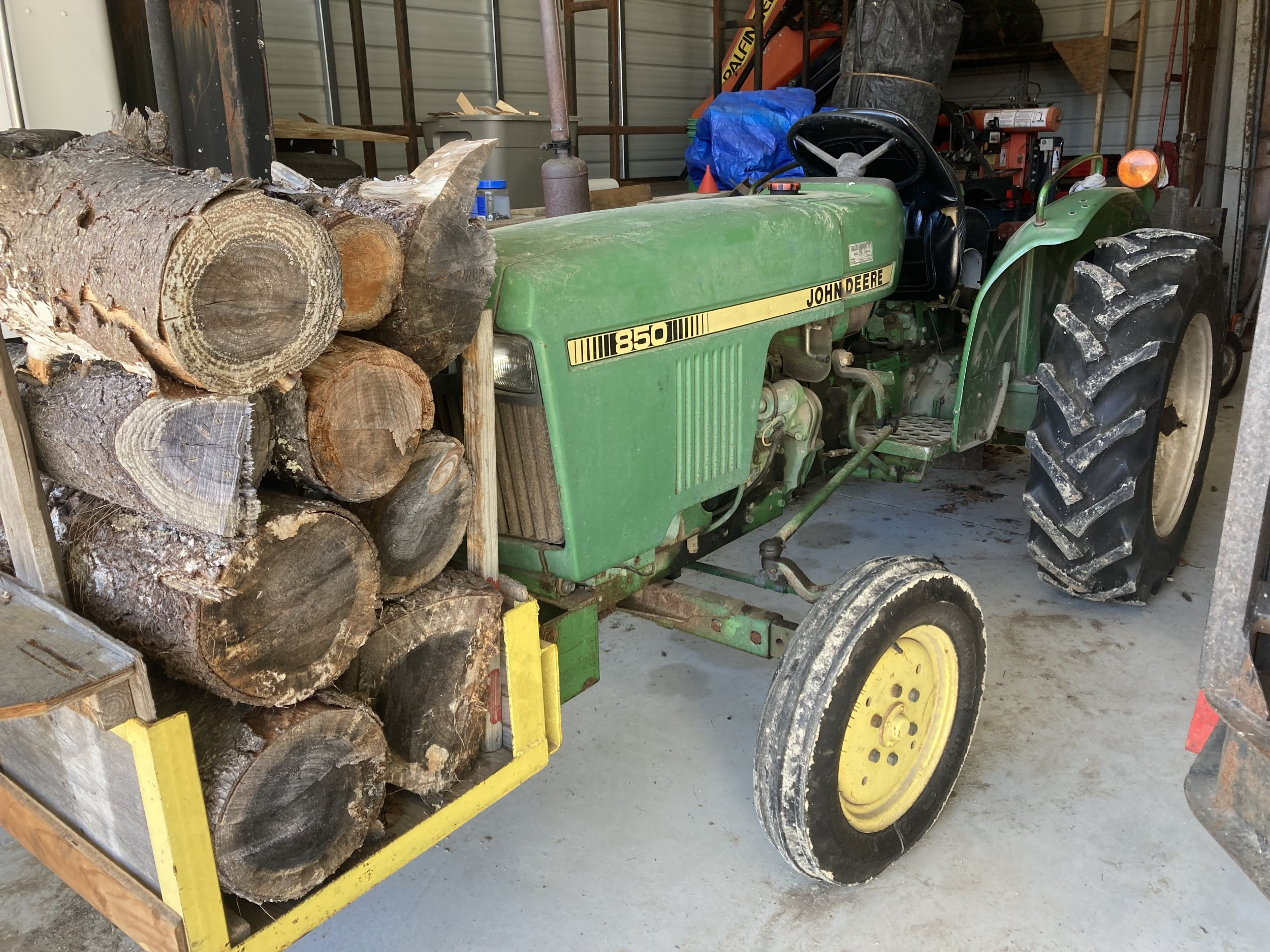

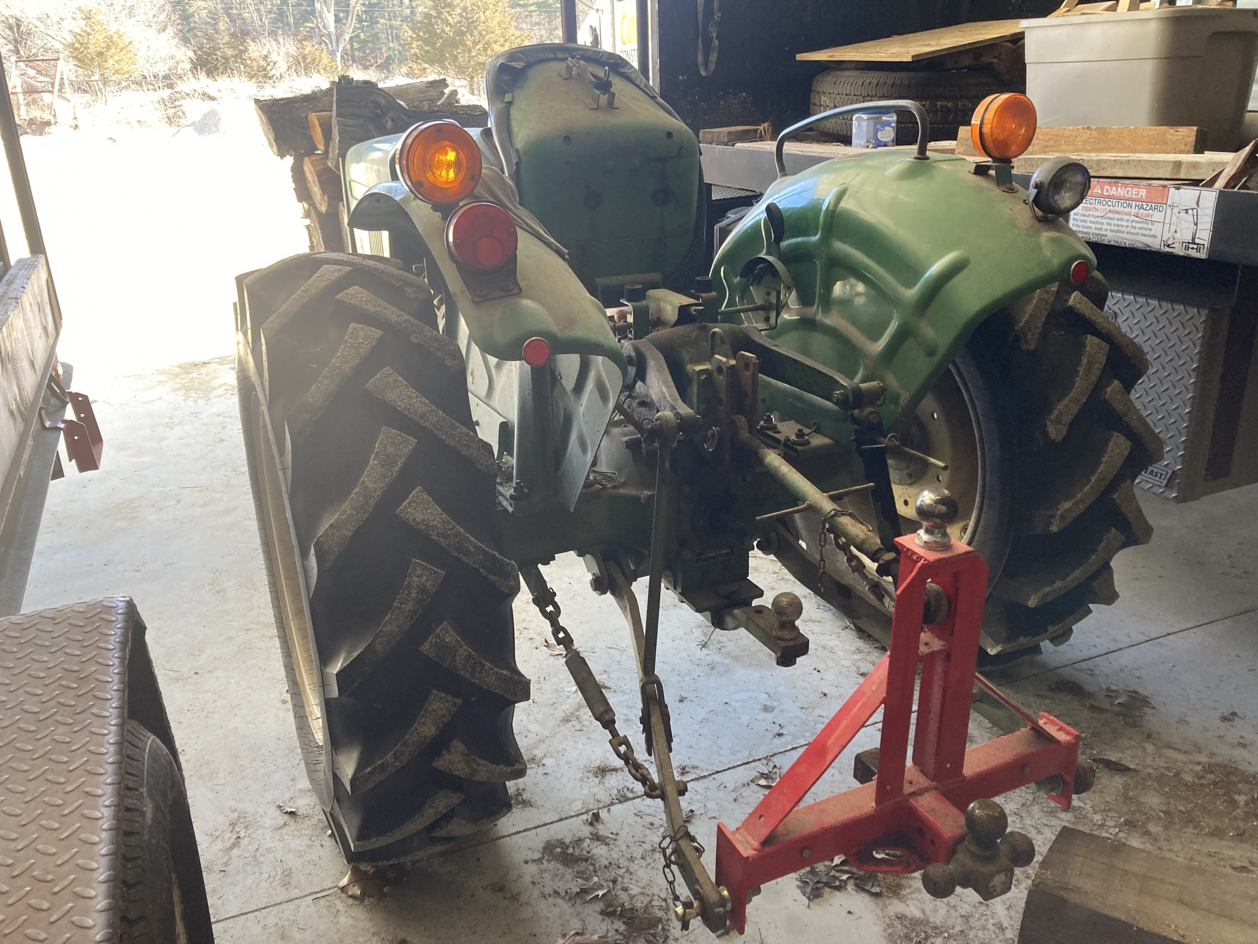

I've learned a lot in the last few years. Here are a few pics that I currently have:

like the vintage 850, a hoss, OP: update progress

rock solid, tires & sheet metal looking good. had a TO 35 for 28 yrs, but yours is a notch up the vintage ladder
   / 8n running a 6 foot hog #19
Everything is kept under cover and we generally are very respectful of our equipment. That 850 has thousands of hours on it and is 43 years old.
