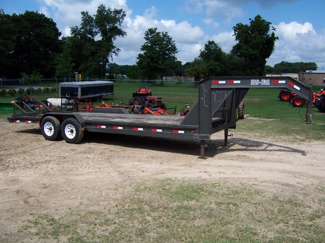

well, I went and looked at a lot of junk today.
the 5th wheel trailer was junk.. had some hokey electric over hyd brakes and all the wires were snatched out.. ramps ripepd off.
looked at 2 goosenecks that were cheap.. 2000 and 4000$ 2000$ one was tri axle.. and had not a single good board on it, and alot of bad plywood on top of that.. all mismatched tires and sizes :)
the 4000$ one looked kinda ok, but electric brakes are out of it.
on the way home stopped at a used tractor dealer I've bought from before, and he has a 7x24'gn on consignment from one of his customers up there. deck is weathered but solid.. metal looks good, ramps are good, tires are good.. cost is 3900$
I'm seriously considering this one... I think I can get 2 antiques on a 24' trailer.. :)
guy will even deliver it to me if my gn adapter isn't in yet.
any opinions?

My only question would be does the size fit your needs? It looks like you lose some room with the ramps on the deck can you stand them up?
I would look at the tires and make sure they're in good shape. I do like the dual jack and wish I had that on mine.
   / 92 3500 or 90 350 #98
You've got a high capacity truck that can handle a good size trailer. Since you haul some fair-sized tractors, I'd recommend at least a 28' dual wheel tandem trailer with a dovetail and folding ramps. Check Craigslist, there's usually some pretty decent trailers like that for not much more money.
The trailer you're looking at is pretty decent. I wouldn't want less than a 16" wheel and 7000" axles. Ground clearance looks pretty low and the rear can get hung up pretty easily. I'd look for a bigger gooseneck trailer with the deck over the wheels. Tractors load easy when the trailer has a dovetail.
any opinions?
soundguy
You can probably can get a "deck over" 24 ft for just a few dollars more if you want to wait and see what shows up...most folks find the fenders are a hindrance, whereas a deck over trailer is just as wide but has 8 1/2 ft of deck space vice 7ft. That's what I settled on and I'm happy about it....BobG in VA
