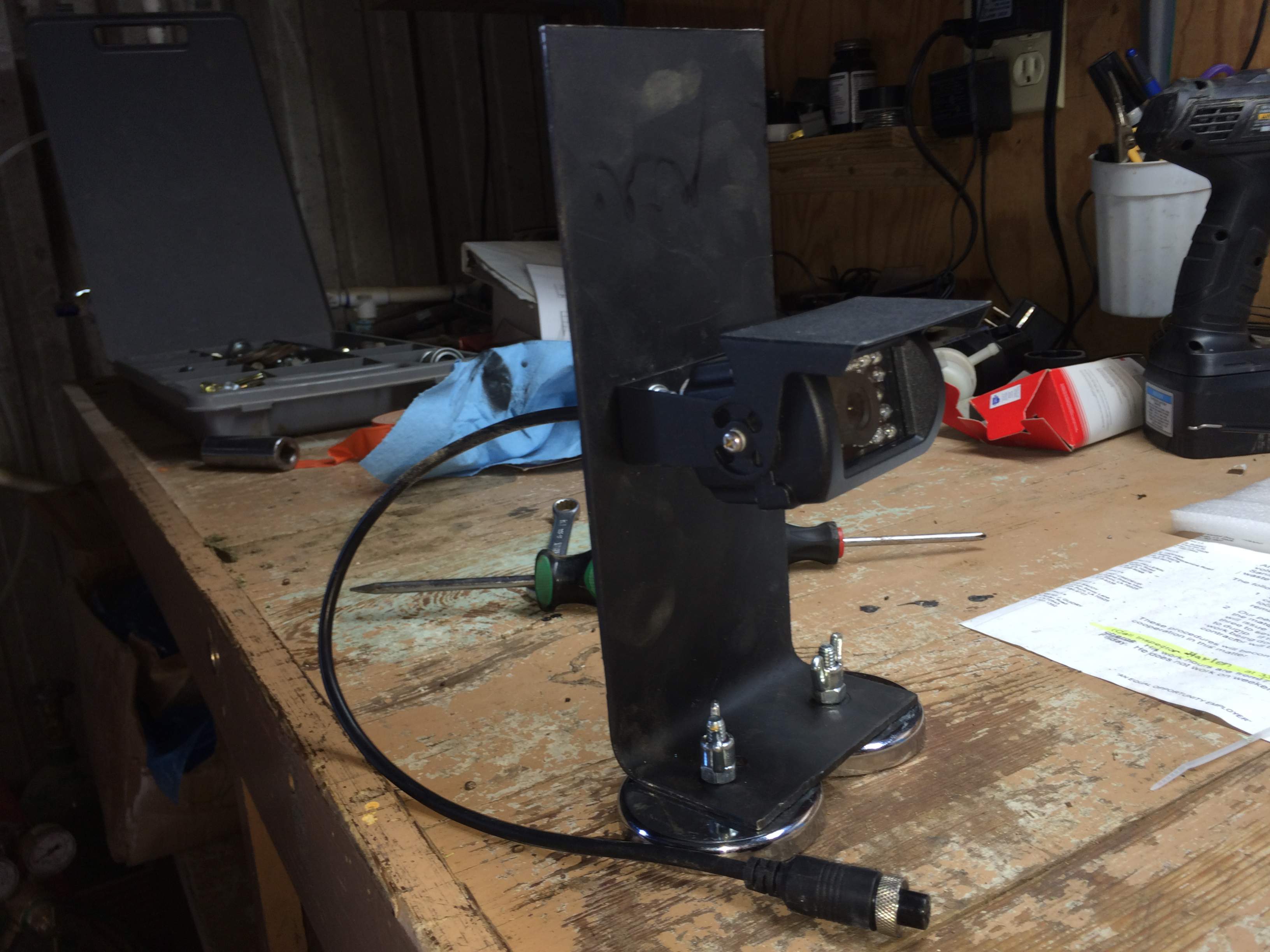

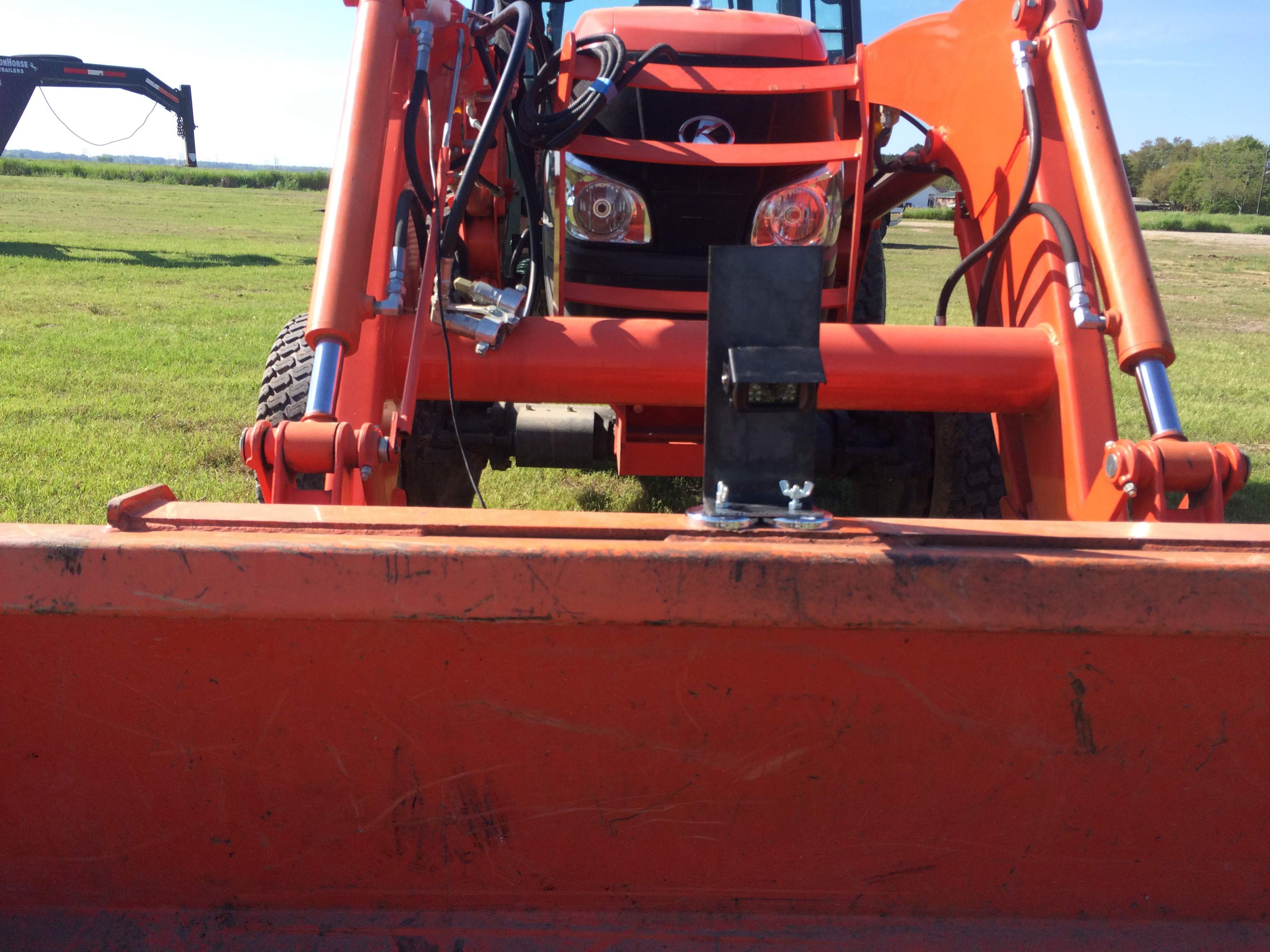

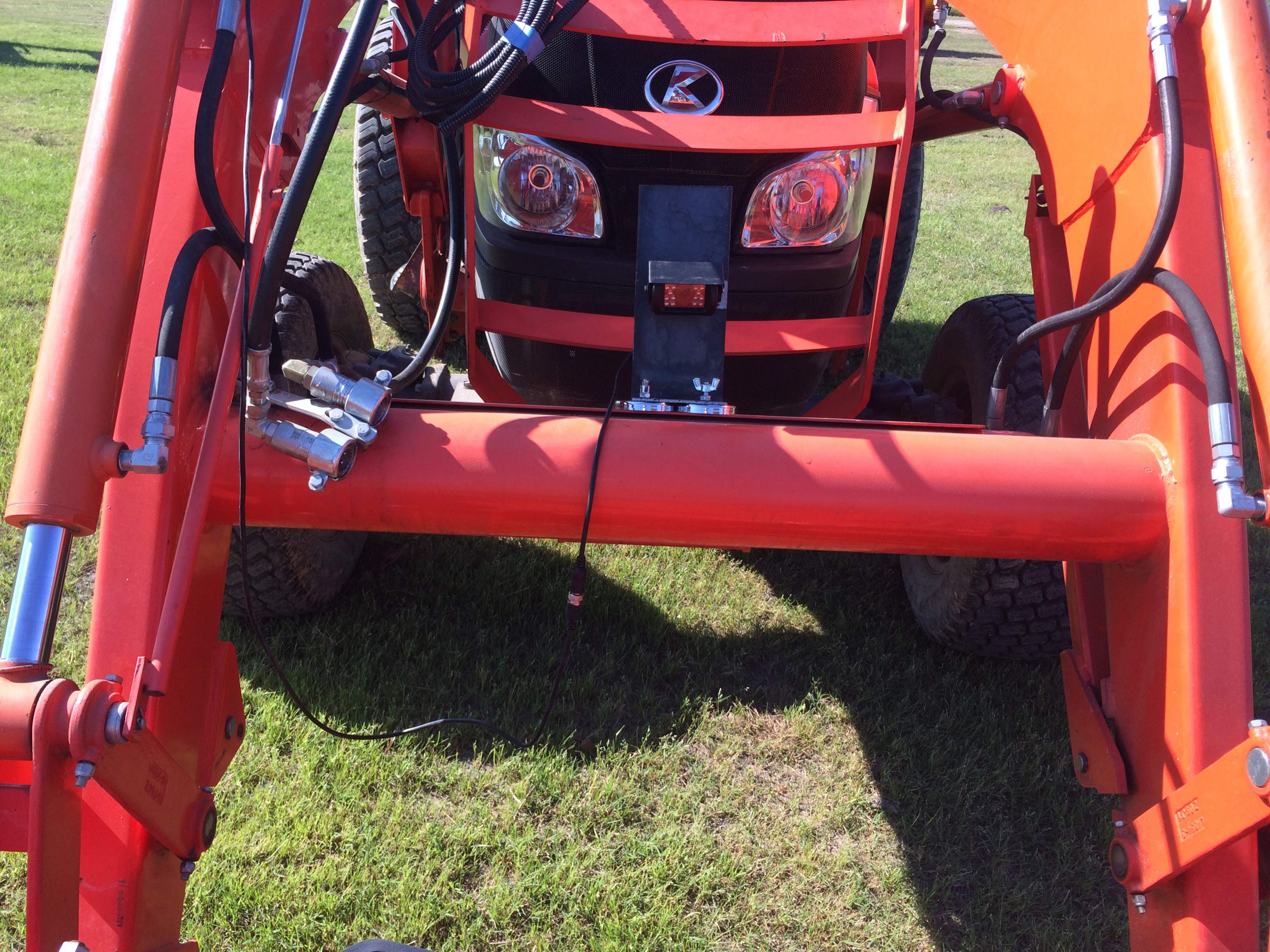

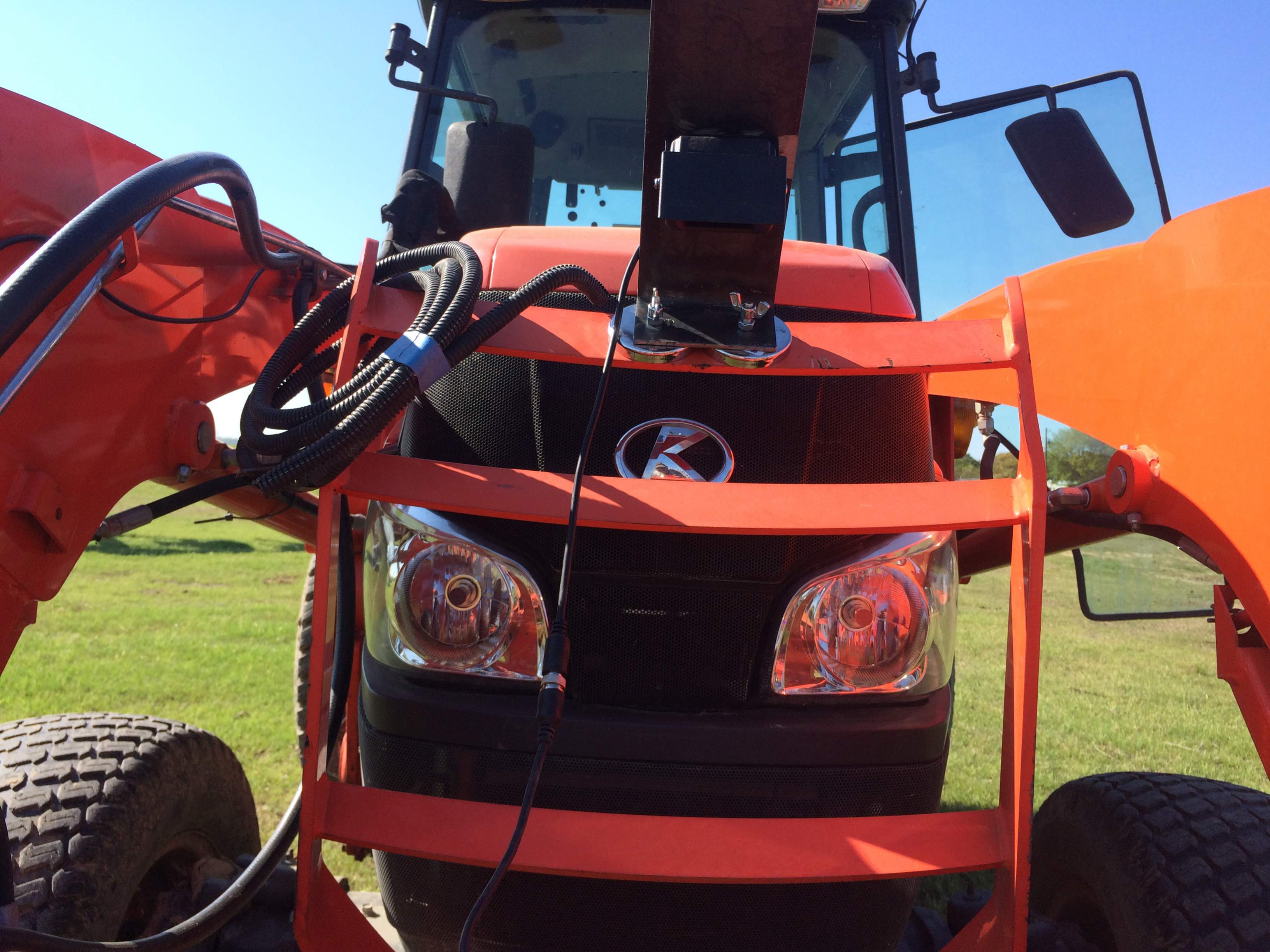

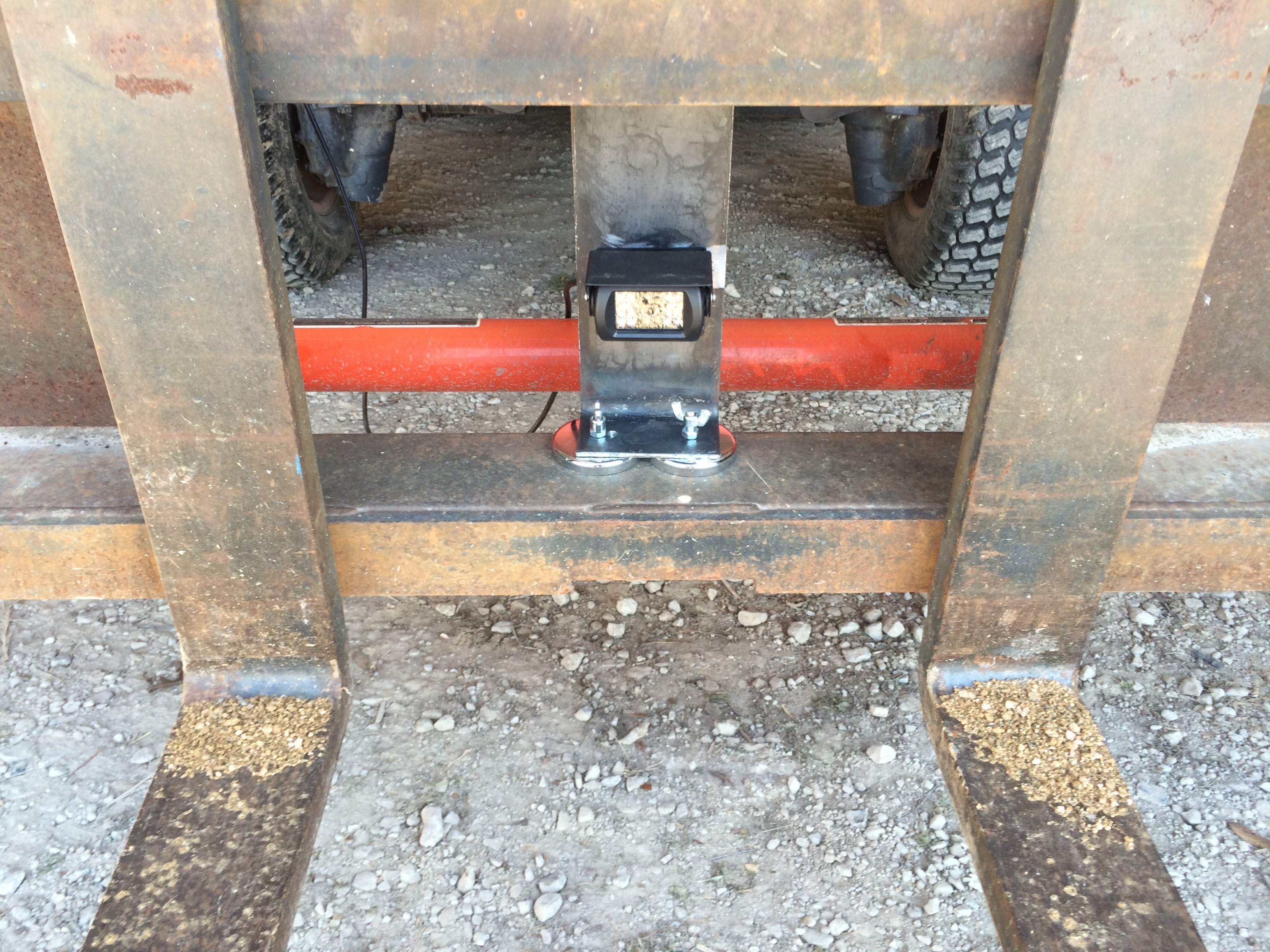

My magnets are delayed by USPS, so I went to my local CarQuest and they had some in stock. Got it mounted up yesterday. Here is what it look like on the bench before sticking it on my attachments.
Next are some pics with it in place. I really like the option of being able to move it around for the different attachments.
This first one is on the grille guard.
This next one is on the loader.

And finally, on the forks.
I think the magnets will hold it from any vibration or even any jolt from loader work. However, a stick or something will knock it off fairly easily.
The system overall is fairly simple, and is cheaply made. One of the connections must have got bumped and bent, and I was not able to thread it together very well.
Another thing about this system is that when you rotate the view, it rotates both cameras. This means that when I switch from one camera to the other, I will also have to switch the rotation view. A minor inconvenience. Also, the monitor is a little small for my bad eyes. And direct sunlight in early morning and late afternoon will be a bit of a problem.
Anyway, for the money (about $180 including the magnets) I'm happy with what I have. I will test it this week rolling out some sod.
