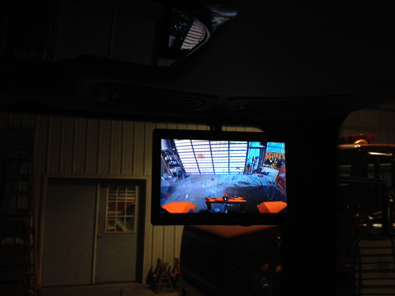

Here is a pic of the rear camera late in the evening, the cam is in the cab looking through the glass and gets a bit of glare when sun is shining just right into the camera. But over all think it's going to work out good. Will see how the front cam works with bucket and forks next day or so.
CB, try aiming the camera down some. Granted it is nice to see the horizon in both directions but it keeps the stuff on the three point below the center of view (where the best focus is). Aiming it down would also help prevent some of the glare issues, but could pick up more reflections from inside the cab against the glass.
/ A backup camera for $50!!!!!!!!!!! #347
The back camera is fine, I'm talking about the front cam.

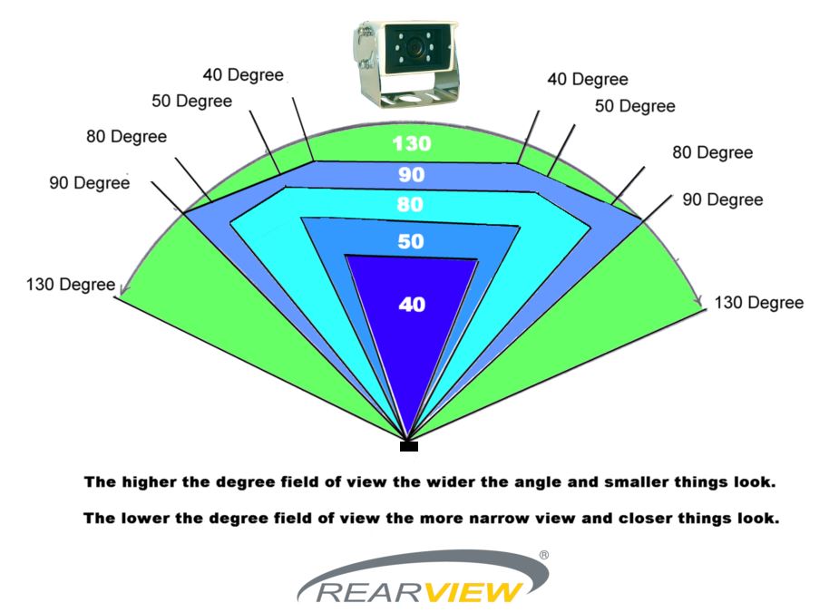

Camera field of view was mentioned earlier it this thread. Here is a visual aide.
