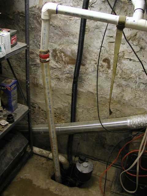

I brought the plastic pipe up out of the sump pit and created a joint at about 4 feet. I use a rubber sleeve and 2 ss hose clamps to join it to the rest of the discharge pipe. I have a spare pump standing by that has the same length of pipe attached to it. If the pump in the sump pit fails, I undo one ss hose clamp, separate the pipes, unplug the pump, swap in the new pump, connect the discharge pipe, plug the pump in and I am back in business.
Any chance you could post a pic of your set-up?

   / A lot of water #24
<font color="blue">Any chance you could post a pic of your set-up? </font>
It ain't pretty, but it works. /forums/images/graemlins/grin.gif

   / A lot of water #25
Mike
Yours looks neat compared to mine.
My spare pump is next to the working one.
Still in the box it came in. /forums/images/graemlins/tongue.gif

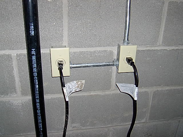

   / A lot of water #27
<font color="blue"> Inspector507...thanks much for your input on the electrical code for sump pumps. I'm currently finishing off half our new basement which is 40X17 in size...the sump pit is located in one corner and thanks to you I know EXACTLY how to wire it up now. </font>
Here's a picture of the wiring for our two sump pumps, wired to code...

   / A lot of water #30
</font><font color="blue" class="small">( Right now my sump pump is plugged into a GFI outlet, so I'm reading to hook the second one up to a different circuit? Is this because the motor burning out will kick the circuit?)</font>
I would definitely run the pumps on different circuits. That way, as you noticed, a shorted pump won't take both units down.
