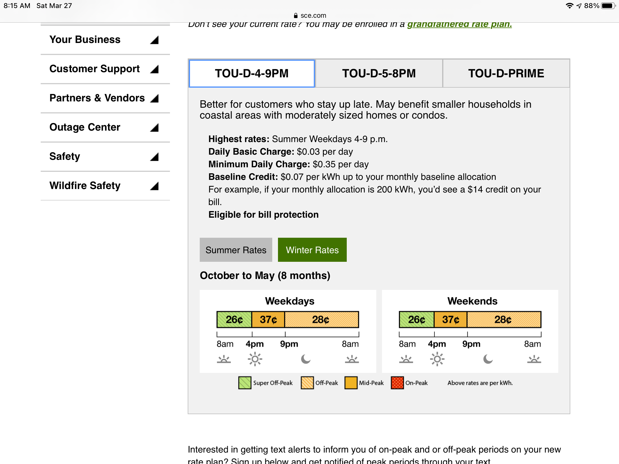

I’m in SCE here in CA. Grid tied and net metering. Per the attached I am charged/credited $0.26 during solar charging hours, $0.37 during “peak” hours (4 to 9 PM) and $0.28 during the rest of the day. Difference for net metering isn’t too bad but rates are ridiculous.
Oh, and these are winter rates. Summer rates jump to $0.27 and $0.54. They like to screw us desert dwellers.
California, PG&E, EV2A rate :
