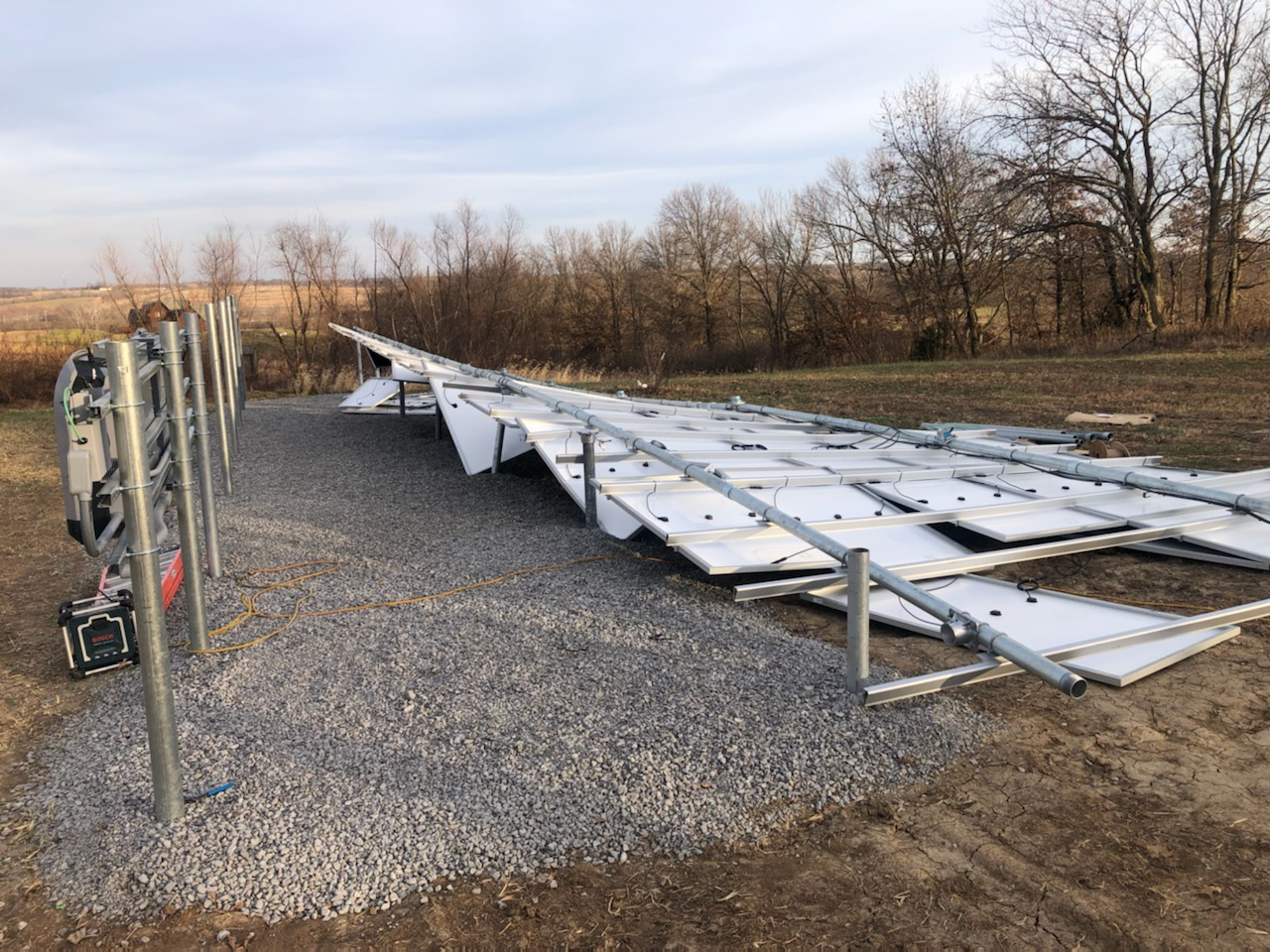

This is what happens when you forget to tighten the set screws on the top plates that attach to the vertical pipe. I can't imagine waking up to that.
img_0018-jpg.723955
:sick: 🤮 🤮 🤮
Was it your cousins fault, or did he have it all installed by someone? What a gut punch.
