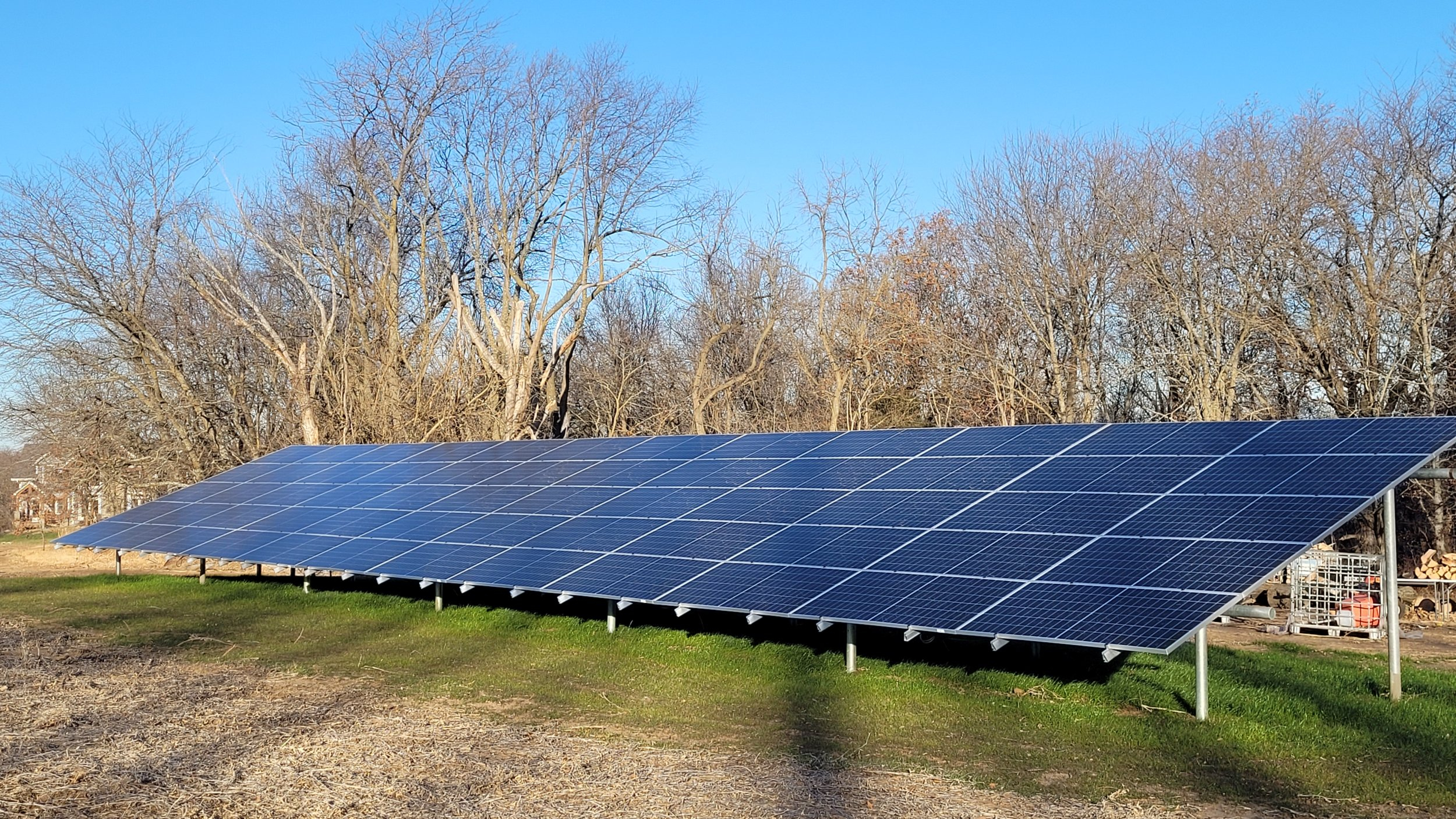

I had thoughts of having my ground mount be up higher so that horses could use it as a sun shade in the summer, but the standard mount needs to be installed near the ground and raising it would completely change the engineering calculations for wind.
There obviously exist these things (local businesses have large carports of solar) but considering the prices I'd definitely get something engineered even if you DIY the work.
I wonder about that too. I've seen where animal or tractor shelter where it's regular construction with rafters, and also purlins going across the rafters, with the panels screwed into both the rafters and purlins. The panels acted as the roofing material. Good ventilation below and some protection from sun and rain.
Sort of like this?
or this?
That's sort of what I was thinking about.
