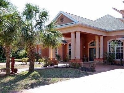

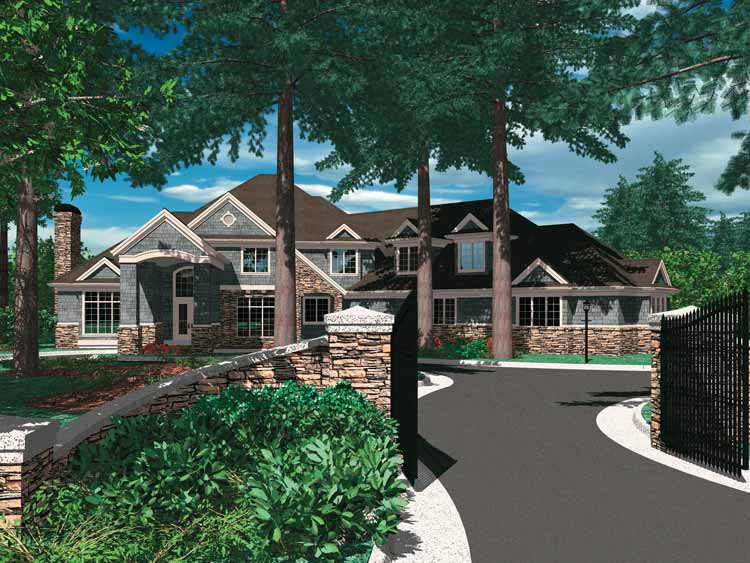

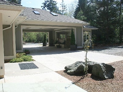

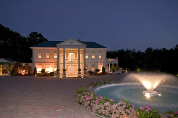

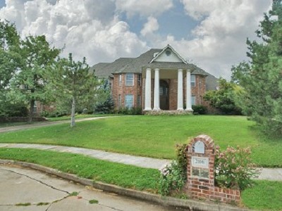

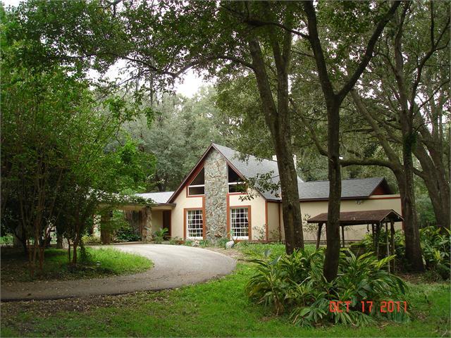

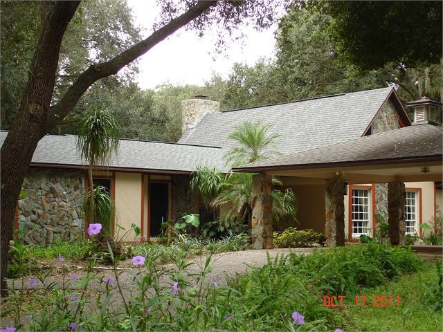

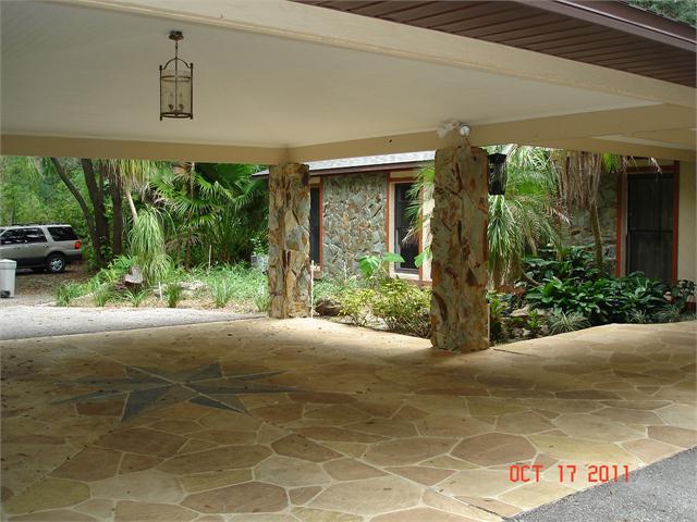

A portico (a.k.a. porte cochere) is a good idea, and I've always liked the looks of them.
Yes, that's what I was thinking of. I didn't know what they were called.
attachment.php
Google "drive through portico" and you can see lots of examples. I've attached some. These porticos make sense when a main level attached garage is not a good option and are frequently seen on upscale homes.

Yes, I am familiar with them, though they seem to be a warm climate architectural feature (note the pictures you found...). You almost never see one up here. Not sure why. To do something big enough to clear fire trucks would require some pretty massive redesign
