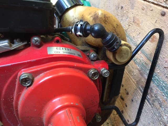

My weed eater has a squeeze bulb for priming the engine. I purchased it in '87 and the bulb replacement has been a regular maintenance item every year because they crack prematurely and their quality has been deteriorating with each purchase. Why can't they make decent quality bulbs?, I asked after I pulled out the last unused one in from a package and found it cracked. I never have to replace rubber gas lines - why not make them out of the same material? :thumbsup:So I did. I purchased thin wall (1/16") gas line, cut a 2" section and replaced the bulb with it. Squeeze it and the engine primes as it should. I made this change late in the season so time will tell if it lasts.

Stop using gas that has ethanol in it and your squeeze bulb life will extend drastically.
There are some places (Northern Virginia for example) that it is almost impossible to find gas without ethanol unless you buy in tiny quantities like the TruFuel cans.

That is sad. Small engines don't do well with ethanol. My Echo gas trimmer is around 10 years old and the bulb is still good. It has only had non-ethanol in it all it's life.

Ethanol fuel has been around for over 40 years, and the problem with small engines is they set too much, and the effects of water in combination with the ethanol is what causes the issues. Landscapers that run their equipment every day can run ethanol and don't see issues.

When ordering replacement primer bulbs you must check for ethanol compatibility.
