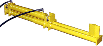

I have purchased a 3 point on Ebay for $250.00 . I had to replace the hydraulic hoses which I ran from the joystick control on the FEL , along with the hydraulic cylinder,which I downsized to 3.5 '' instead of four which decreased cycle times a little bit . I still can split whatever I put on it. I only have to run the throttle up about to 1/3 with this setup. And have less than $400.00 in it. You can also pick up a splitter kit from MetKit HomePage If you have a welder you could make this pretty cheap. There is a metal supplier that will help you if you have one in your area Metal Supermarkets Northern Tool has what looks like a decent 3 point splitter also and they have 2 models........ Northern Tool
   / Adding a log splitter to my GC2300 #17
Here is the one from Northern.......
