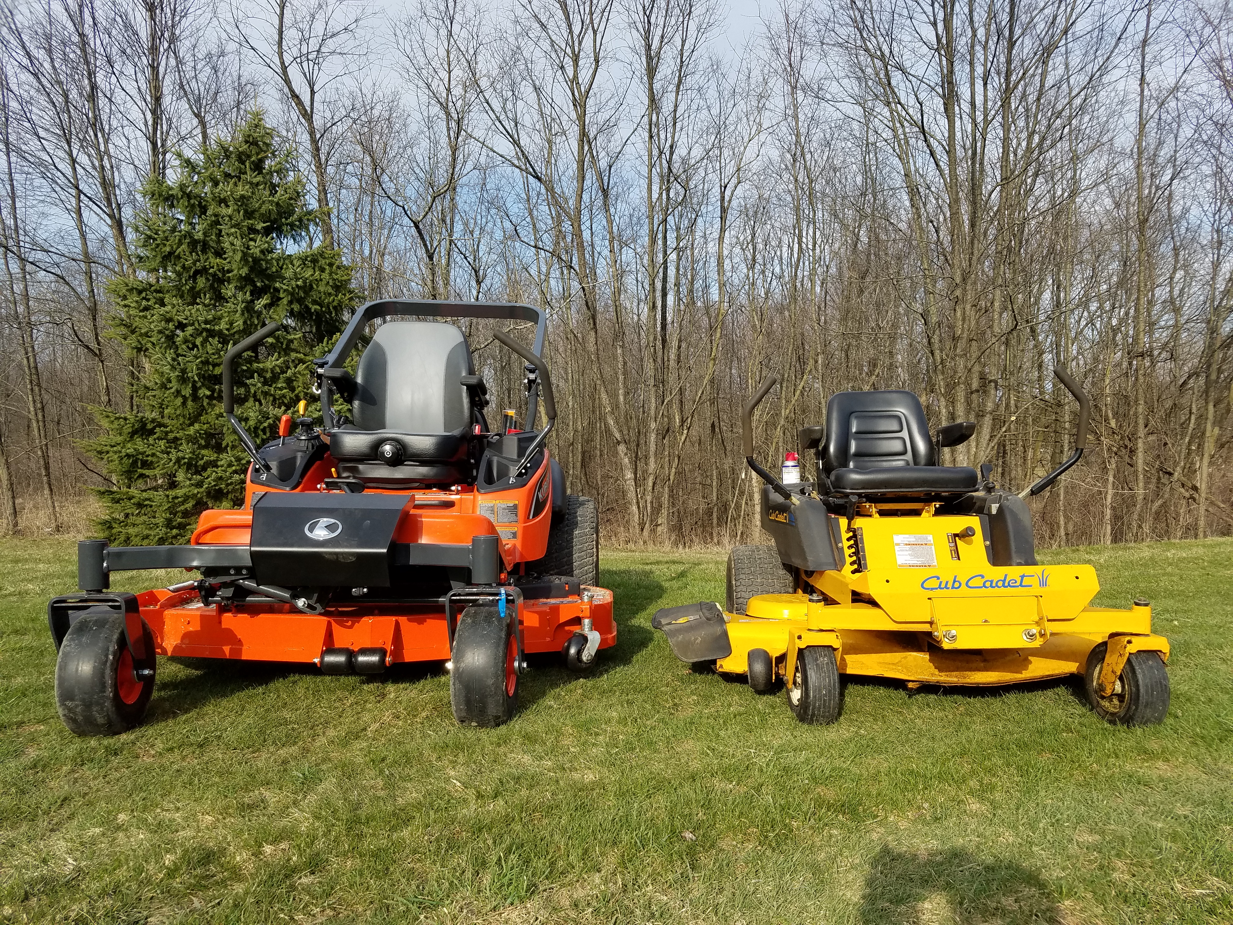

Well the day has arrived. Its here. I cant wait to mow with it. Its every thing the Turd Cadet RZT isnt fast, smooth, quiet, and well built.

In with the new out with the old. Cleaned up the Turd Cadet which I'm giving away. I couldnt justify selling it. I'm not sure how the manufacturer in good concious thought it was a good idea in the first place.
   / Adding a New ZD1211-60 to the Arsenal #16
Xring100...what issues did you have with your rzt? I have an rzt54 and it has been decent for me for the price. I do wish that I had simply spent more money and bought a more beefy zero turn...one with a fabricated deck, a suspension seat, and foot pedal for deck height. I have the kawasaki engine, which I like.

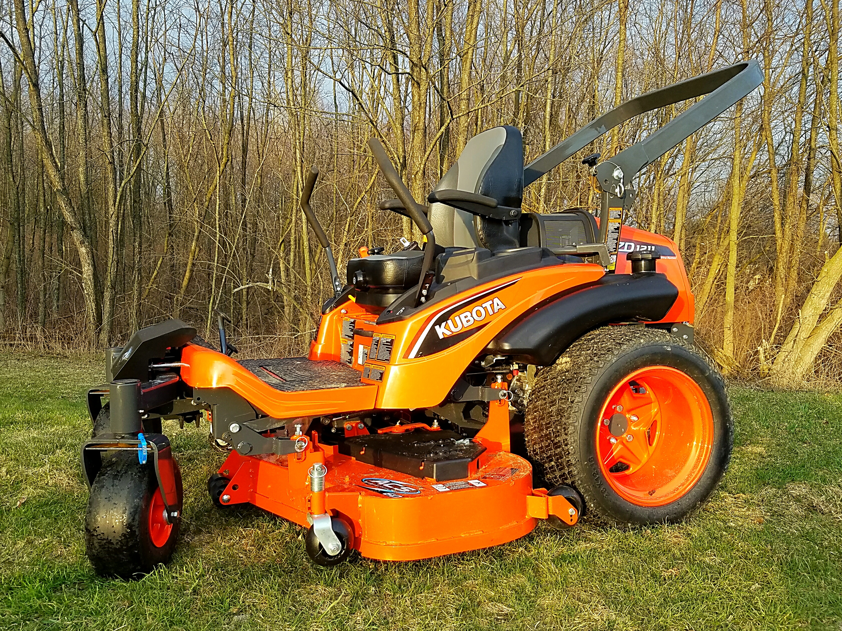

Thanks warment. To date with 15 hours i only have two complaints. The 1211s rear track width is just under 60" which is wider than the zd326 for stability. There is only about 3" of deck over hang extended past the rear tires on the trim side. I find it harder to trim around trees. Than the old cub. A
Kubota shifts the deck over to actually allow for some overhang on the trim side. On the chute side you actually drive over a few inches of uncut grass.
My second complaint is that with the rops folded down its still a remendous pain in the arse. Its in the neighborhood of 5 feet high in the lowered position and incredibly wide. I snagged a branch last week on one of my maple trees and found my self doing a wheelie as the rops slide under the branch. I have since trimmed a lot of lower branches from my trees. With the rops up it just clears a 7ft door. If the rops had a lower position you would not be able to open the hood. I have only very slight grades in my yard and have no need for it.
It has knocked 30minutes off my mowing time 42 minutes versus 95 minutes before. I topped off fuel at 6.6. And 9.9 hours worked out to just under 1.0 gph but some of that time was just pulling a yard cart and aerator. The briggs burned about 1.1 -1.2 gph and mowed 50% slower
The engine is silkey smooth and quiet compared to the old briggs. I think the water cooled cast iron block and hood help this out. It has what looks to be a about a 30-40 lb fly wheel attached which helps its from bogging down in deep stuff. Definetly a torquey engine compared to gas it might drop a few rpms but doesn't seem to bog down like the old mower where i actually had to slow down to let it catch up.
The cut is very impressive much smoother and way more uniform dispersion of the clippings. The high blade speed definetly helps but makes the mower fairly noisy when cutting
