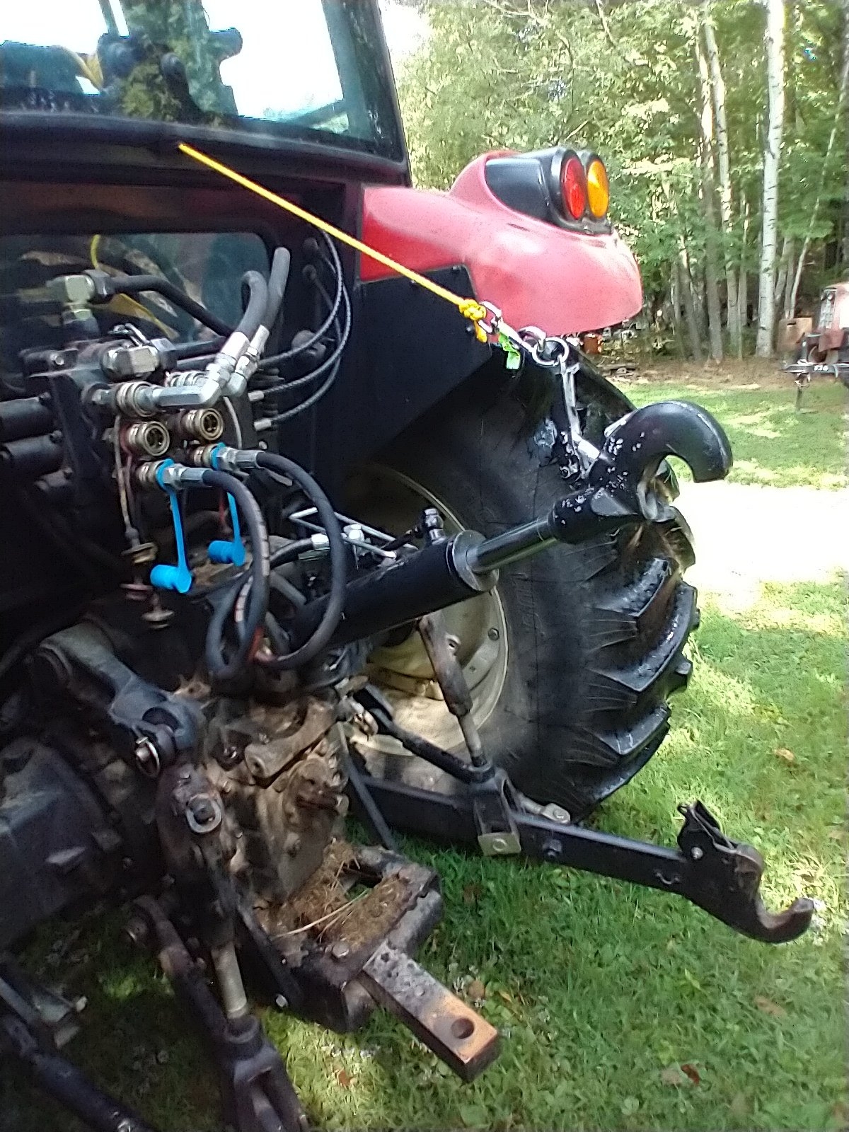

Looking through all the pictures, how do folks keep the top hook aligned while unattached? It's on a cylinder, so free-rotating right? Or as a practical matter does it just stay in the correct orientation?
/ Adding euro three point hooks #73
I have lower hooks from you, ~two years later I'm welding them up now :) I am also doing top-link now, and figure I'd regret not getting a hook for the top.
The top link cylinder can rotate as long as there is no pressure on it. I rarely need to adjust mine.
I just added a hook end for the top link about a month ago and so far I like it.
/ Adding euro three point hooks #74
I have a rope attached to the disconnect of the top link hook, when the top link is disconnected the rope is what is holding it.
