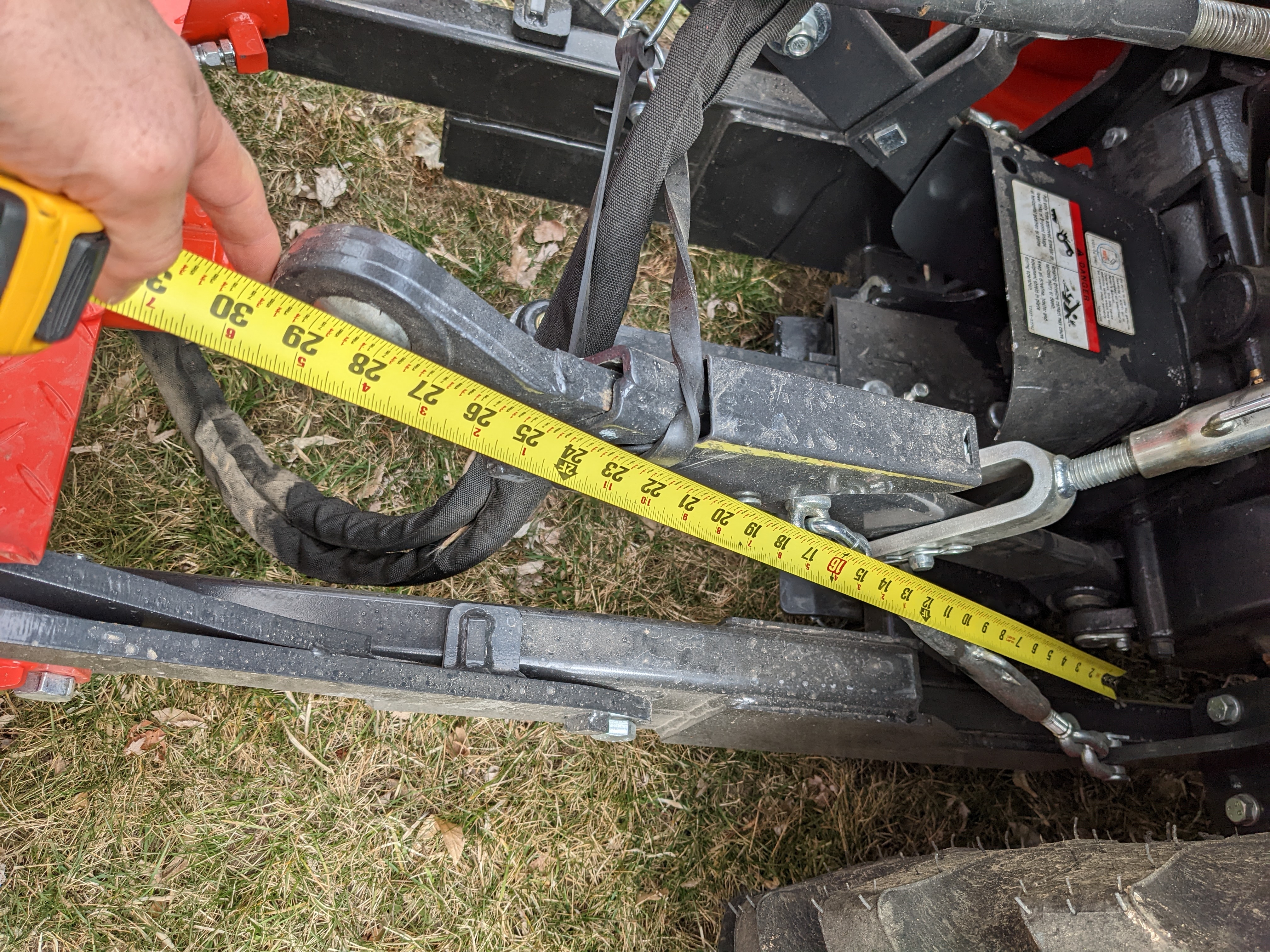

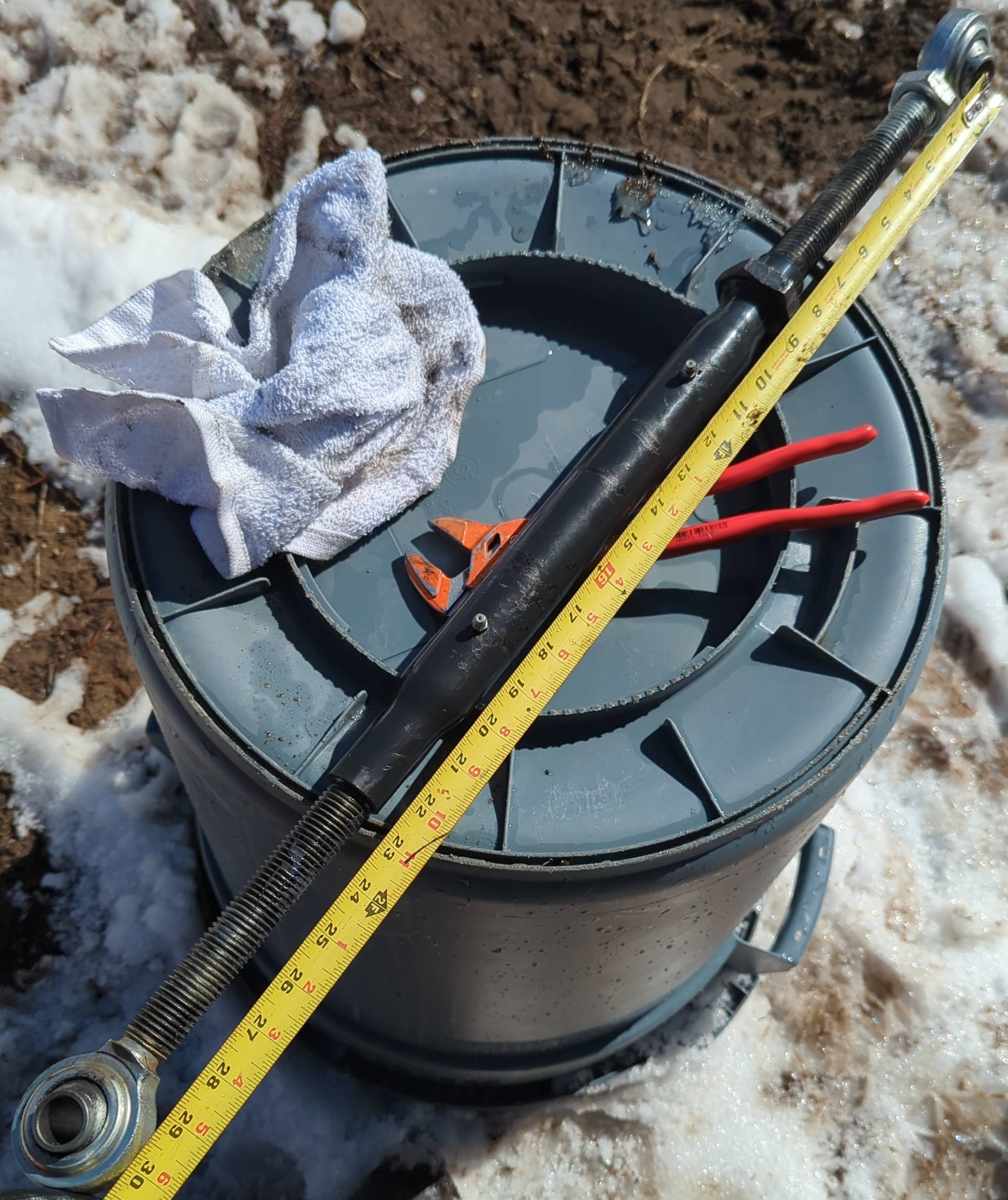

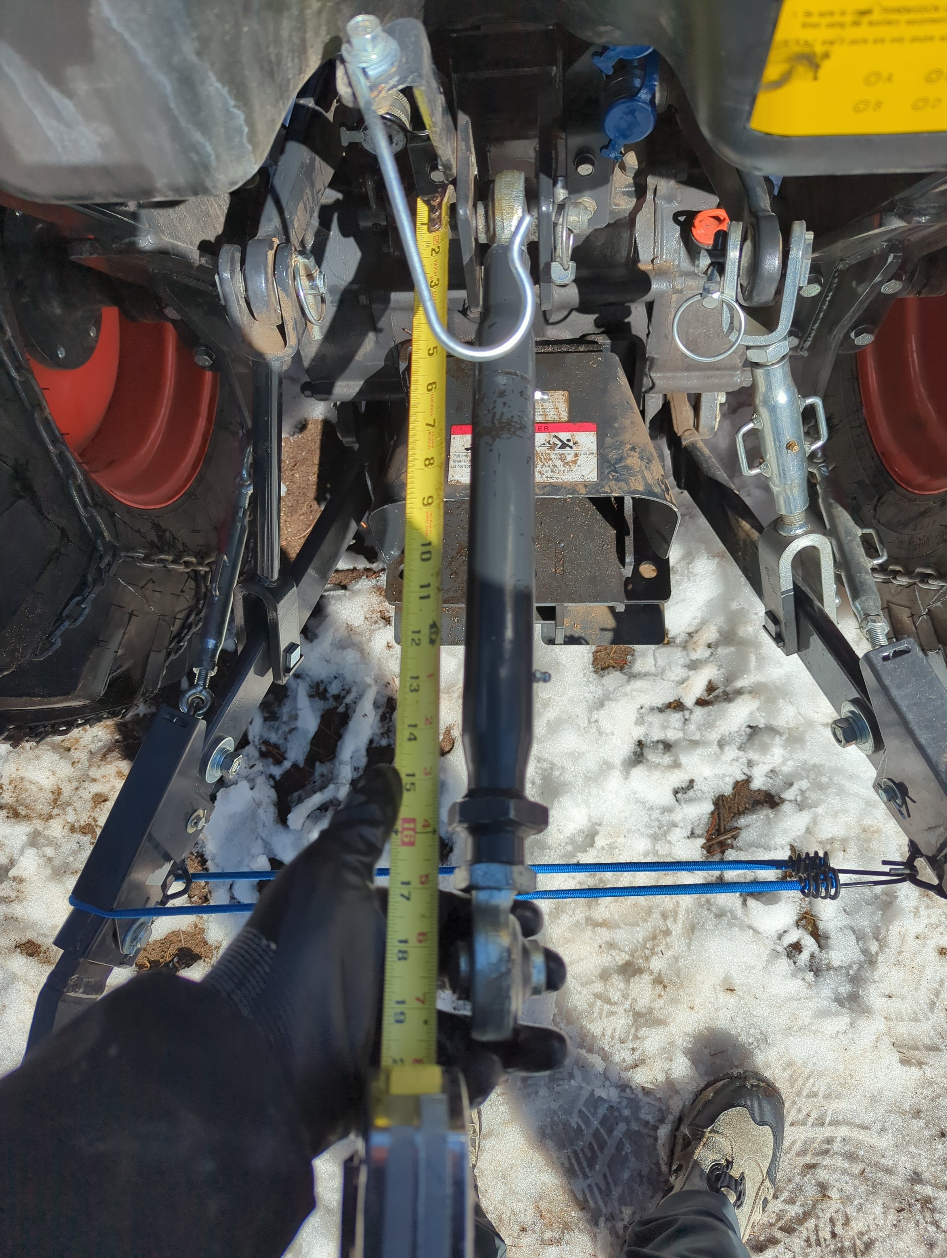

how did you choose the length range of your cylinder?
It seems the cylinder travel will necessarily be less than my top-link's adjustability:
  • the top euro hook reduces the available travel by an inch or three (it's just physically longer than the normal ball)
  • a hydraulic cylinder is not simply going to have a shorter adjustment range, given the range taken up around the seals on each end outside the ports.
Further, unsurprisingly the available cylinder ranges are not "perfectly centered" around my particular average length (seems to be around 25", out of a total top link range of 18-30") - so I'll have choose the 7-10" travel I get from the cylinder either in the shorter or longer part of my current 18-30".
Complicating things, today my lower links (telescoping) are ~28" pin to pin, but I am probably going to swap in fixed stock links, which are shorter, I believe - so while today I generally keep the top link around 25", it seems I can/should bring that in some.
Solutions that provide the cake as eat it, too will get the most upvotes :) Thanks!
View attachment 3221618View attachment 3221617
(hope I'm not hijacking the thread, happy to make a new one to ask if that's better)

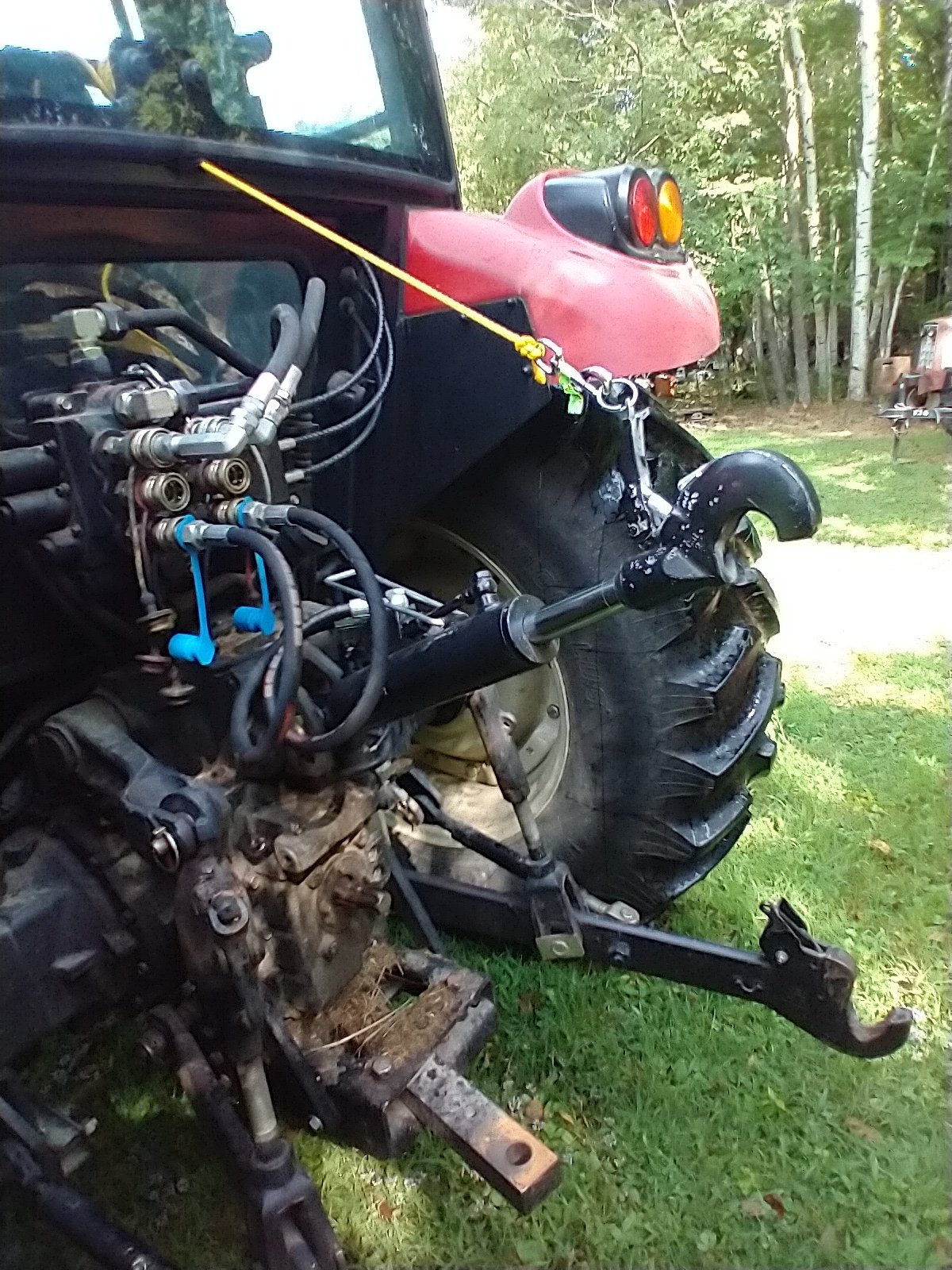

Most implements are designed to be operated when perfectly level. Obviously make sure you’re roughly centered around the length that gets you level, but I tend to bias towards a slightly shorter range vs longer if you have to choose. Making sure I have the right range on the short side means I can lift things higher for clearance. I can’t think of too many implements where you’d need to have the end furtherest from the tractor drastically lower than level, but I’m sure someone could think of something. Take a look at your implements and measure what it takes to be level. Then ask yourself if you want to bias shorter, longer or even for each one. I’d wait till you get your hooks welded up because it could make a difference, although I suspect a minorish one.
All things considered the top link was always the easiest part of the equation for me. I’d prioritize getting the lower link hooks first. I like the rapid ball hook on my hydraulic top link, but the return on that was nothing like first putting on hooks.

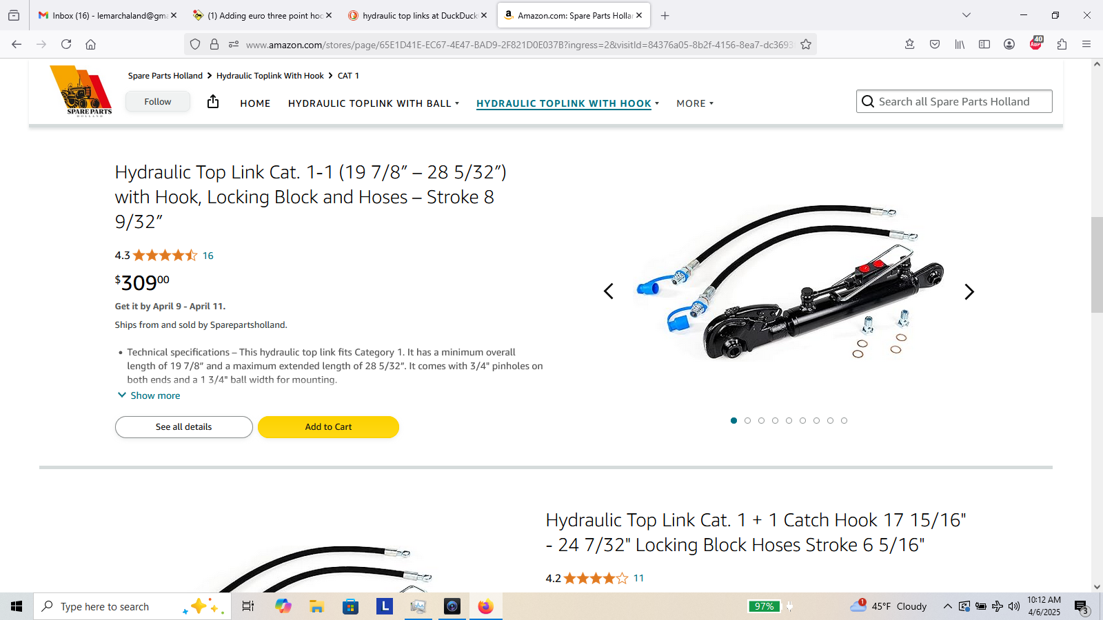

Cat 1 is what it says in the print with both ends having 3/4" holes. I doubt that the hook end has a 1 3/4" wide implement ball though.
The page linked is for cat 1's.
/ Adding euro three point hooks #84
Its my understanding (per brian) that there is no dedicated cat1 top link hook - a cat1 arm would its ball/clevis end sized for (actual) cat1, but the hook is the same cat1 & cat2. The balls, then, share an OD but are sold with either cat1 or cat2 ID's.
Note that the ball overall width needs to be machined down IFF your implement adheres strictly to the cat1 width of the pin, although for instance none of my implements do, they all fit a cat2 *width* ball just fine on their cat1 diam top pin)
/ Adding euro three point hooks #85
Yes the linked page is for top links with the smaller Cat 1 tractor ends. The top link hook has the same OD for the ball with a different bore for cat 1 or cat 2.
