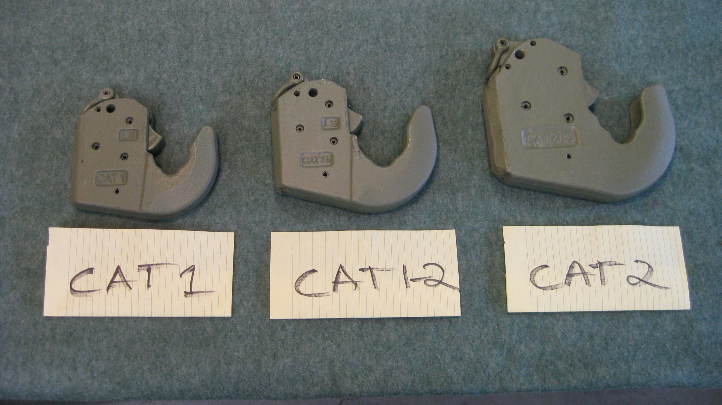

So you need some of these. For your tractor you could go with either the straight cat 1 hooks or the cat 1-2 hooks.
Then it is also nice to have a top link to go along with the lower hooks.
Like ptsg mentioned, you can do the fabrication, or ship the extendable ends to me for fabrication.
Thanks for posting the pictures !
Every 3 point piece of equipment I own is category 1 but since my LS is built for both 1and 2 I would probably order the 1-2 option. What would it cost ready to install delivered to zip 54470 ?

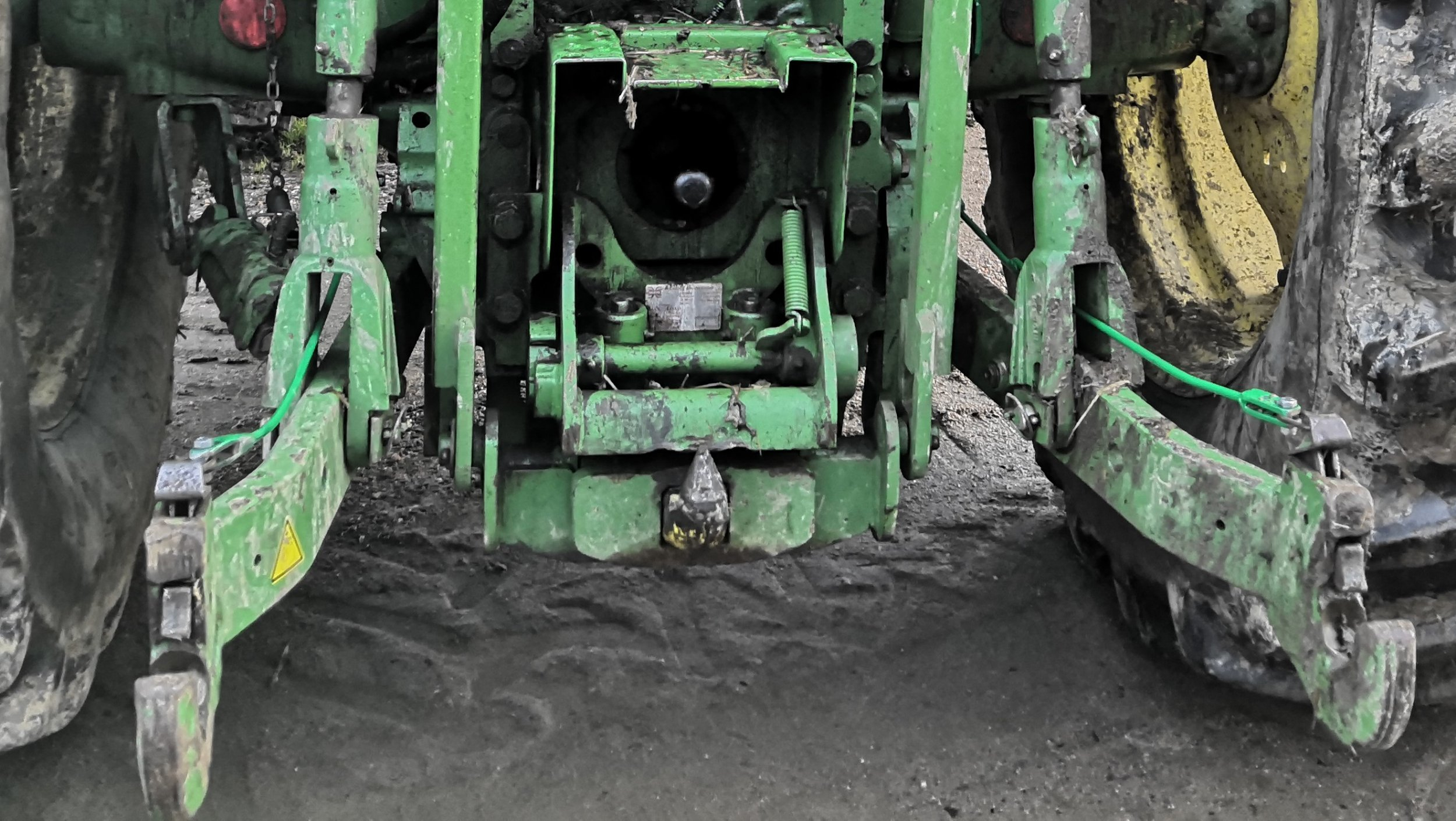

Euro hooks (we call them hook ends) have been pretty much standard equipment on tractors over about 50hp for 30 years here in Europe. You'll really only find pull out ends on smaller tractors. Last year, I bought a new 50 hp Kubota L1501 DW tractor, yes I know, in N. America you'll all probably think that it is a 15 hp machine, but for whatever reason, Kubota choose to use a different numbering system for some of their range in Europe. Look it up on Tractordata to see the specification.
Anyway, my tractor came with pull out ends as standard and I told the salesman that I had to have hook ends. Since they have been used for so long, you can easily buy replacement ones to weld on. My hook ends are welded onto the pull outs, so I have the best of both worlds.
My tractor was in production from 2018 to 2021 and has been replaced by the L1502, which has more gizmos and probably, to it's detriment, a particulate filter.

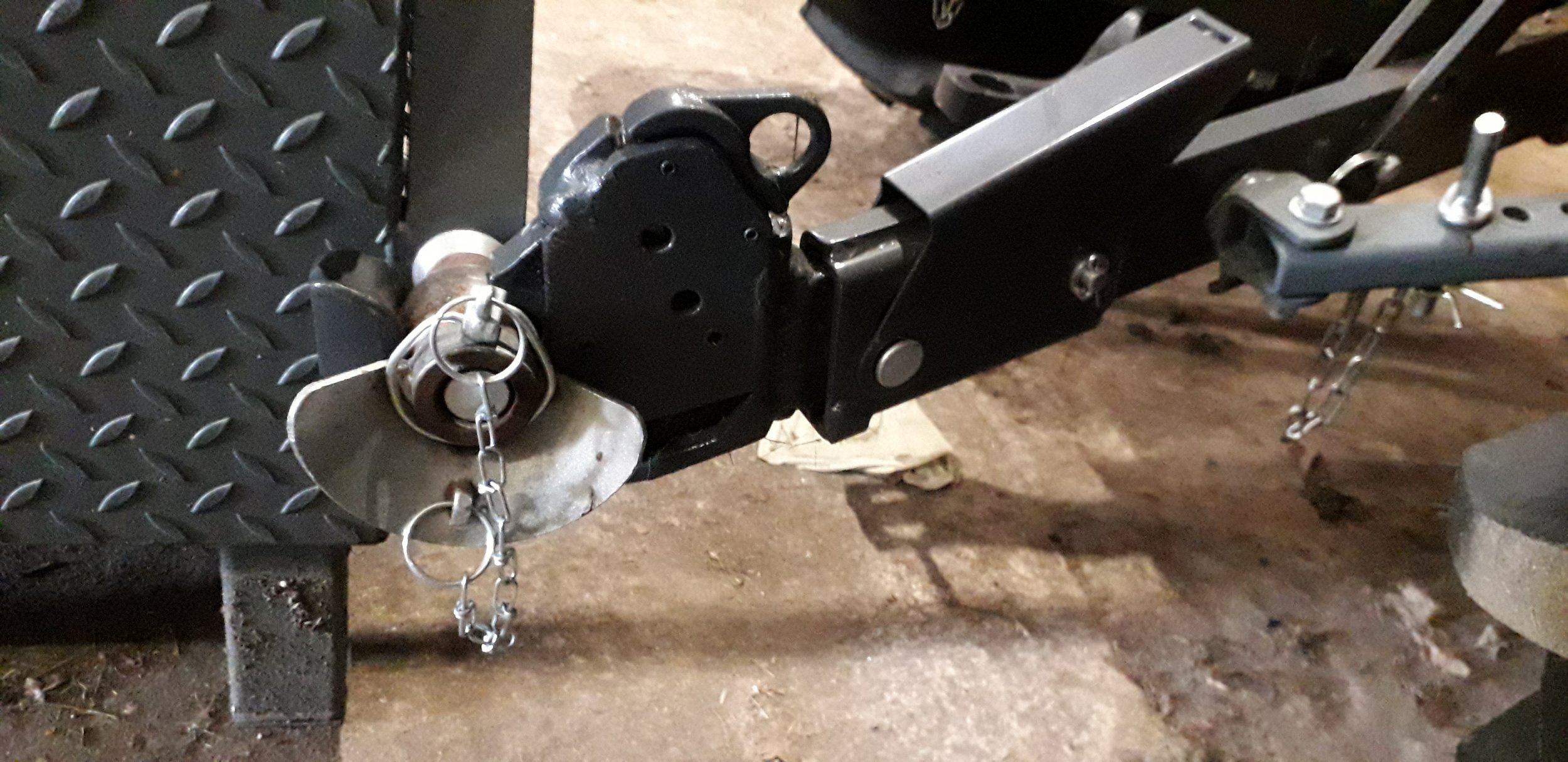

Here you are. You can use ordinary balls, but the ones that I have "ears"on them to make hooking on even easier.

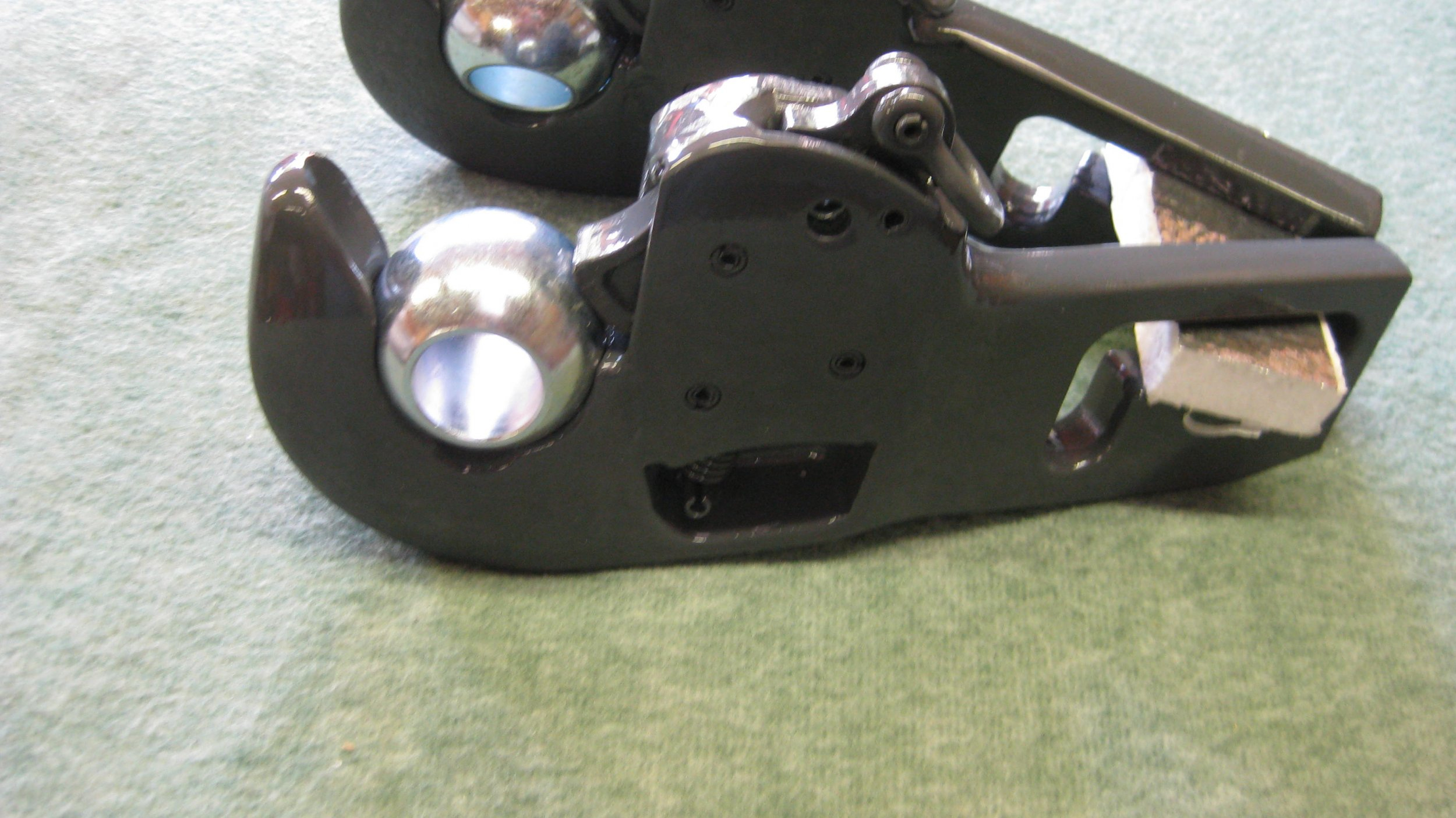

I'm intrigued by these. Do I understand what I'm looking at correctly in that it's an open hook with a top latch and a ball type bushing for the implement?
/ Adding euro three point hooks #33
Yes, pretty much. Nice, simple, reliable and most importantly, retains the ball joint so it doesn't put things on a bind like the Pats for example.

The Euro hook ball & socket addresses the one complaint I hear or read about with the Pats which was the ridged flat load surface.
Not sure that will be a problem but this does look improved.

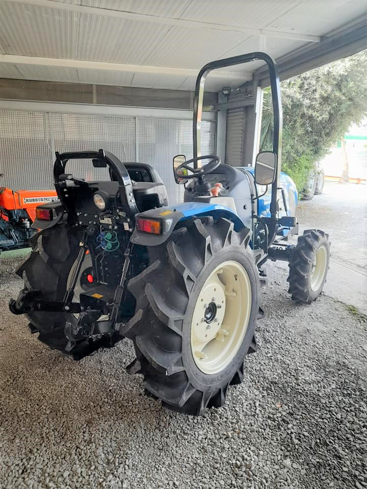

After communicating with Brian at fit rite hydraulics I shipped him my standard slide out LS links and had him weld on the euro links, including shipping the whole process took a little less than 2 weeks. Mine are designed for use on category 1&2 hitch equipment. It was expensive but they make hooking up and unhooking a LOT EASIER ! Working with Brian was easy and the quality of his work is excellent.
Eventually LS will probably start offering these for sale in the USA for less money but who knows how long that might take, I wanted them now not a couple of years or more from now .
