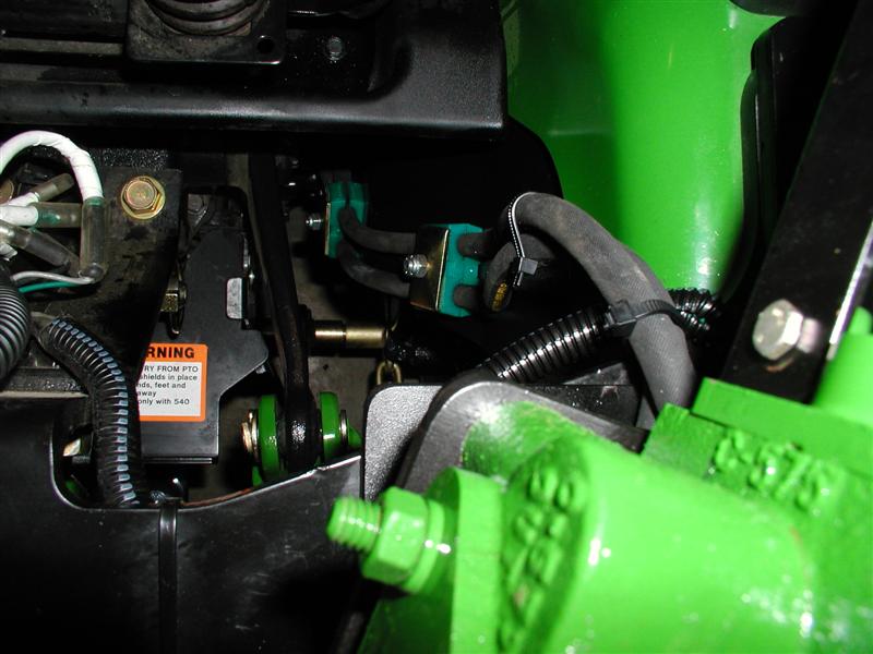

Then the block goes back into the tractor, between the transmission and DSCV, as it was originally. The cap screws get tightened, and the banjo bolt goes back in and torqued. That step being complete makes me feel less stress. Here is a side view and a rear view of the hoses routing out of there.

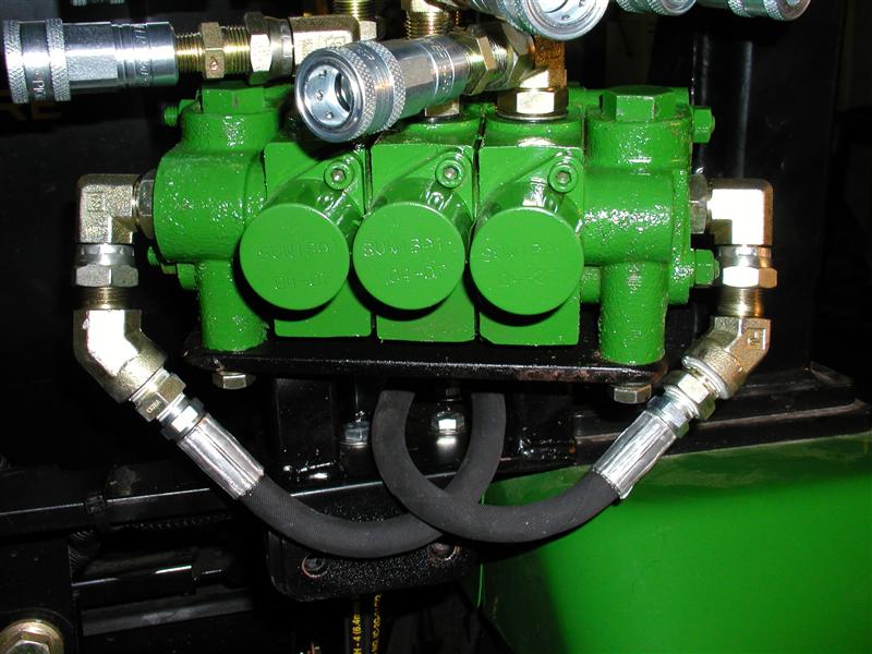

And here is the view of the valve, from the rear end, hoses routed in and out on each side. That's as far as I could get last nite. Also, I started putting the fittings and couplers on top of the valve, its going to be a mess. Gotta get creative on this next part.

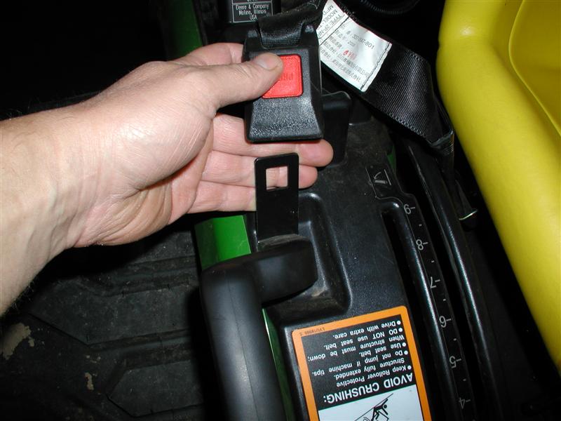

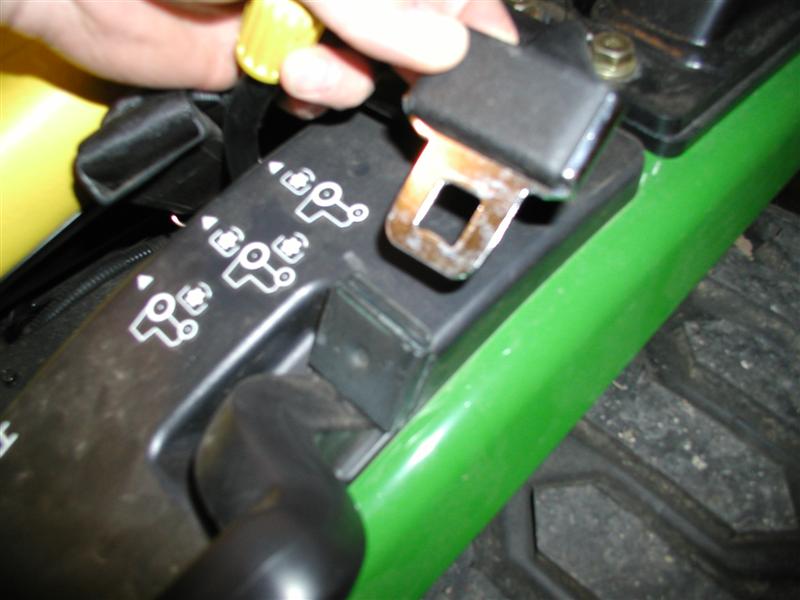

I relocated the seat belt storage clips. Originally they were both behind the seat, on the ROPS crossbar. My hyd valve sets right there on the one side, so I relocated that side. Then I liked the new position so well I relocated the other one too. To do this I took the handle off, and added the bracket and retorqued the nuts from below. The left hand side didnt work out as well, so there I had to slot the seat belt storage bracket slightly to allow it to mount flat under the handle properly. Pics...

That is beautiful work. Your planning shows up well.
Regarding the quick disconnects on the top of valve. Consider an elbow with an O-ring boss on the long leg and a female pipe thread on the short leg for the middle port. The elbow sticks up above the fittings on each side far enough to let you turn it parallel to a side fitting. Part no 6805LL as Discount Hydraulic Hose. Sometimes you can find a regular length, "long", and "extra long" so that the tops of the fittings will be at three different levels.

After a minor incident with one pinched O-ring causing hydraulic fluid leaking all over my floor, I am back on track. Suffice it to say, "If you think that an O-ring is going to stay in place during assembly without applying grease to hold it there, guess again". The large O-ring behind the "block" got pinched, so watch out for that.

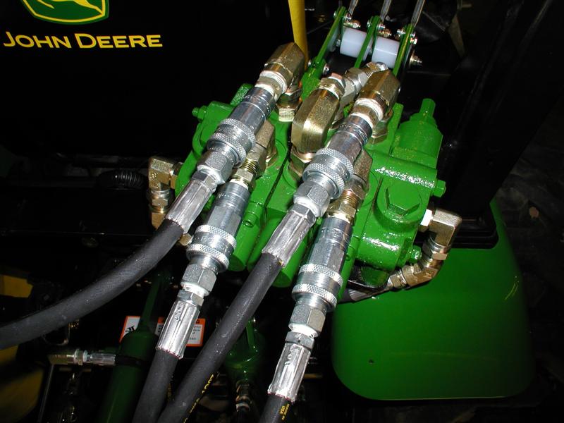

The current solution for the congestion of couplers on top of the valve is to route the center spool (two couplers) to a remote panel area and mount the couplers there. This will work out just fine because that center spool was to be split to both the couplers in the back and two couplers mounted near the loader couplers on the side of the tractor. So here is what the top of the valve looks like. Notice that the center spool connections are just plugged for now.

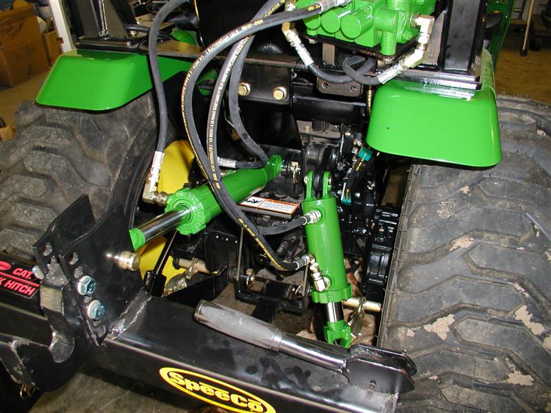

and here is the rear view, with the top cylinder and sidelink cylinder all plumbed up, although I am still experimenting with hose length and fitting orientation to get the hoses to flow nicely when the three point moves.
