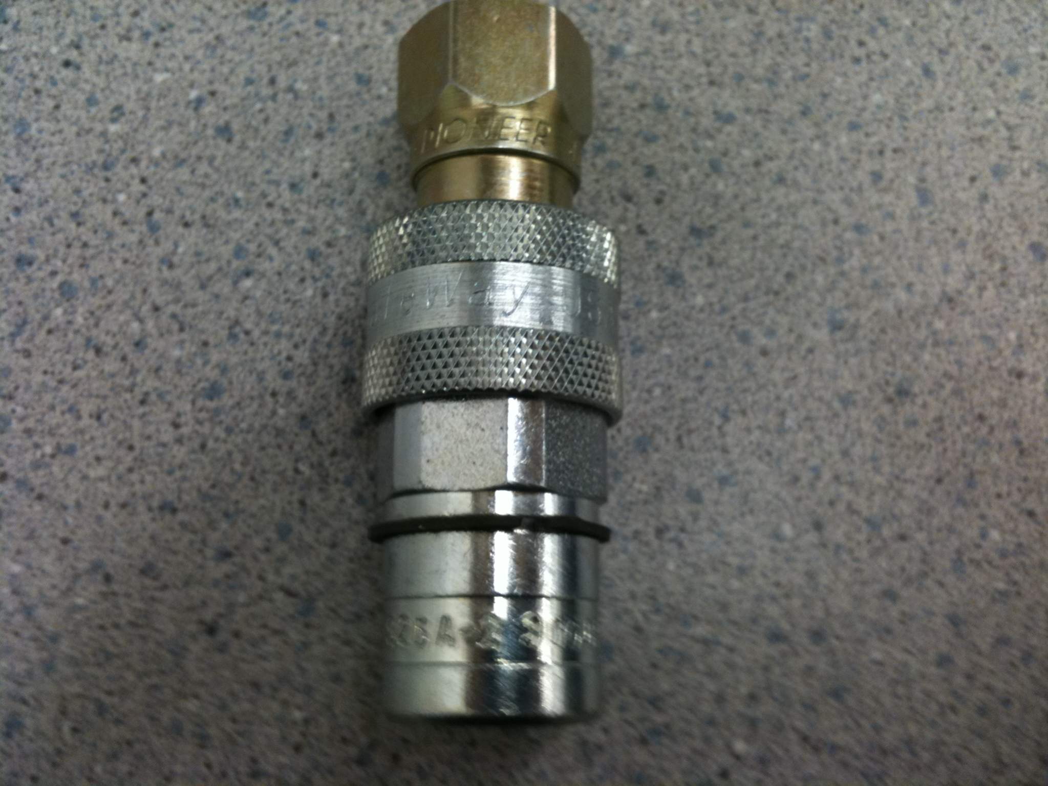

Thanks for posting the project in so much detail. For my interests, this is one of the most informative posts I've read. I do have a question about a component. Where did you get the couplers with the snap ring groove? I've been working on a project for hoses for a FEL third function kit. These couplers would minimize the number of fittings needed. I glanced through the Surplus Center on-line catalog. If they're there, I missed them. Again, thanks for the post.
   / Adding Power Beyond, 3-spool hydraulic valve, and T-n-T to a JD 2520
#82
I found them at a local hydraulics shop, called Ronco (Rochester MN and Lacrosse WI). They must be in the Parker catalog, maybe you can find the part number and order it that way.
   / Adding Power Beyond, 3-spool hydraulic valve, and T-n-T to a JD 2520 #83
Just got off the phone with our local Parker guy. He called Parker. They told him they do not make a hydraulic quick coupler with a snap ring groove on the outer body. The best they could do was offer one with an extended body and threads that would use a bulkhead nut. Thanks for the help. I'll keep looking.
BTW, still a very informative thread. I'm trying to get the stuff together to add couplers to run a stump grinder on a CCY EX3200.
   / Adding Power Beyond, 3-spool hydraulic valve, and T-n-T to a JD 2520 #84
Sockwell,
Don't know if you're looking for 1/2" but the snap ring retained couplers are available from John Deere but they aren't cheap..
This is the one that is used on the rear remotes on my 4310. They are O-ring Boss (ORB) so you would need hoses with that connection or an adapter.
1/2" Female ORB snap ring hydraulic quick connect from John Deere -
LVA13231 $27.57 Snap ring - M42702 $2.79
There are smaller ones available but I don't have the part numbers. What kind of flow do you have?
#85
If you can get the threaded one for a bulkhead nut, go that route. The snapring is a tough way to do it anyway. The snapring is so small, the hole has to be so very accurate, no room for error, and if you pull too hard you can dislodge the snapring. The nut sounds like a better plan. I will try to follow up and look at the make and model on the snapring couplers I have, and add that info here later.
   / Adding Power Beyond, 3-spool hydraulic valve, and T-n-T to a JD 2520 #86
Please don't go to any trouble. There are other ways I can do what is needed. You've aready helped myself and others with the details of this post. I will probably go ahead and get the Parkers that can be used as bulkheads or use an assembly of fittings that include bulkheads.
The WR Long Third Function kit for my FEL was delivered with hoses. The hoses are too long, are zip tied to the front FEL cross tube, with the fittings hanging. They drag the ground when the FEL is lowered and, when using a grapple, debris will get caught in the hoses. I'm looking to either replace the hoses with hard pipe or with shorter hoses, with the QC's in a plate. The type QC's you used would have eliminated the need for a seperate bulkhead fitting.
