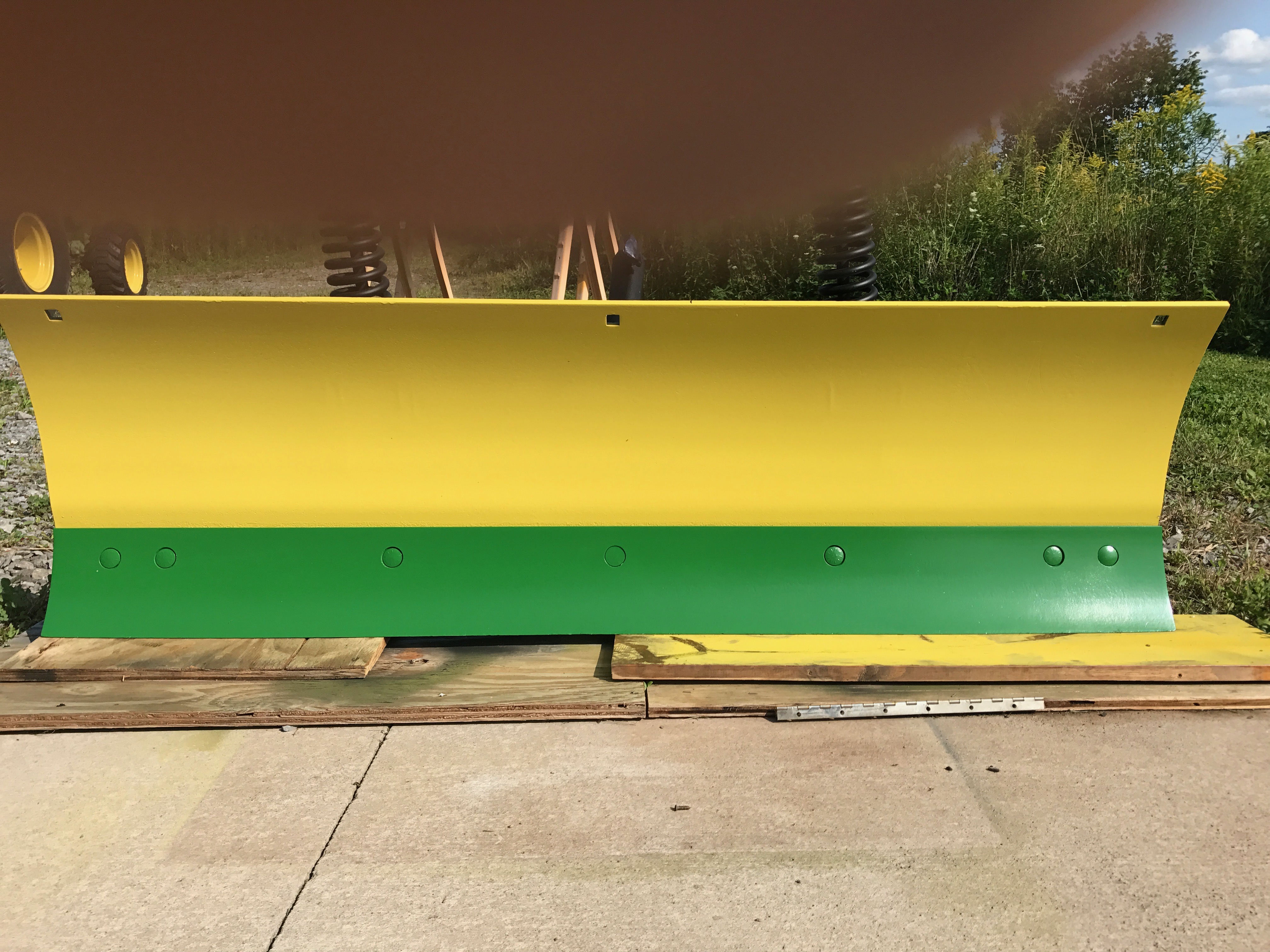

It's the model #375 FRONT utility blade made by JD specifically for this tractor. As i I don't have a loader on it I wanted to add a more modern Joystick Valve. JD4310man sent me a link for a nice valve. I have the service manual that shows how to plumb it with PB. I have a rear snowblower but with a gear tractor it is inefficient for lighter snows. I would never want to plow in reverse with a gear tractor.

I received my Cross joystick loader valve from Surplus center. It is nothing like the stock JD SCV so I have to make a bracket to fit. If anyone has added an aftermarket valve to a 650 or 750 I would be interested in how you mounted it. I also have to plumb it. The controls ports are all SAE 8. I have the service manual that shows where all the hoses connect to the tractor, and it says a plug must be installed in the auxiliary outlet port of the rockshaft piston cover. Does anyone have the part # of this plug? Also, if anyone has a 650 or 750 tractor without power steering I would be interested in how the hydraulic lines are run and what type of fittings and size of hoses are used. I did get the plow and cutting edge sanded and painted while waiting for the control valve. Next pic I'll keep my big, fat finger out of the way!
