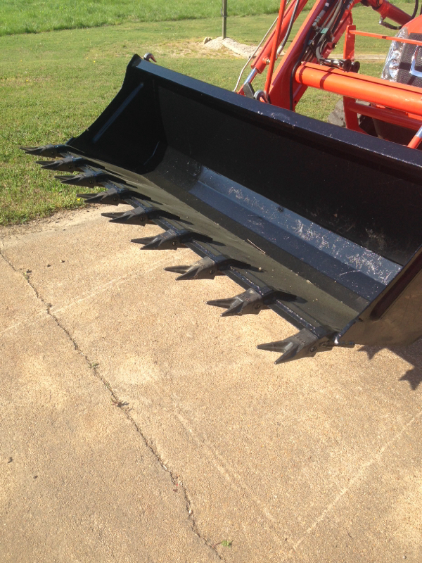

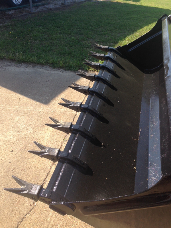

Decided it was time for a tooth bucket, instead of doing a bolt on tooth bar, I found another bucket and added teeth to it. The bucket had some wear on the original welded on cutting edge, so I added a heavier weld on edge and weld on teeth mounts, went with 9 teeth on a 6 foot bucket.
Yikes. Those are what we call frost teeth. That thing should really chew up a pile. I've thought of a tooth bar but my tractor has my brush forks on it 90% of the time. My bucket mostly gets used for snow removal.

Yeah, I will see how well they do and report back on it. I know on the construction sites,most use these teeth on the outer edge and the single tiger tooth in between, I can always change them out if they don't work well.

Well it's all finished and painted ready to go to work, will get some pics soon.
   / Adding teeth to a bucket
#29
Finally remembered to post the finished pics, still have not used it yet but will soon.

I haven't seen teeth like that before. Is the design targeted for a certain purpose?
#31
They are called twin tiger teeth, mainly used for hard frozen ground and very hard compacted soils.
