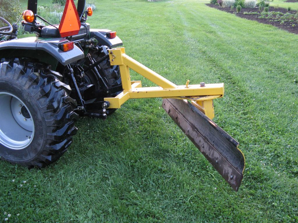

This is what I did with mine for shoes.
http://www.tractorbynet.com/forums/welding/190070-rear-blade-skid-shoes.html
I haven't tried it yet, but it should work fine until there's a solid base of snow/ice and I can remove the shoes if I need to.
I added hydraulics to the angle function of the blade, which worked fine moving mud earlier in the year. Snow should be no worse.
http://www.tractorbynet.com/forums/hydraulics/188519-adding-rear-remote-kubota-l3400.html
I've since beefed up the rear pivot bracket as well.

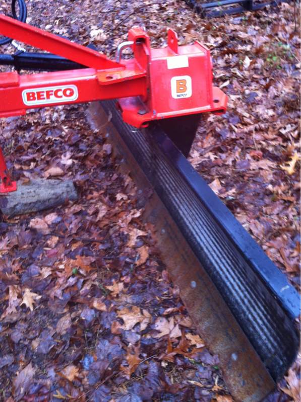

Sorry - understand the picture thing- has been raining like crazy. The new to(y)ol...
Not sure I will have time to hook it up today-wonder if it will work with the Imatch. Then I can get some action shots!

Nice blade.:thumbsup: Are you sure that thing is used? It looks like new. :cool2: A couple of things, would you tell us what you had to pay for it, might help some of us that are looking for a nice used blade. Second thing is that I think that you will find that it does not use the hydraulic to angle the blade, but to offset the boom in one direction. Now offsetting the boom does indeed angle the blade, but it will be off to one side of the tractor.
Again, nice setup and I'm sure that you will be happy with it. ;)

MtnView - you are correct - I thought it angled the blade but actually offsets the blade (I am always confused!). Regardless, i think this will work well. I paid $750. I thought this reasonable due to condition and quotes I have gotten for new blades.

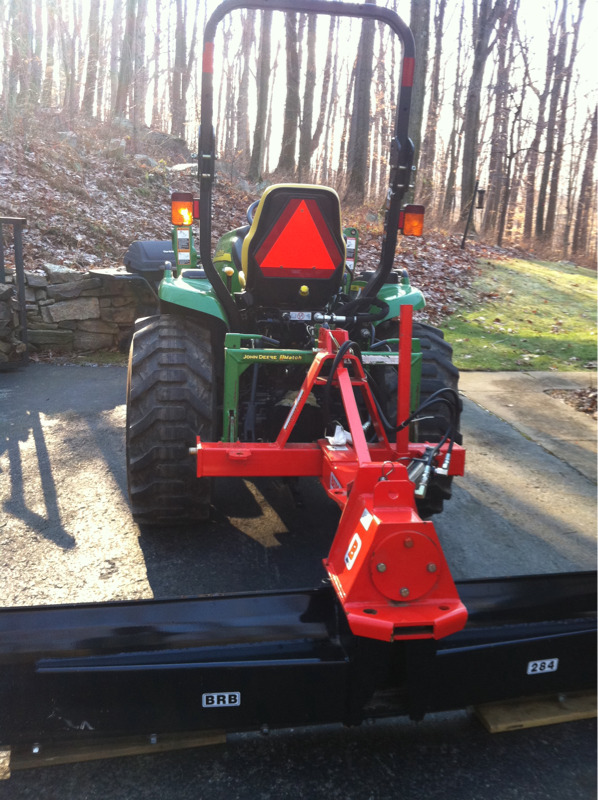

Well let it snow! Hear the northeast may be in for a bit this weekend. I was pleased that the blade works well with the Imatch. Had a set of hoses made that run from my diverter so I can use the offset on the blade while also having the toplink functional. Just ran them along the floorboard for now. Usually not excited about snow but can't wait to try this out. One sort of odd thing I noticed-there seems to be a little hole in each of the fittings that the hydraulic couplers attach two on the blade side- is there a reason for this? One of them seems to "bleed" a little hydraulic fluid. Only thing I can think of is they are there to relieve pressure for some reason?

Dana, your rig sure looks nice.:thumbsup: Question for you, which side do you normally look to, to watch an implement? If it's your left side then your all set, but if it is to the right, you may want to change sides of your offset cylinder and maybe put the extending end out at the boom, that way your hoses aren't always moving so much. My thinking is that you will need to angle the blade all the way (45*) and then use the offset for about 12"( your blade will then be at about 25-30 degree angle) and you will be plowing snow out and away from the tractor. A little experimenting and I'm sure you will find where it works the best for you. Can hardly wait for the action shots. :cool:
You know that now you need that tilt cylinder for your 3pt hitch to fine tune your rear blade. The tilt of the blade changes as you angle your blade.;)
Good luck and I hope that it snows a lot for you.
