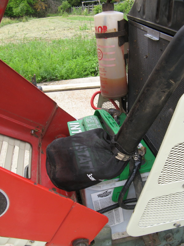

I got my prefilter from Outerwears. I think it's a 10-1010-01. I don't recall the cost, but it was approximately $15 including shipping. It measures about 5.5" long x 3.5" diamter and has some elastic around the opening hole. I took a piece of metal garden fencing I had around, cut it to a reasonable size and bent it by hand into a cage to hold the filter out during operation. Some of the metal extends inside the end of the air intake. I used a hose clamp to hold it on. Here's a picture. I opened up my air filter after bush hogging, and there weren't any pieces of stuff. The Outerwears prefilter has a hole size of 5 mils (~100 microns) so only the fine stuff should get through.

The Outerwear pre-filter looks good. They are awesome, and work really well. They intercept a significant amount of particles, from sand and larger dust particles on up. If you keep them free of oil or grease almost everything just sloughs off, too, so you don't even need to clean them off really. Nice work.

How did you tighten the hose clamp tight around that rubber hose?

I'm not sure I understand your question. The simple answer is that I tightened the hose clamp until it was tight. :D When I first put it on, I didn't have a hose clamp of the right size, so I used a couple of rubber bands. I thought it would fall off, but that was enough to keep it in place. The hose clamp is MUCH better than the rubber bands. :thumbsup:
