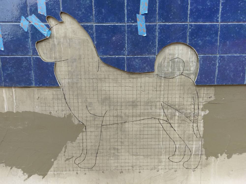

I started doing the tile on the back wall of the pool today. It's slow going, but. I think it will be worth the effort. IMAG1415.jpeg
   / Akita Pool #243
How are you cutting the tile for the Akita... nibbing?
   / Akita Pool
#244
Holding the tile up to the edges of the blade on my tile saw and kind of grinding it away until it fits perfectly to the drawing.

Thanks. Because this will be under water, I'm having to use pool tile, which is more dense then regular tile. There isn't a lot of options out there for color in pool tile, so I'm going to buy the 12 inch sheets of cut stones in the colors I want. Basically, black, white and grey, to get the colors of my dogs. Then cut each one into the shape that I want it.

The outline of the Akita is done. I still have to tile all the other walls, but there isn't a big rush for that. I'm really wanting to get started on the rock for the Akita!!!!
