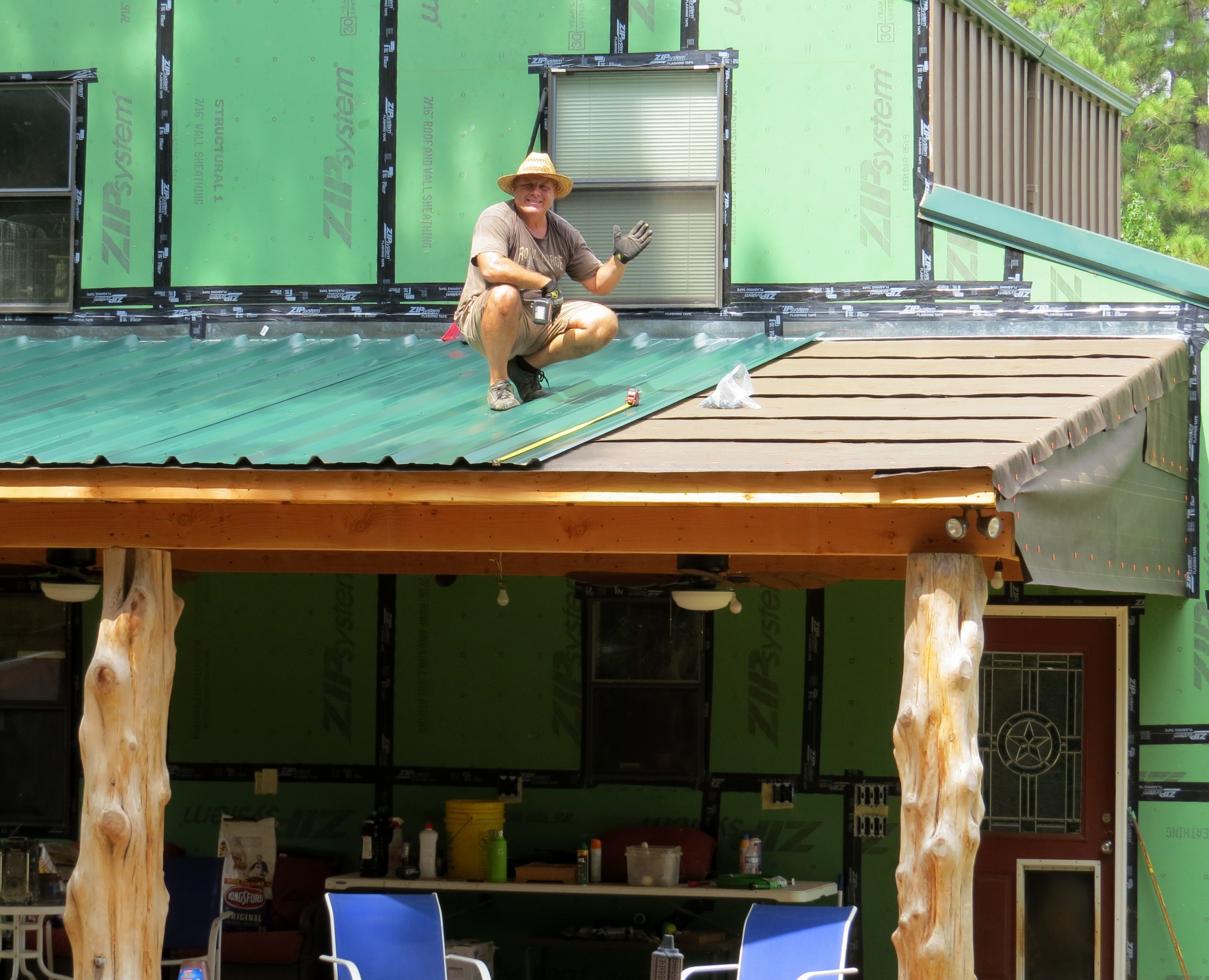

I put the metal roof on the porch this weekend. Heat and high humidity made this a painful project, but overall, it wasn't too hard.
