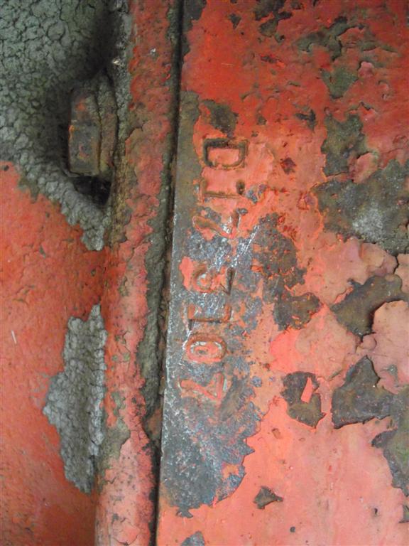

1957 it is then .Got it running yesterday . points were gummed up , new oil in the air filter , cleaned carb , fix a few brittle wires and fired right up . now to get a tire tube and drive it home for some TLC . Once it started it ran like champ . Thanks for all the input . this is a great site :thumbsup:

   / allis chamlers #27
I believe what you have is a 1957 D17.:thumbsup:
I was doing some googling and getting a little conflicting info, but some places list the the D17 starting in 1958 @ SN 4300.
But others list them as starting in 1957 @ SN 1001. So I believe this is what you have got.
But whatever year it is, I believe it is definatally pre 1960's, because of the metal allis-chalmers logo. The later D17's had it painted on the hood. NOT a metal plate.
the latest ones had decals, my father's '65 series IV D17 has decals
being that it has the metal logos(and the year we are quessing it at) it is a series 1. IIRC, it has a round plate(or belt pulley) bolted to the right hand side of the torque tube and a fast hitch. Another reason for the hand clutch is to keep the hydraulics going, the hyd pump is transmission driven, so if you disengage the foot clutch you would also lose hydraulics. the Series 1 thru 3 were set up that way, the series 4 was the first to have live hydraulics and a factory 3 point hitch.
