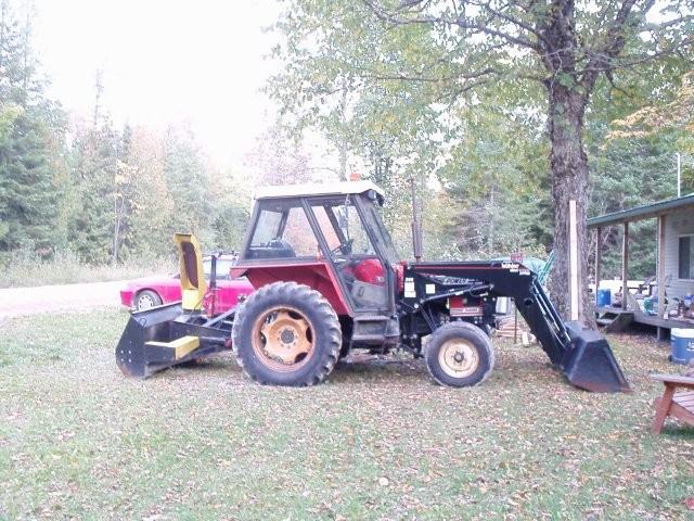

I figured a strap or something. Is it shown in your pic? Even with glasses, I can't see the strap? :confused:
No, the straps aren't shown, and the barrels are currently upside down.
The suggestion you received from Everything Attachments was well meant. I use the carry all to bring water out to my mobile hen houses, hence the barrels. It also serves as a counterweight for light duty loader work. In the winter, the counterweight is my snowblower.
