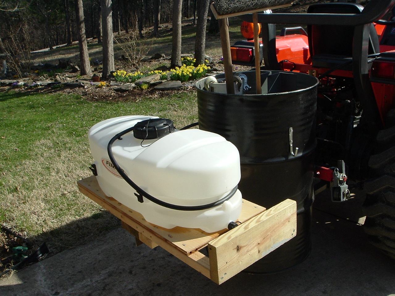

You know everyone has their opinion of Ballast Boxes. But I find my Ballast Barrel very useful, it carries my handle tools, my chains, spare water, extra clothing sometimes, or anything I want to throw in it. It is heavy, and very compact up close to the tractor which is important to me in the woods, to keep from backing into or sideswiping a tree. I also use it with its built in 2 inch receiver to carry my sprayer, and am considering putting a salt spreader on it for next winter. I sure get a lot of use out of mine:)
That setup looks like it might actually be bigger (extending rearward) overall than the 4' box blade idea, no?
That does seem like a fine place to store all that "stuff", chains, etc., but what do you do with all of that when you have say a box blade or rotary cutter on the back? Or does your ballast barrel stay on full-time?
Heck, this discussion is making me think I need to invent a box blade with storage on top :thumbsup: ('course my question would still apply)

Well the sprayer is only on occasionly, and comes right off the 2 inch receiver, the ballast barrel is considerably shorter and much narrower by itself than a box blade. the barrel of course comes off for the rotary cutter, and I rely on the loaded tires for stability on the hills. the ballast barrel is on the tractor most of the time (loader/fork work is what I do the most). However your Idea of a storage/weight box on top of a BB may not be a bad idea. When I lived in open country, I never had a Ballast box of any kind, I didn't need it. I left the mower on all the time for ballast for loader work, and had loaded tires. It worked fine, I did not worry about hitting things much, because there wasn't much to hit in the fields. I carried the tools in the bucket and dumped them on the ground more than once, and darn near ran over my chainsaw once:laughing: But hey different strokes for different folks, and whatever floats your boat. I really like my ballast box setup, it works well for me:thumbsup:
