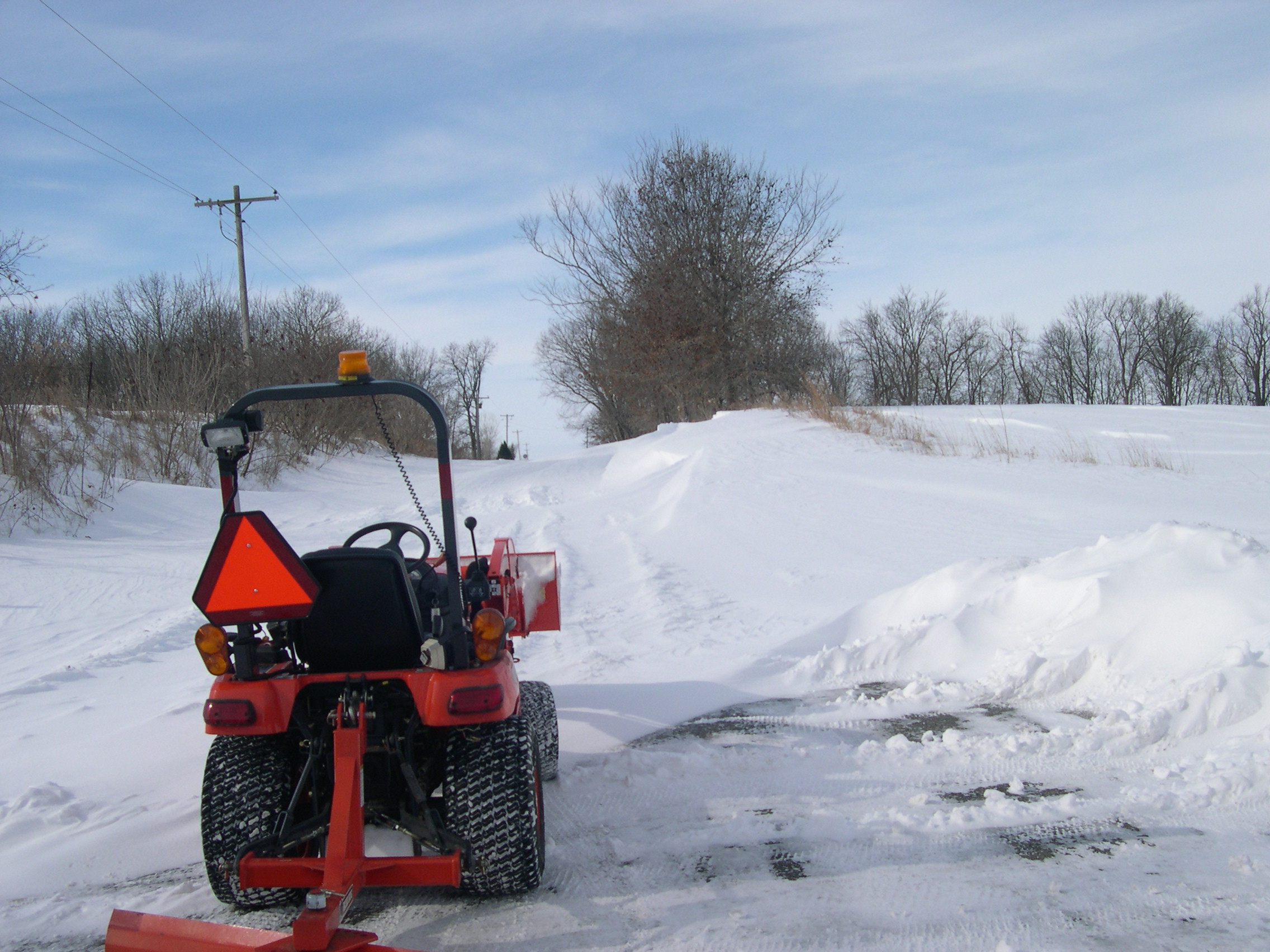

Here are some pictures of the snow I cleared this last winter. We got something like 24 inches. I cleared about 1000' of the road in front of my house to get to the main road. The picture in front of my tractor shows a drift that is about 3 feet deep. I'll spell your needs out for you in a simple manner AIR, WATER, BX2360, SHELTER, FOOD, TV, BEER. Your wife probably won't understand that, but you will.

+1 what DodgeMan said, even though what passes for winter down here pales in comparison to what he's dealing with.
My BX setup for the modest snow we get is almost the same as Dave's. Liquid-filled rear tires and my 230 lbs, plus a scraper blade on the back hold the back end down. I've got bar (agricultural) tires, not turfs.
When we do get snow, it's heavy and wet, often with ice underneath just to make everything slick. So far have not needed chains, even on some very steep driveways. Don't think we'll ever see a snow that will stop it around here. If you've got more snow than Dave, maybe you'll need a snowblower for it.
Highly recommend the rear scraper blade since it can be angled to windrow snow to the side. Not expensive either (Tractor Supply sells a 5 ft. blade for $300, and if you shop around, you can probably do better than that). Lacking that, you make a lot of back and forth runs or make lots of cross-hatch runs to the side with the loader, which takes lots of time.
Glad to hear of your plans. You'll find it's a wise decision. Be safe and enjoy!
