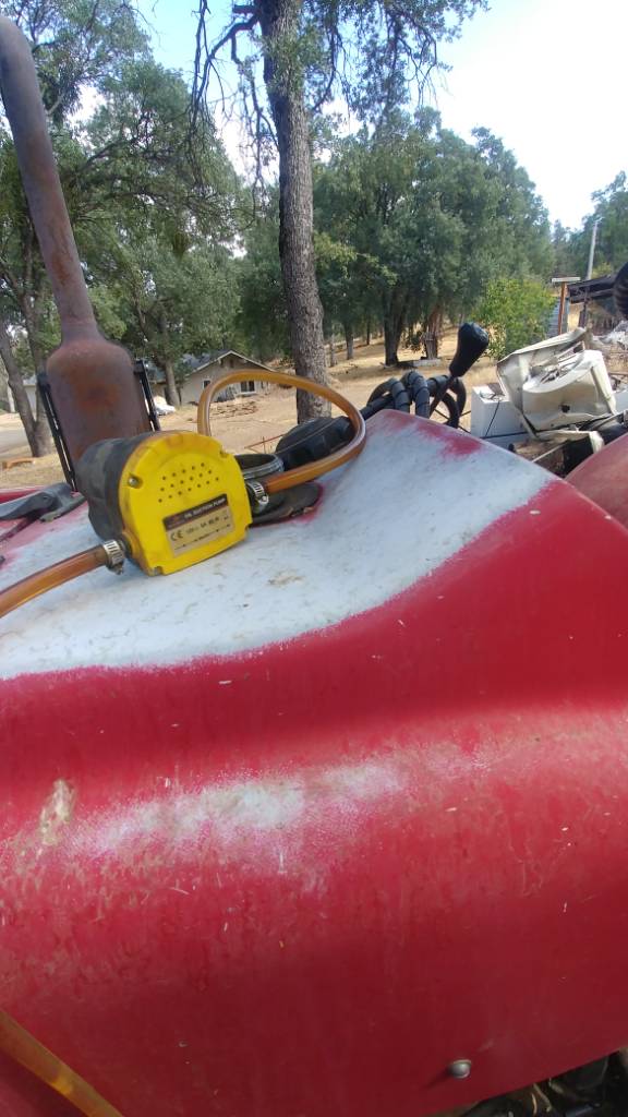

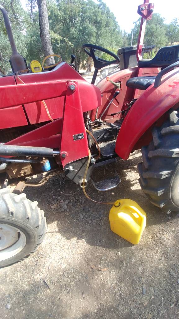

I made one with an inexpensive universal 12 volt fuel pump, battery, hoses. To make it easier you could find a convenient place to mount one on a tractor, each hose the right length coiled up out of the way, plugged when not used keep dirt out.

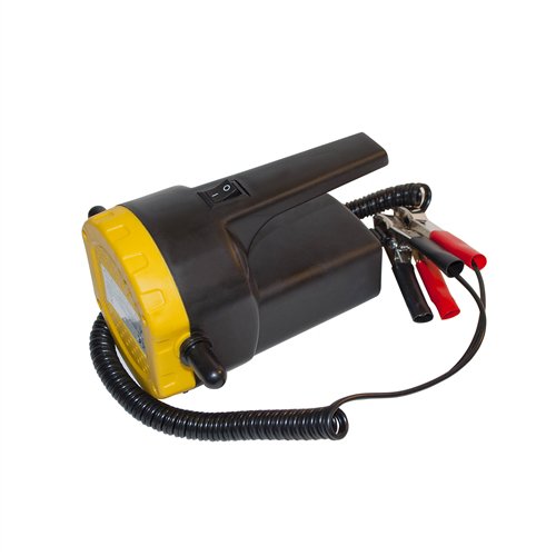

Shared it before but this might work for some of you, you can get one on Amazon for just under $20 it is for diesel or oil empties a 5 gallon can in just under a minute with can on ground and my fuel inlet is between 5 and 6 ft from ground. I just connect it to a ground and the hot on starter because that is the handiest on my tractor.pump.jpeg
   / An easier way to refuel your tractor #194
Just an update remembered to time how long it takes with my pump 4 1/2 minutes for 5 gal not real fast but not bad.0905191455.jpeg0905191453.jpeg

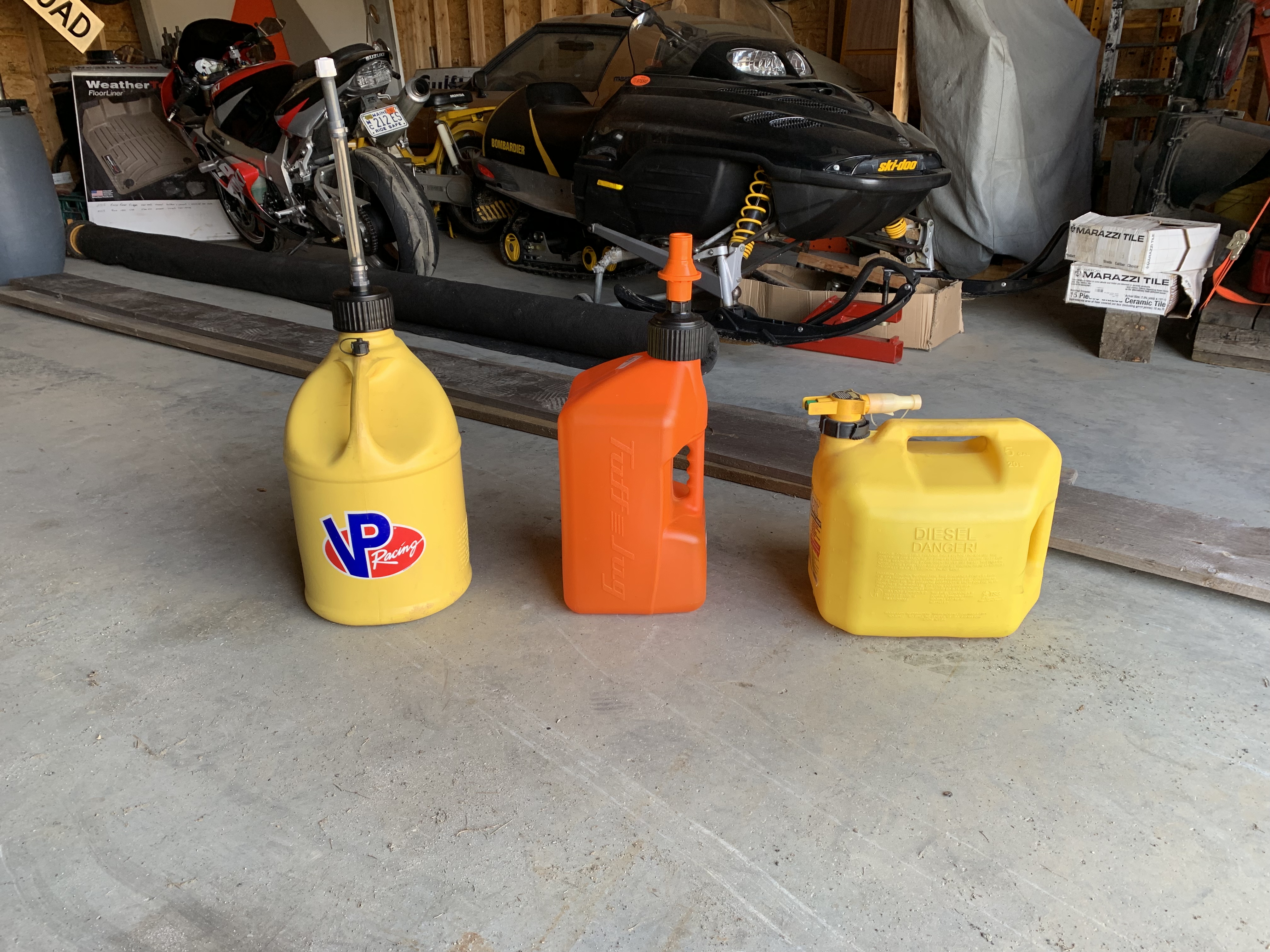

This is my 15 gallon storage and pump station. 3 different pumps, the orange one is my favorite. My fill is on the side and can be filled standing on the ground.
I have the same 5gal yellow one on the right same as you. And a red one for gas. Two modifications though. Added a vent plug just rear of the top handle for better flow, and removed (cut off) the 'safety' ratcheting mechanism that makes it a nuisance to remove the spout for refilling.
I also have the exact same 5 gallon yellow jug on the far right. It is such a pain in the ***, lol! Pushing down that darn green button to dispense the gas while holding the jug 6 feet in the air is a pain.

That's why I got the little pump in my pics just stick the hose in connect the leads pit other end in tank and turn it on

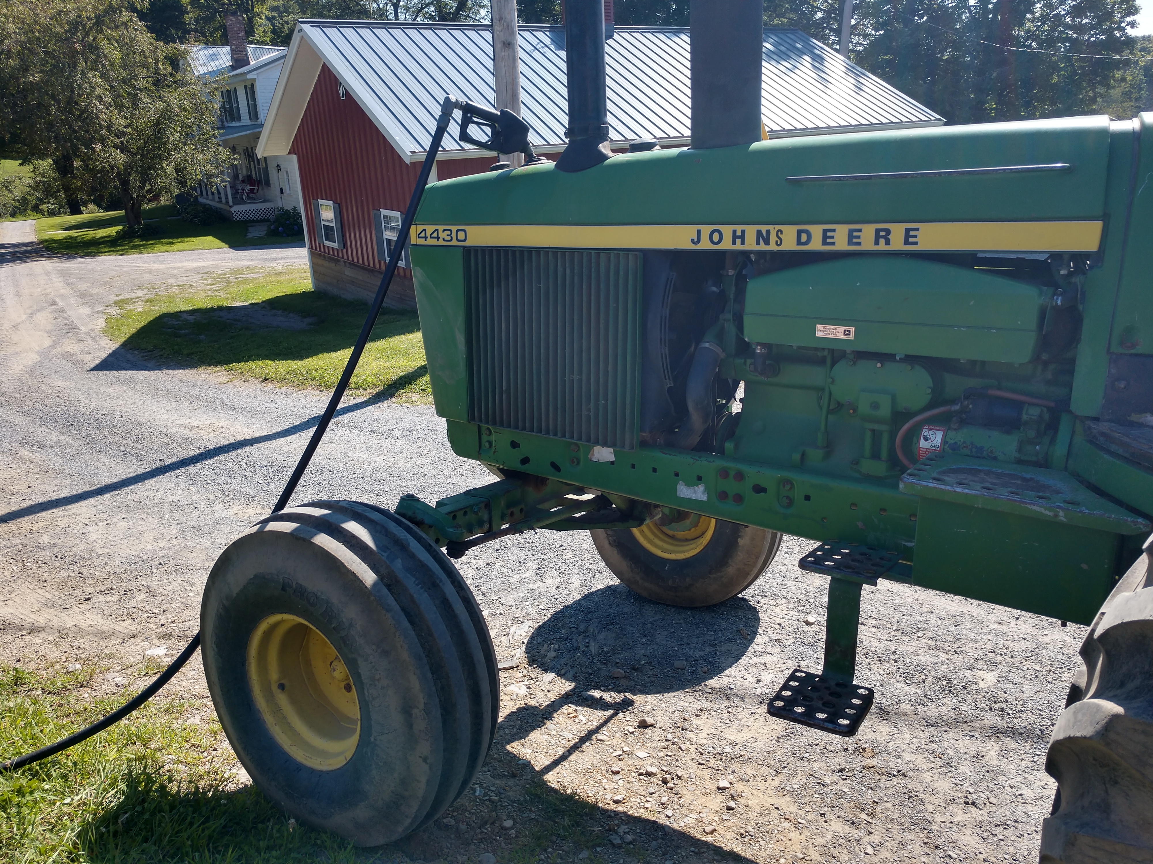

Any volunteers to put over 40 gallons in this one, never could figure out why Deere thought it was a good idea to put the fuel tanks so high and difficult to reach.
Climb up the steps, then reach out with your foot for the top of the tire, then stand on the axle while putting in 30-40 gallons, and of course the engine and radiator is nice and warm too. :laughing:
