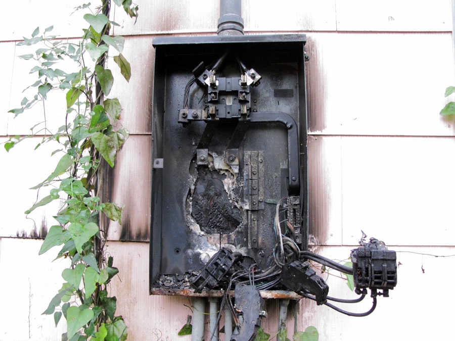

Was this a meter socket or an actual panel?
My wife was watching one of those "flipper" tv shows a while back that was set in Florida and it didn't seem all that uncommon for the breaker panel to be outside. WTF?? Is that a thing there? Why would you want the breaker box outside?

As a new residential electrician in 1982, I built a lot of weather proof services. Builder house plans were not reversed to put garage on service pole side of the lot. WP service was cheaper than extending service into the garage. Owners did not want the breaker panel in a bedroom or living room.
Very common in California and especially for Service Upgrades
The combo meter base with service disconnect and 20 to 40 circuit breakers all in the same box.
In mountain vacation communities it is or was common to use living trees to run neighborhood utility lines… no need for utility poles.
Lots of meters and breaker boxes secured to trees also…
Only seen this in the Tahoe region.
/ Another Question for electricians... #60
The rental neighborhood i lived in for a couple years had the breaker panels outside next to the meter.
These were brand new homes 4 years ago.
