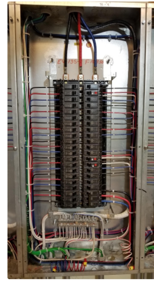

I’ve seen 400 amp service with stepdown transformer direct to inside panel with a small cable tap to a meter mounted outside… always makes me suspicious if truly accurate?
All my installs are weatherhead to meter then panel… pull meter no power to panel.
