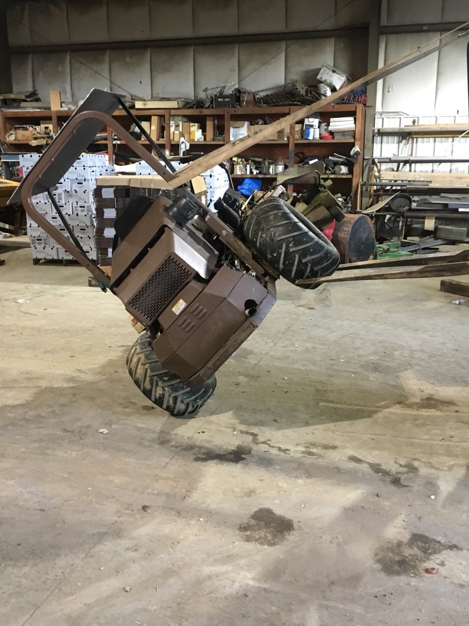

I decided to test what it would really take to flip my grasshopper. The answer was a heck of a hill. The strap is not holding anything and was only there to prevent it from rolling over. My phone angle gauge said 48 degrees and it held down even pushing on the ROPS. I’d like to see even a dedicated slope mower actually mow a hill side that steep. Just staying in the seat would be a real problem. Next I’d worry about the engine lubrication at that angle. IMG_4414.JPG
