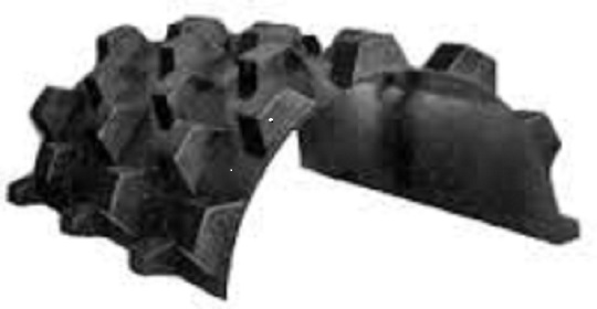

If the tine modifications on your tiller show any promise might could use a design simular to the half shells. Incorporate something on the inside of the shell to rest against several tines after installing. At least that way you could leave your tiller intact. Of course that would be only the two shell design and not the actual teeth or something along that line is worth testing.

In the middle of making a bunch of T shaped tines now. 1/2" x 2" bar....4" long on the tip of each tee. 32 in total on the 54" tiller.
I thin the single biggest thing that will help is gonna be the gauge wheels, where I can adjust to control depth, rather than roller digging in or coming out ever bump the tractor goes over, continuing to magnify the roughness.

While that'll dig properly do you think the diggings will roll over the top and be dispensed evenly at the rear of the blade as the solid roller with nubs would carry more dirt over since there's no open gaps between the nubs. Since you'll be using this in an area that don't need large pieces and rocks seperated (already finish material) the adjustable shield used on other power rakes wouldn't help you out. I'm assuming you just want to stir up whats there and place it back smooth. I'm just thinking and writing it down and sometimes that can be dangerous:)
