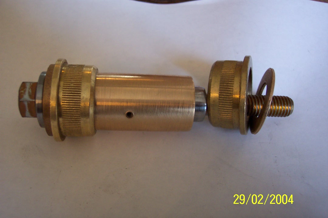

Your modifications are impressive. The only fly in the ointment that I can see is the sharp edge on the wheel itself cutting into the turf on turns. I believe that is why Kubota built the wheel the way that they did.
What I don't understand is how is the grease going to get from the grease fitting to the inside of the bearing to the axle. I understand that you are filling the cavity, but how will you get sufficient amount of grease between the bronze bushing and the axle itself to keep it properly lubricated? Wouldn't it have been better to put the grease in /forums/images/graemlins/confused.giffrom the center of the axle? I am certain that if I had it in my hand, I could figure it out, but I believe that there is something missing in the pictures. Or.... possibly, it is one of my senior moments in time that is confusing me..... /forums/images/graemlins/blush.gif
   / Anti-Scalp Roller Mod's?
#82
Re: Anti-Scalp Roller Mod\'s?
Junkman,
Refer to the attached pic.
See the knurled fittings of the hat bushings on either end of the tubular bushing? (2nd hat bushing is not installed because I have to install the wheel 1st before pressing on the 2nd hat bushing). See how the OD of the knurled section is larger than that of the tubular section? The knurled part is what friction-fits into the wheel ID. So, since the tubular part (where the holes are drilled) is smaller dia. than the wheel ID, there is a ~1/8" doughnut void that is formed. The
grease fitting will supply grease to this doughnut area. Once the doughnut is full of grease, additional pumps of the grease gun will force grease through the holes drilled into the tubular shaped bushing....where the axle is located.
With a little luck, as the wheel bearing area heats up during use, the grease in the doughnut area will warm up, expand, and additional grease will be forced through the drilled holes into the axle area.
I e-mailed Moweraxle a while ago to see if he would be willing to make me up some 3/4" axles so that this installation will become a piece of cake. Will update later.
I agree about the rounded wheels issue. The vendor could not come up with the ultimate wheel resin composition that is in the rounded form. He explained that there is a little bit of radius that should help a little with side-ways slippage. Also, the 'flat-sided' wheels are natually much more stronger since they have not been hollowed out like the OEM's. Lastly, the vendor spec'd out 3/4" axles that could take any additional abuse from 'catching' in sideways motion. The vendor and I discussed this in length before I agreed to try this flat-sided, minimal tread radius wheel. I feel comfortable that this is not going to be an issue....but proof's in the pudding come mowing season!
