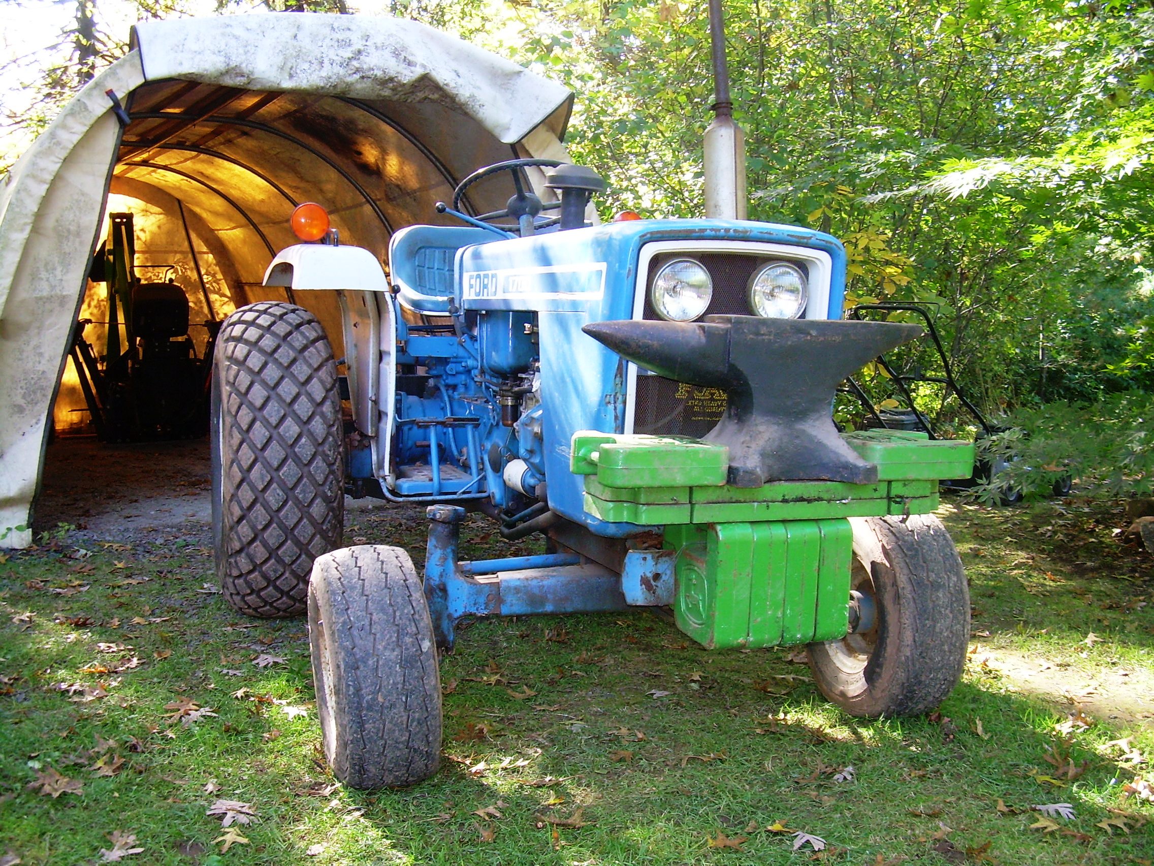

Here's a pic of mine used as an extra counter weight for when I moved my JD's BH with lighter Ford, in and out of a storage tent that the JD wont fit due to ROPS mounted canopy.
IMO, unless your a black smith, alot of things can substitute for an anvil, I think a monster vise is more useful for metal fabbing, nothing to substitute for a heavy vise on a stable platform.

JB4310, that is one sweet anvil. I love it on the front of your tractor. Nice touch!:D
