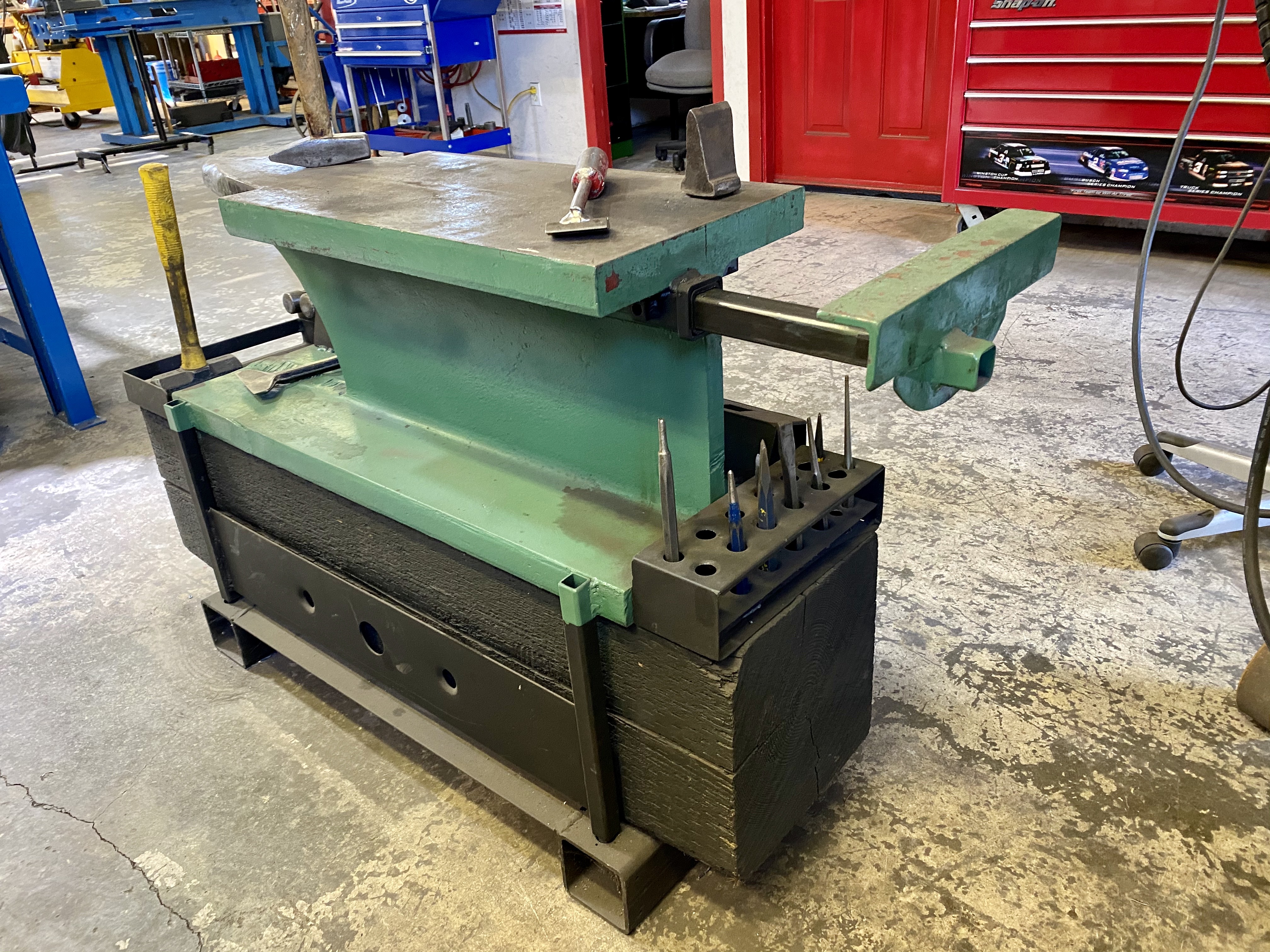

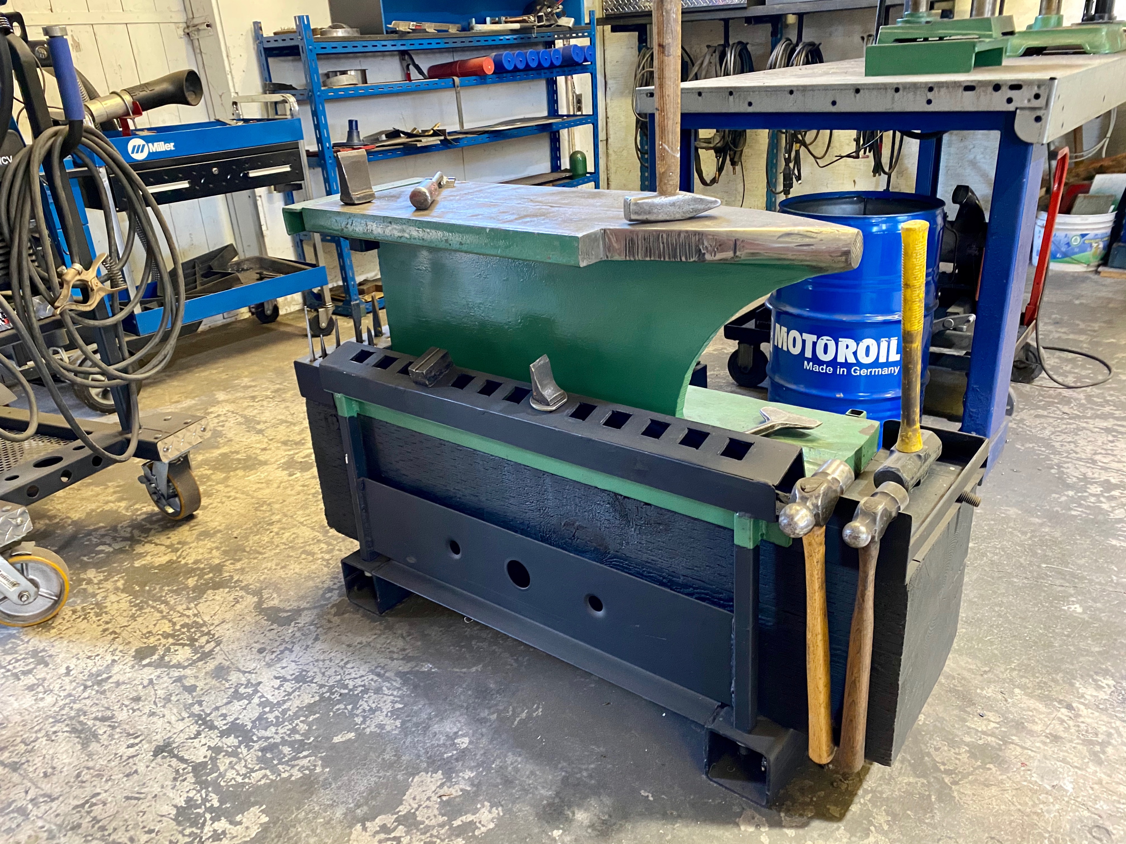

When you find a anvil make a good stand. Often the most over looked and under appreciated shop tool. A chunk of wood on concrete floor is poor. A timber 6’ in the ground better. The anvil is not suppose to move when struck. This one is made from 8x16x0.31” steel tube. Inside filled with 8’ of railroad rail, and grout made with years of plasma cutting dross and drops, drill press sharps, 50# steel shot, 50# sandblasting media and cement. >700# before anvil. Solid attachment bedded in Vulkem gives great rebound and is quiet. Similar filled tube with large base for 6” leg vise. Note receiver hitch to hold other shop tools like benders or rollers. Use a leg vise as much as an anvil for my blacksmithing.

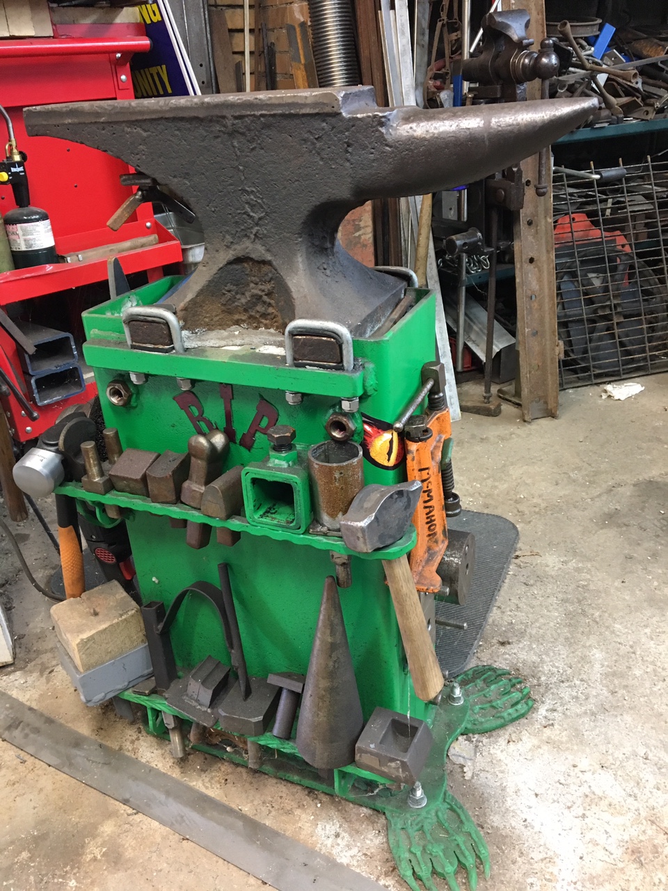

Anvil is loan from a friend. This area changed sides during the civil war several times. To hobble the other army anvils were either broke or dropped in deep water. His family had a story that they buried the anvil in the garden to protect it. Not knowing what happened afterwards till recently, 40years, a tractor plowing hit it. Lost the makers marks and a few pounds from rust from being buried. Now 136#. Would bring $800 around here as there is a surge of interest, family history priceless.

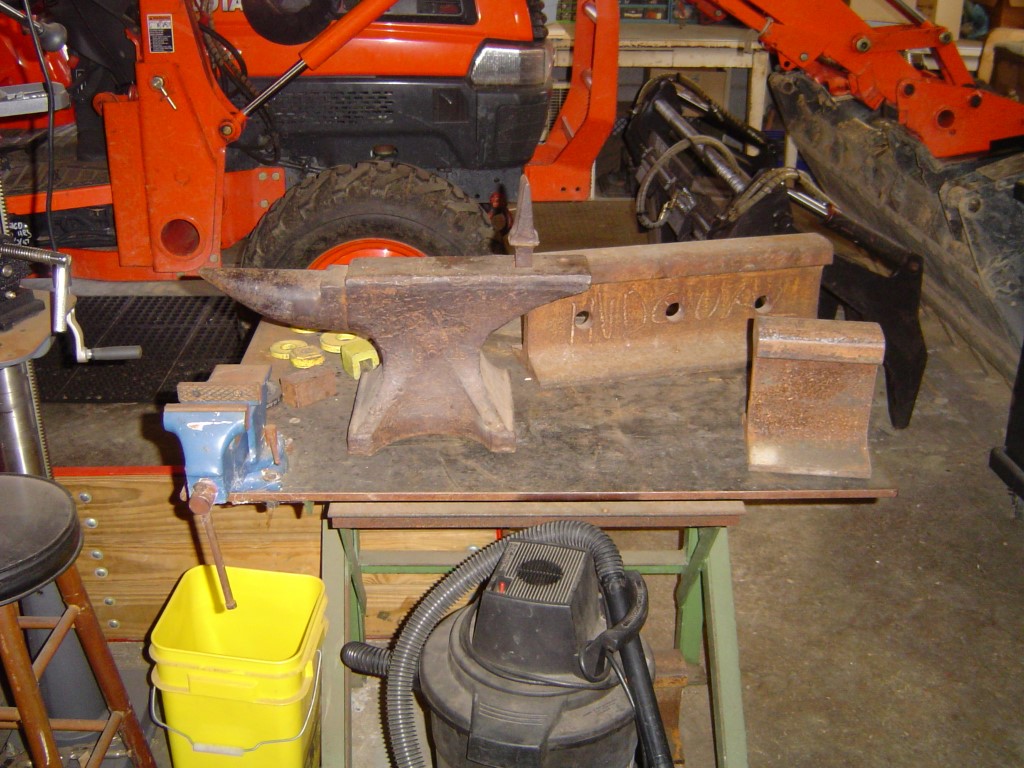

I got my anvil back in the mid-80s. I wanted one and put a wanted ad in the local Farmer's Market Bulletin. I got several calls and looked at some that were too beat up or too large. The one I bought from an old farmer weighs 88 pounds and I paid $45 back
then. I use it all the time for odd projects. I don't know who made it, but it is pretty old.

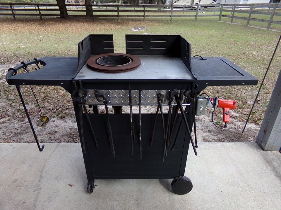

This is how it started..View attachment 679125
I have my old gutted Vermont American heavy duty BBQ sitting out front waiting for me to haul it away for scrap. Stop! I routinely got that thing up to around 700+ or hotter, actually no idea how hot. Had nothing that could measure the temp higher than the pegged thermometer.
Worth a mod. Any tips/instructions for the build?
