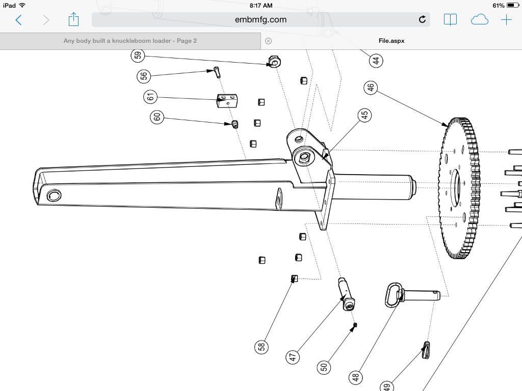

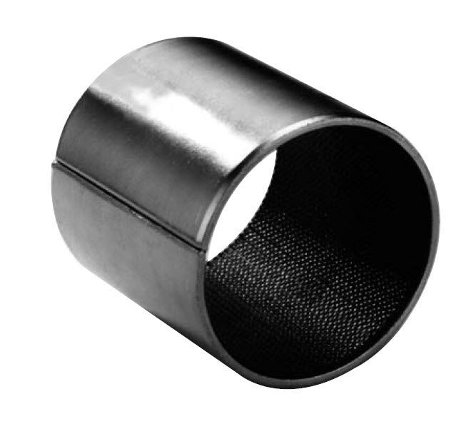

This looks like what mike h was describing. It's the wallenstein timber talon 95. They use a "fiber glide thrust bearing" between the inner rod and outer pipe.
http://www.embmfg.com/File.aspx?id=2fcf52b7-77fe-416b-bcdc-7d9ec50ca357&display=full
   / Any body built a knuckleboom loader
#18
Thanks Mike, I see that the support shaft on that loader is 3in dia. Looking at the specs for the loader, it is only rated for 900lbs. Not big enough for what I need, but the drawings can be adapted and scaled up.
