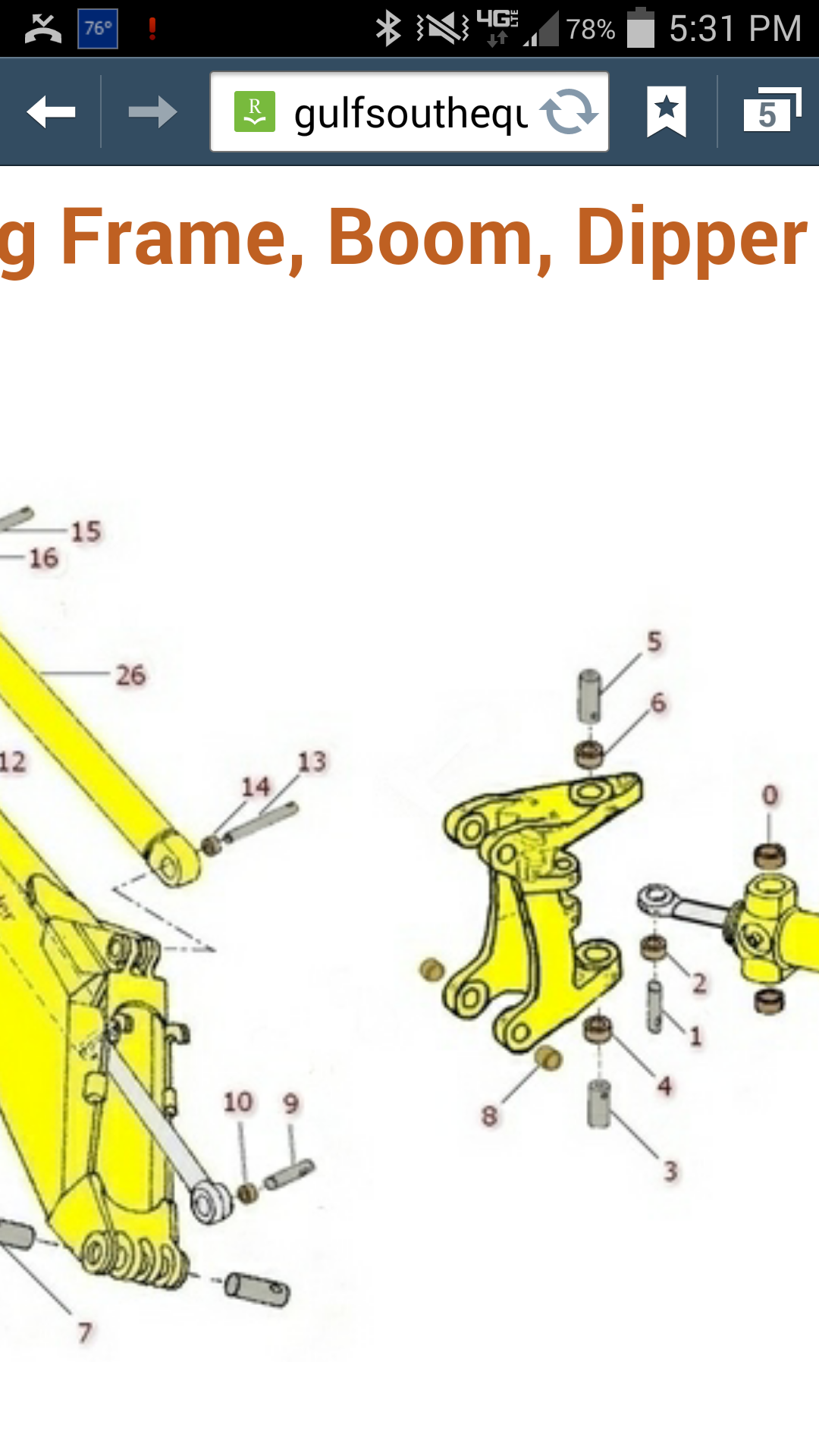

Wonder if you could use a backhoe style swing. You wouldn't have 360 but they are easier to find as scrap

My original plans where to use a backhoe attachment off a ditchwitch. I bought a a620 attachment with plans on flipping it upside down to place the knuckle up high. Everthing was there, but it had it drawbacks, mainly weight. The attachment weighed 3000lbs and I just couldnt figure out a way to refab it and put it on a diet. Guy drove up into the yard the day before I started this thread and wanted it worse than I did. I made $500 profit and figure i would just use the money to build from scratch. I am still considering a backhoe swing assembly and think I have one located, but the boom and outriggers are just to heavy.

It looks to be a john deere re-branded gafner loader.
