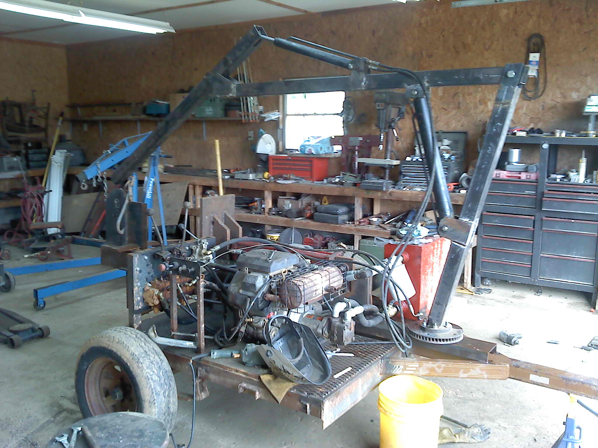

I actually have a boom off a long arm mower I thought about using. Its a little short, but I got the cylinders for it and the valve bank. I probably wont use that entire boom because it is only 10ft, but I am thinking about using the root boom portion as a dipper boom on my loader. The dipper boom had a knuckle in the middle to allow the mower to kick back incase you hit something when mowing. I used the cylinders to make a small knuckle boom for my log spliter. it was strong enough to pick up the size wood I wanted at 14ft extended. To bad my swivel wasnt up to the task.

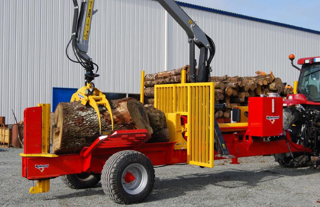

That's what I want to build for my new splitter, but with a hydraulic grapple.
Like this
   / Any body built a knuckleboom loader #69
Now that's a splitter.

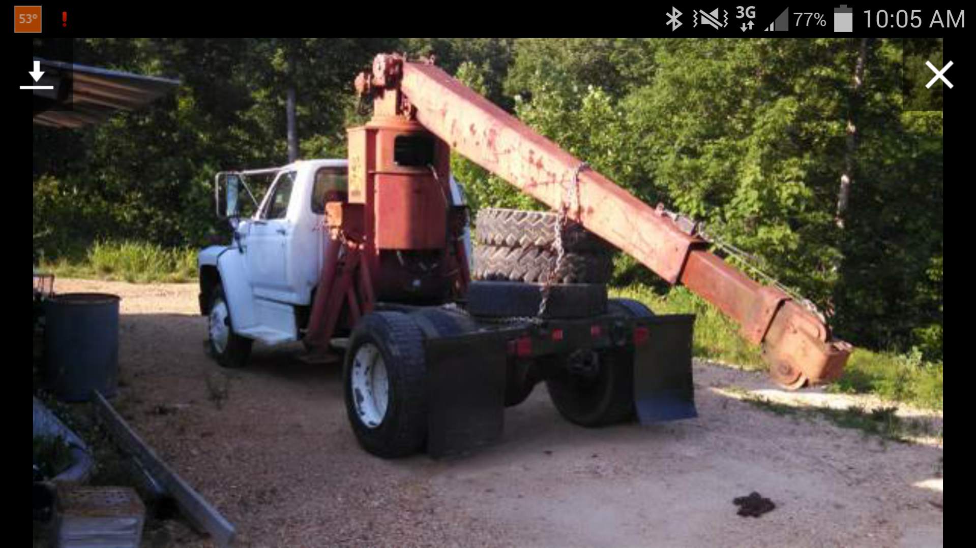

Found this truck on Craigslist in hohenwald TN for $3000 or best offer come on down and we'll go in half and you can carry the boom home with you lol.
