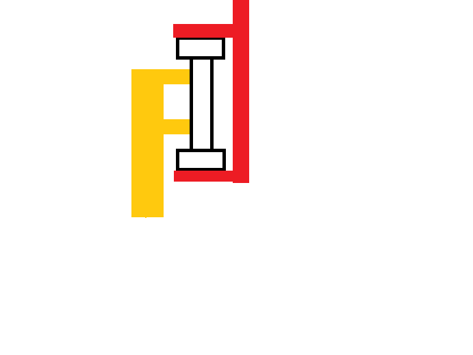

If you built a tower and put the entire axle (shortened of course) next to the tower and put a plate on both top and bottom hubs with your pivoting mast next to axle it would utilize both hubs and be of a push/pull force on the hubs and would at least double the capacity. You could probably get at least 270 degrees of swing out of it.
Sorry it probably isn't clear, if I was at my computer I would draw a picture.

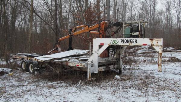

Here's an example of a unit for sale near me: 2008 Metavic Forwarding Trailer (might have to copy-paste)
The post does not look as rugged as you're talking about re the truck axle. Might be going back to pipe-in-pipe plus a thrust bearing could be simpler?

A pic would clear it up, but I think I understand.
I spent hours on this computer simulation so I hope it helps. :rolleyes: The Yellow would be some sort of post, the black is the truck axle, and the red would be the pivoting mast. Like I said, it won't get you 360 degrees, but hopefully close to 270 or so.
