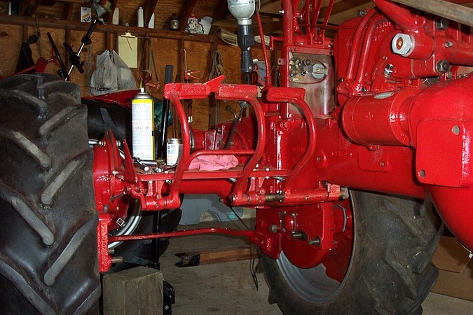

Mornin Guys,
OK, heres the latest ! The hydraulics touch control unit is pretty much all together. One of the lift arms was ruined with some barn yard welding and I had to get another one :mad: We are getting close on this end of the project :)
Then I started working on the drawbar and realized I needed to repair a torchcut hole on one side of the drawbar. Bored the hole ot and made a 1 1/4" plug and welded that in position along with the 11/16" hole :mad: Another barnyard snafu :)
Then I started to install the starter after cleaning and painting, nice easy job right??? Nope, the threads are stripped :mad: Barnyard muscle mechanic :) Well had to redrill holes and insert 7/16" helicoils, moving right along here :)
Thats the latest, oh and I might have a line on a grill, well see :)

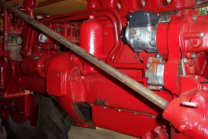

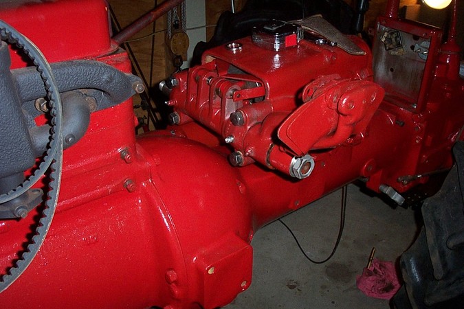

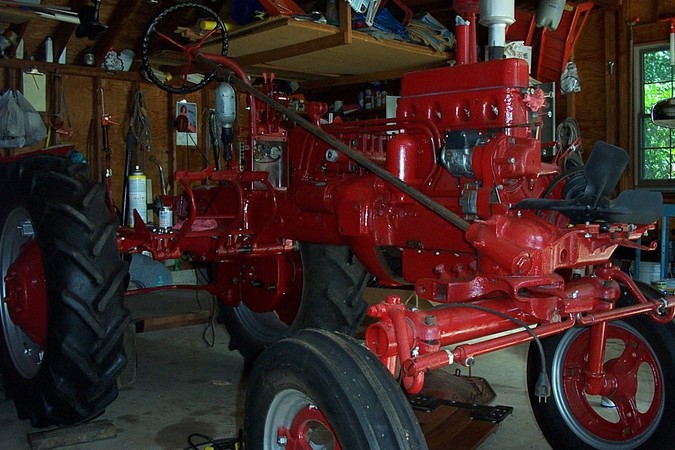

Mornin Guys,
A little update !!! :)
The first photo is a pic of the magneto and hydraulic lines just installed along with the hydraulic pump.
The second photo is a pic of the clutch and brake petal assembly. The right brake which is obviously the left pedal in the pic, I had to rebore the support and install a new bushing on that support because that brake pedal just wobbled all over the place from all those right hand turns in the field :) This trade does have a few benefits :)
The third pic is just a left side shot. You will notice that the fan assembly is just laying on the front bolster. That is because I had the radiator on and proceeded to fill the cooling system with antifreeze only to discover that I had a slight weep from the top inlet on the block :mad: Darn, drain the entire system, remove radiator, order new gasket and issue a few choice words when the wife is not in ear shot :)
I bought a repro grill assembly $$$, dont ask !!! :mad: I installed it last night and its a snug fit on the radiator, just to see how it fits before I paint all the sheet metal ! I will post that pic later, still havent figured out why its primen black :confused: Anyway thats it for now.
