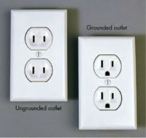

2 electrical receptacles and 1 GFCI receptacle push the button marked reset

Yeah, since it's a garage it's got to be wired GFI, so I bet one of the GFIs tripped and took out everything downstream. Sometimes they leak and trip for no reason, just need to reset them.

Yeiks..... This is why i charge so much to fix the things that homeowners do to their houses. Lol
about a month ago. Had an ahole call me and pick my brain on why his garage wasnt working. I asked him if he checked his gfci recepticle, and he came unglued on me over the phone. Told me he wasnt an idiot...he knew how to check a gfci..bla bla bla,
so i made the 45 minute drive out there...ent into the garage and pressd the gfci reset. Power reset. Handed him the bill.
he couldnt even look me in the eye.
