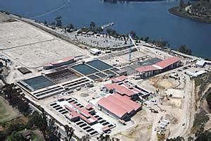

When I google butterfly roofs most are really 'V's. The wastewater treatment plant near us did a (very expensive) renovation and added large buildings with graceful butterfly roofs. These pics were gleaned from the 'net, I've never taken any pics of it, but could if you want better views.
