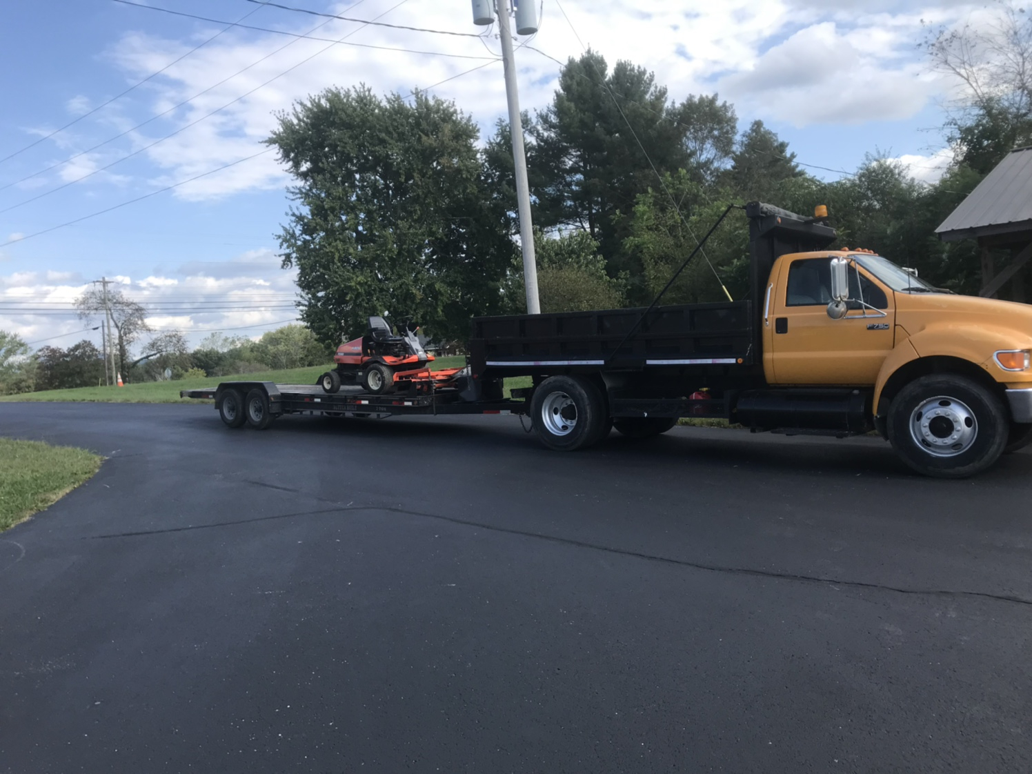

Sell you my Kaufman Goose neck, tandem axle with new tires and brakes (last year). Needs a few deck boards but it is a deck over as well. It will load and haul anything you have but you'll need a real pickup to pull it with. 1/2 ton weenies don't work.

Your transmission would go south pretty quick with my GN. The trailer alone is over 10K with a 14K payload capacity. A bit more than a Tundra can deal with. I don't consider that to be a full size truck anyway.
