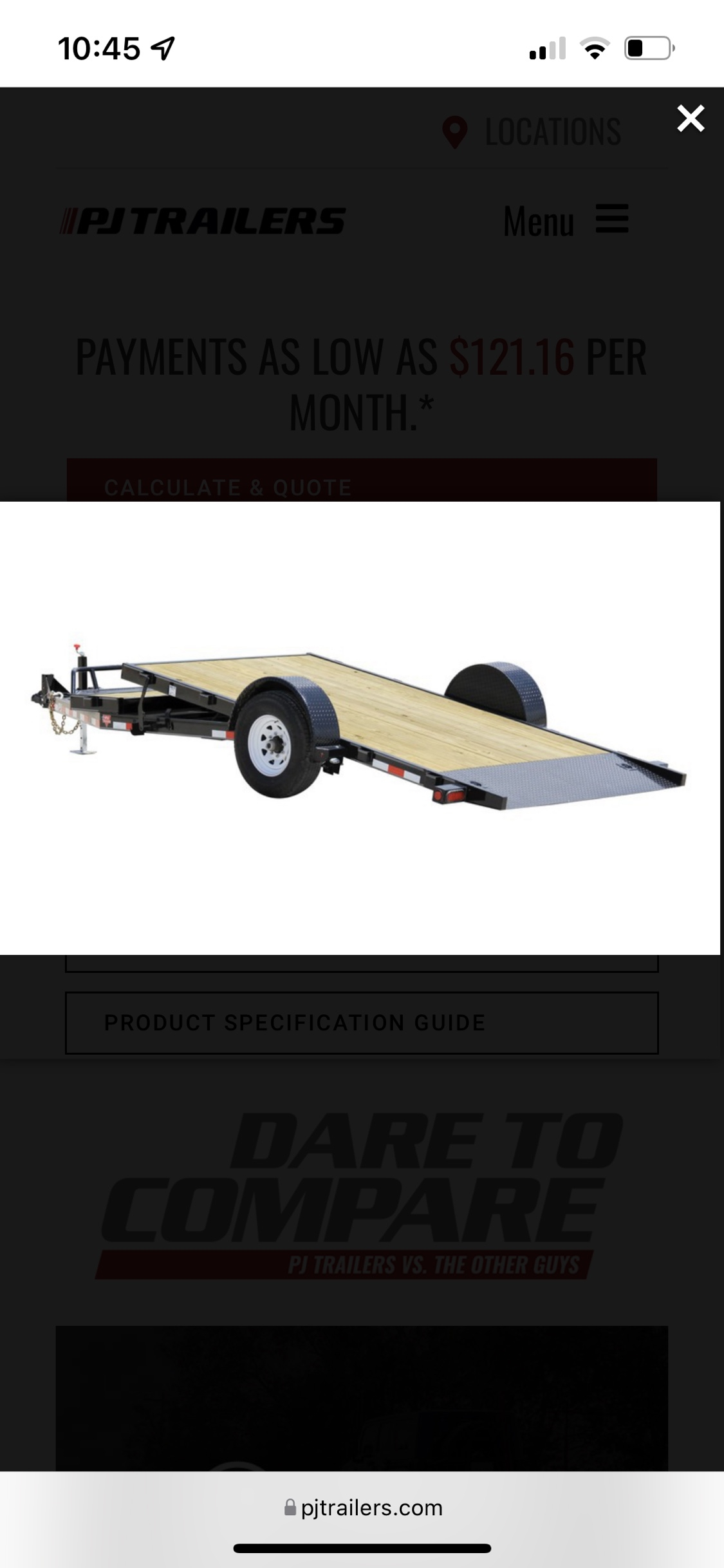

On a more serious note they make some fairly beefy single axel equipment trailers. They’re fairly common with rental yards. This one has a 7,000 pound axel. View attachment 725024
Yep, I wouldn’t own one for driving any distance at highway speeds. Your life depends on not having a tire failure

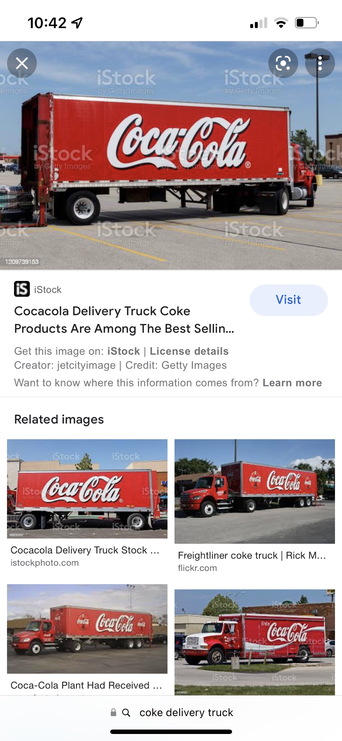

Slow speed delivery around town is far different than highway speed travel, and that single axle has duel wheels on each side so one tire failure doesn’t create severe handling problems.
That is a highway truck. The in town trucks usually have the side access roll up doors. I think we can agree that’s in a different league than a 5x8 trailer but it is by definition a single axel.
True. With duel wheels. Not the same thing as those single axle utility trailers that we are discussing on this thread.
Yep. My Stage Coach utility trailer single axle is a 7000 lb axle. Solid C-channel cross members and frame. Probably not as stout as the tilt you are showing which is more for skid steer transport. Being longer and with mesh sides I can haul one heck of a load of mulch, an occasional Kubota and everything short of larger tractors where I go to the Pequea dual axle.

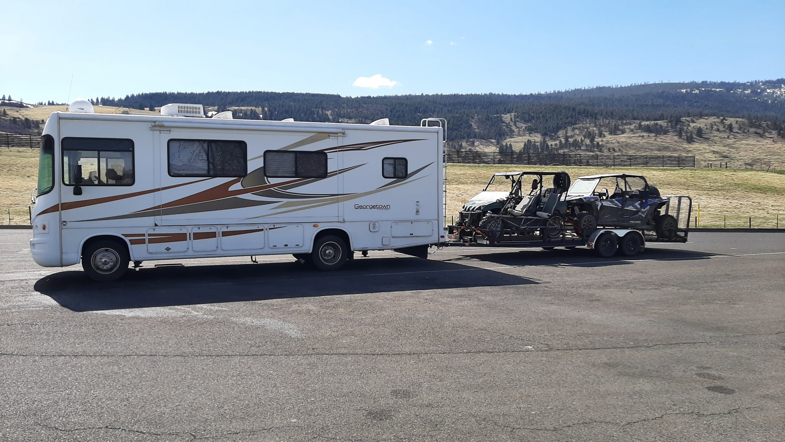

Prices are going up. I bought a 7 x 22 7000 lb tandem axle trailer last spring for $3600. Now, they are asking $4175 for a 20 footer.
I really like the tailgate/ramp, but it is a gas killer if you tow the trailer empty. I use the new trailer for hauling my two SXS. Haven't put the TLB on it, yet.

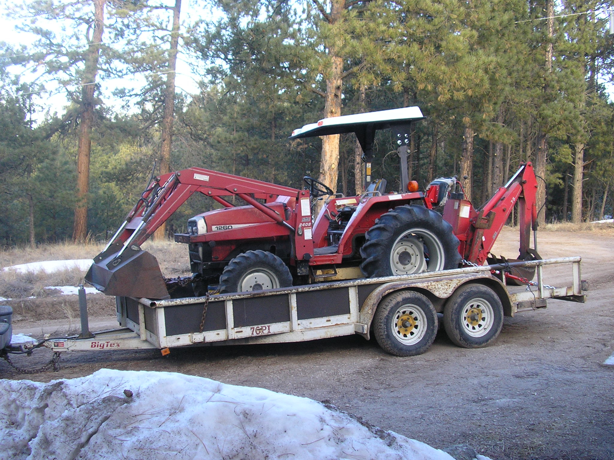

I think you'll be fine with a 16' trailer for you TLB. My old trailer was 16' and I hauled my MF1260 TLB on it. It's a little bigger than your B2920. Set the front bucket on the front bed rail and swing the backhoe to the side (Although that's not how it is in the picture). In this picture I have the TLB a little too far forward. This was the first time I hauled it. Now I load it back 6" to 8" from what is shown.
You'll notice that the front chains go over the top of the side rail to a tie down point. We have since cut a small opening in the side so the chains go directly to the tie down. That makes for a much more secure load. You'll want to do something similar to the mesh on the trailer you are looking at.
