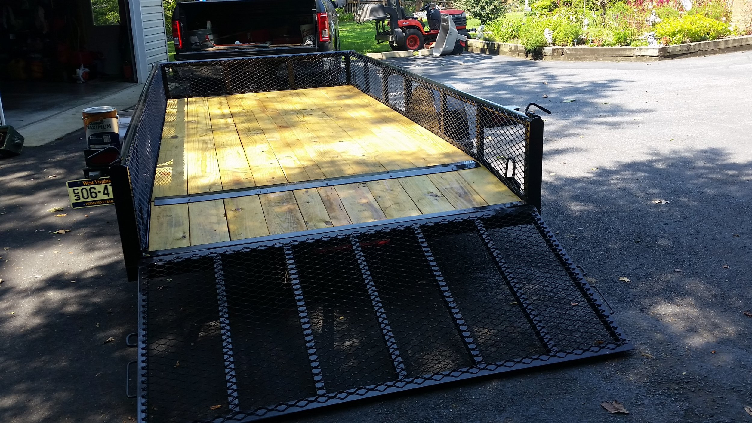

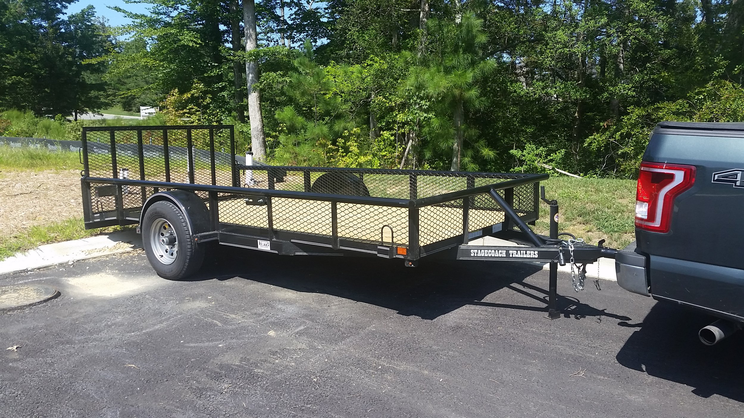

For example my Stagecoach brand has an upgrade stronger axle, stronger than std tires, 78" wide bed, small amount of beavertail which helps a huge amount when loading AND makes the tailgate much shorter and easier to lift without springs. It would very easily handle your loads that we know about. It cost me a hair over $2000 via dealer in Bossier City LA 4 years ago. See Utility Trailers For Sale New & Used | Topps Trailer Sales in LA dealer website in Bossier City. I do not know where all Stagecoach has dealers but they are made in TX, are VERY well made and durable. The mfr is super receptive to doing mods and custom stuff to suit you at not exorbitant prices.
The top rim frame is heavy 2"+ size pipe, a lot stronger than thin angle iron. I've owned both. View attachment 724881 I added mesh sides, extra post holder slots, a spare tire holder, etc.

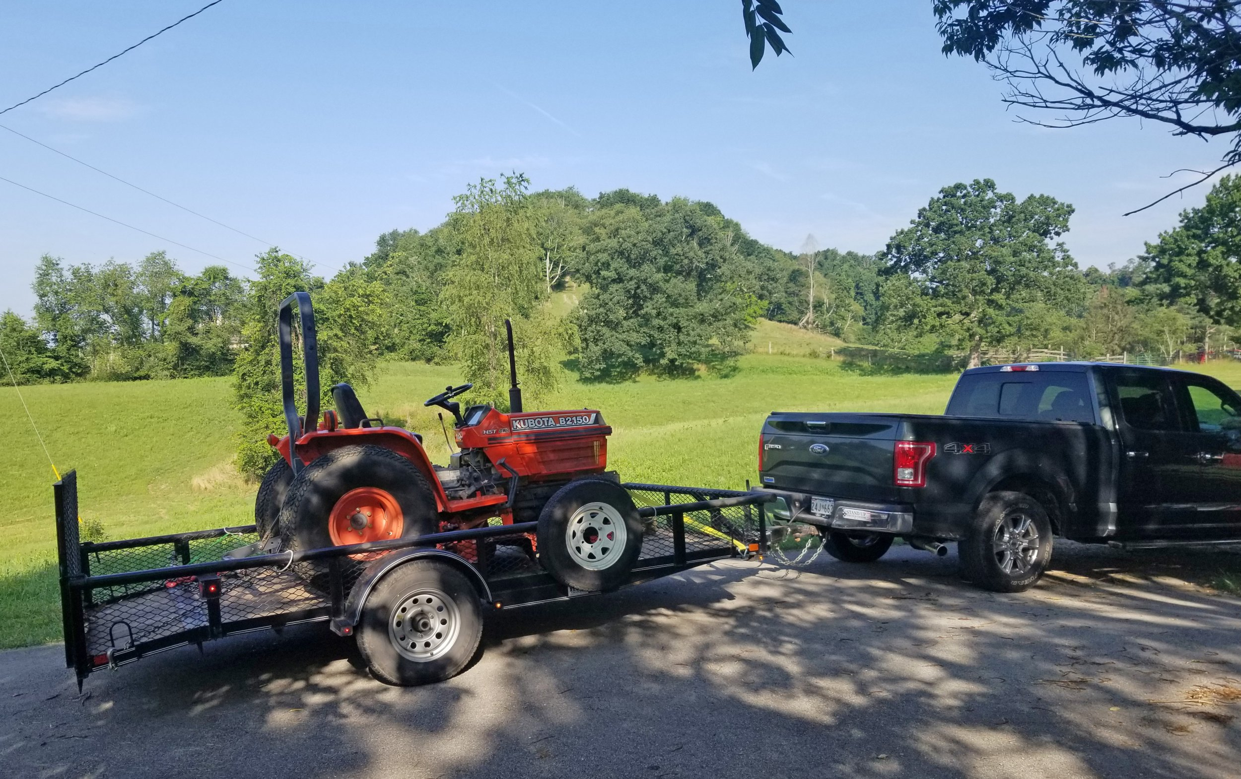

View attachment 724878View attachment 724880

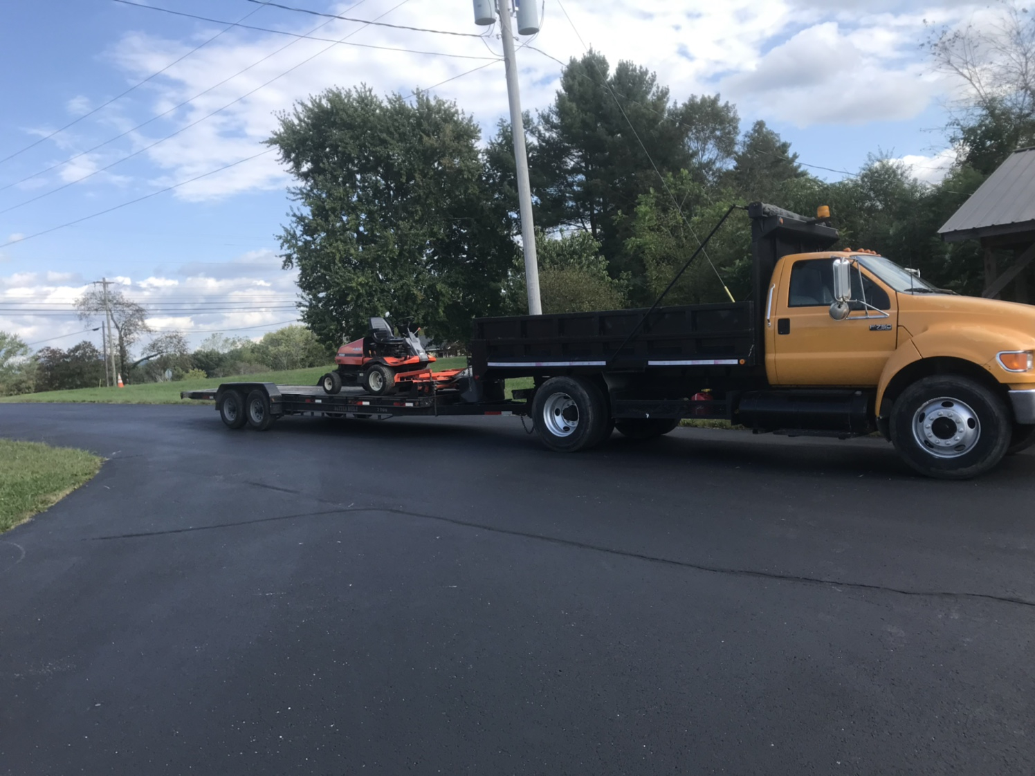

Agreed. A single axel 5x8 with a drop gate is a handy trailer. It’s much better than trying to hand load something heavy on a pickup. I’ve been wanting to build a heavy duty 7x8 tilt trailer to haul my lawnmower on. It’s a little annoying having to take my 22’ tilt to haul a mower. View attachment 725011
That is an appropriate use for a light single axle trailer, not towing a tractor.

I would never own or tow anything heavier than a ATV with a single axle trailer without brakes. Might work for slow back roads, but I would never tow a tractor on those at highway speeds. One tire failure and you are all over the road, or the same with an emergency stop.
Your opinion. I hauled a Kubota B2150 from Iowa to WV in July using my single axle Stagecoach trailer ( pictured in post #19. ) Very smooth, effortless, just as safe as anything you have ever towed. All interstates except for around 100 miles of two lane, some on each end. I ran cruise control at 75 for about 90% of the trip with occasional variances normally, of course. After some farm work I hauled it another 85 miles on steep mountain roads some exceeding 9% grades with absolutely no problems or hints of problems. Any tire failure other than a very unlikely sudden blowout would have been easily controlled if you pay attention. I pay attention . The tires are heavier capacity than std and near new. The axle was a HD option and is rated at around twice what my total GVWR was. Other than a crash no emergency stop would bother me with this rig. My larger trailer is a Pequea 1018 with brakes on both axles and the trailer itself weighs around 3000lbs. No justification of any kind to use the larger trailer for that Iowa trip. My opinion.
