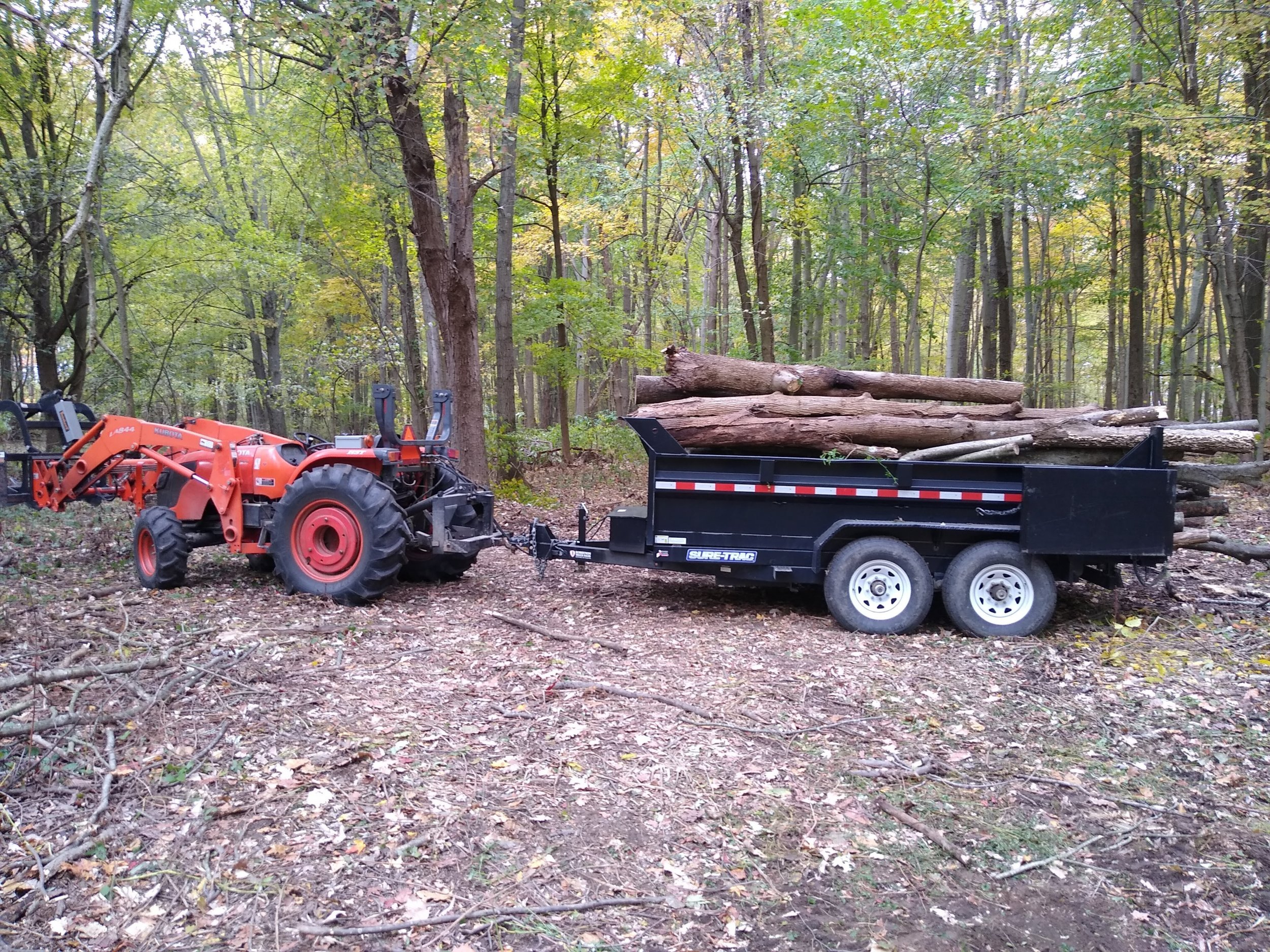

I have quick connects on the hoses at the pump. I disconnect them and plug them into tractor remotes for most of my needs. No need for a gas motor/pump combo when a couple hydraulic hoses to the tractor do the trick nicely.
Hauling logs from the woods, doors stay open. No need to even get off seat. Hit lever and keep driving.
