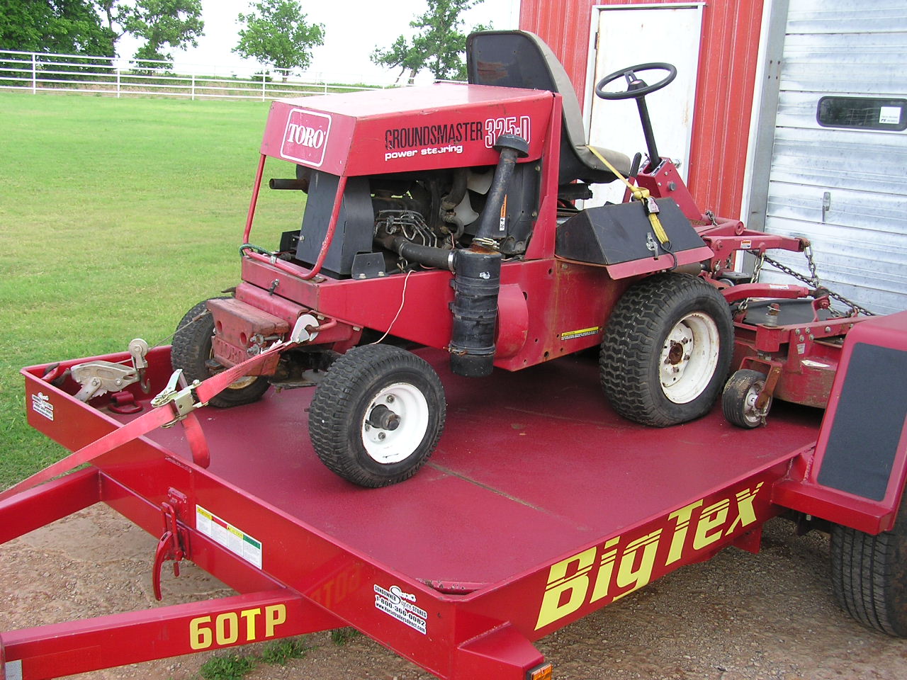

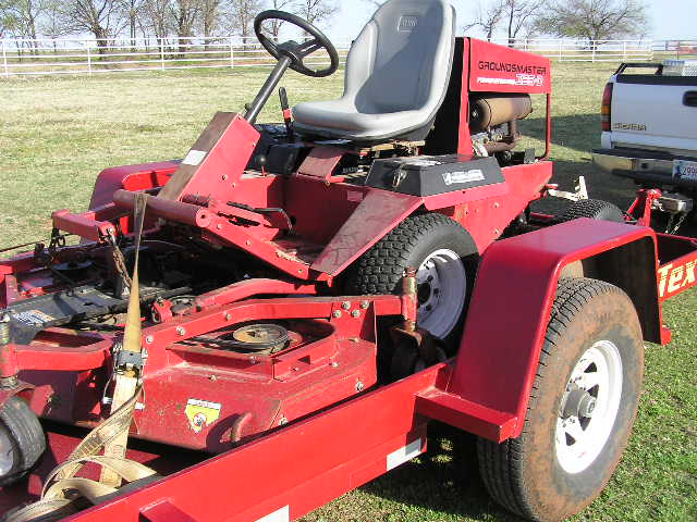

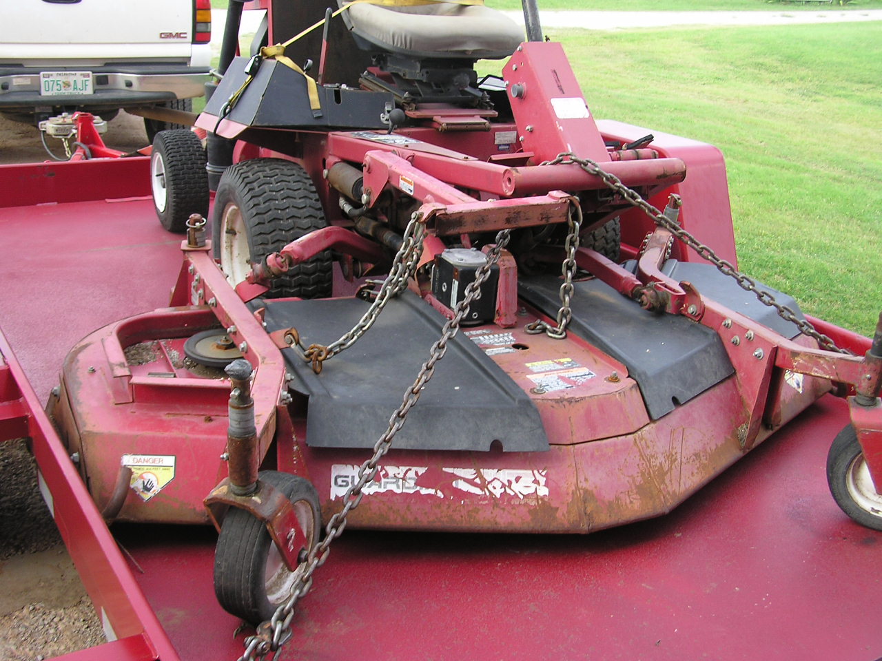

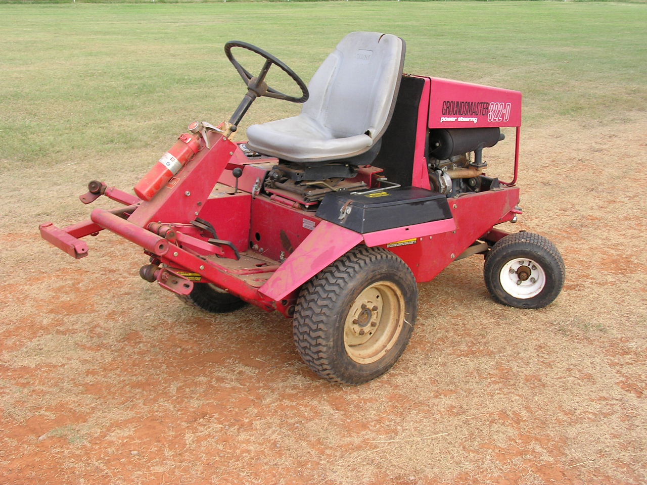

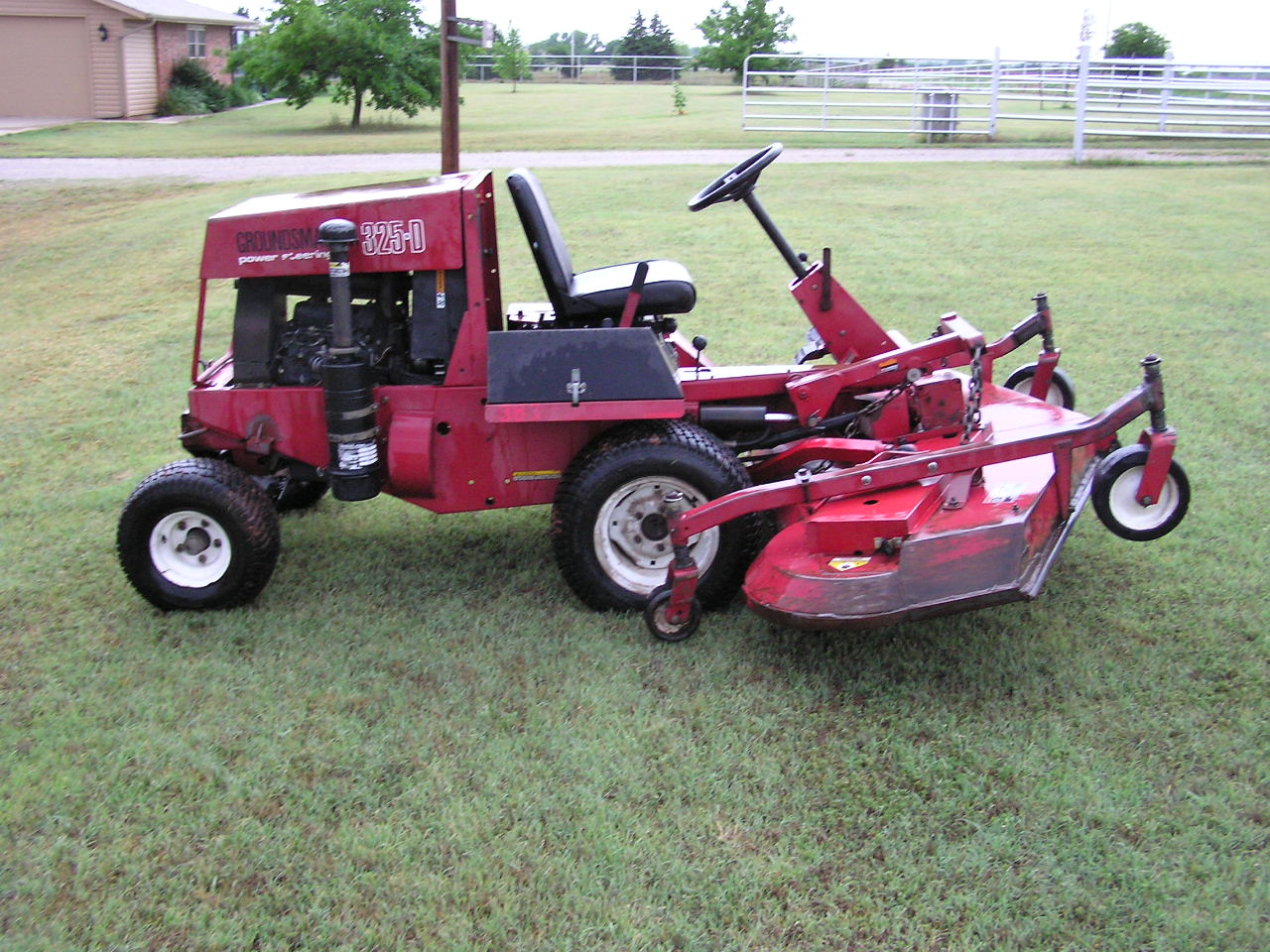

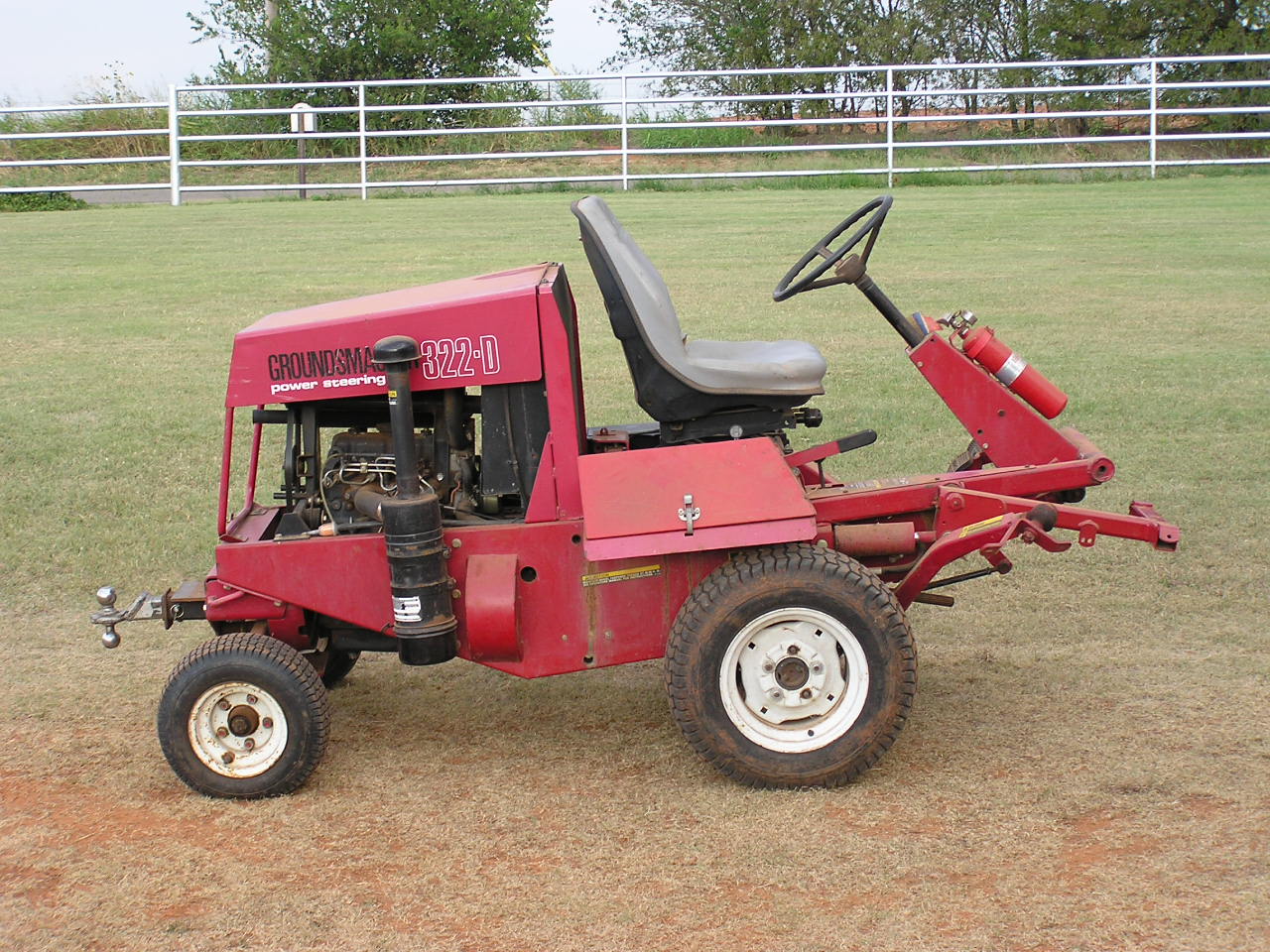

Yes, I have four Groundsmasters with the Mitsubishi 3 cylinder diesel engine and a front hydrostatic transaxle.

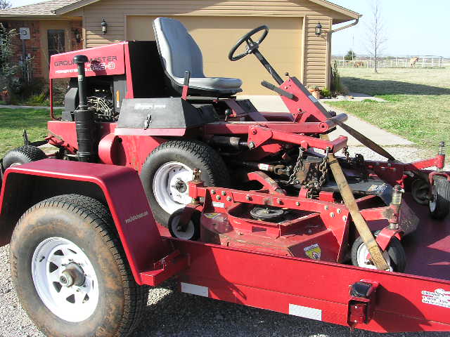

First one is a 1990 322D, I got in September of 2004,
View attachment 357211 View attachment 357212 View attachment 357213 View attachment 357214

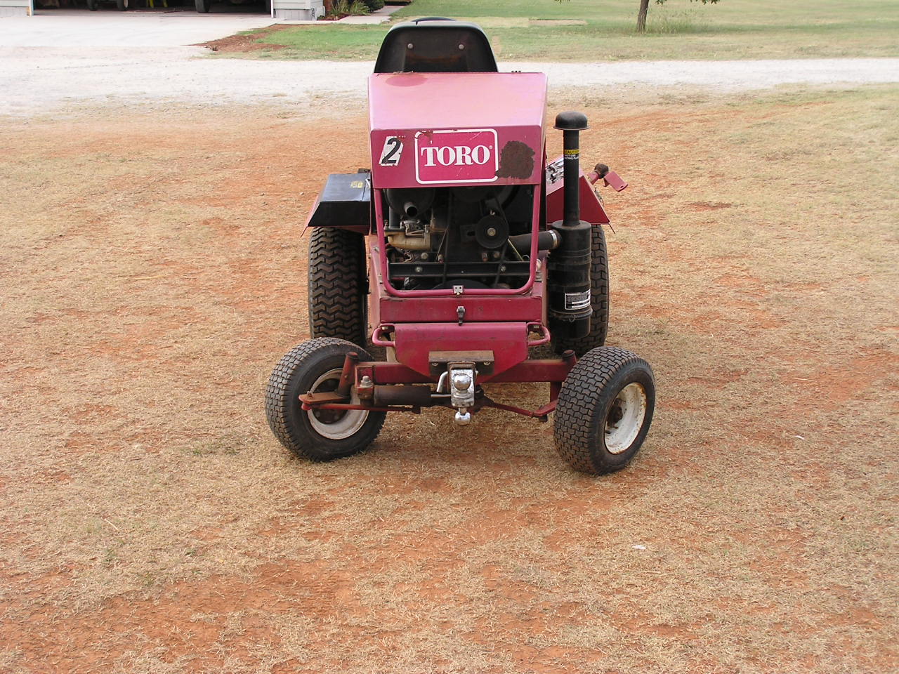

Second one is a 1993 325D, I found on eBay in May 2005. Bought it for mowing, with the 6' deck.
View attachment 357215 View attachment 357216 View attachment 357217 View attachment 357218

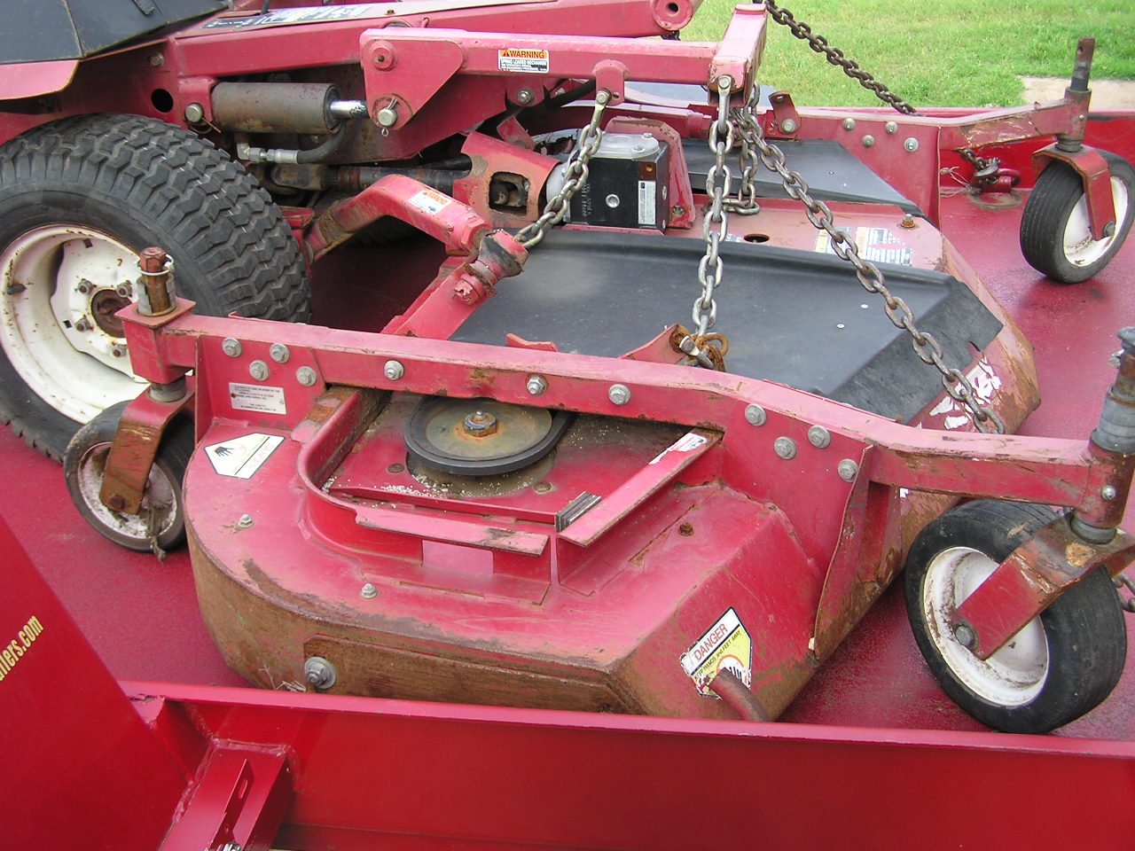

Third one is a 1994 325D, from eBay in May 2008. Parts machine, with a good recycle deck.
View attachment 357219 View attachment 357220 View attachment 357221 View attachment 357222

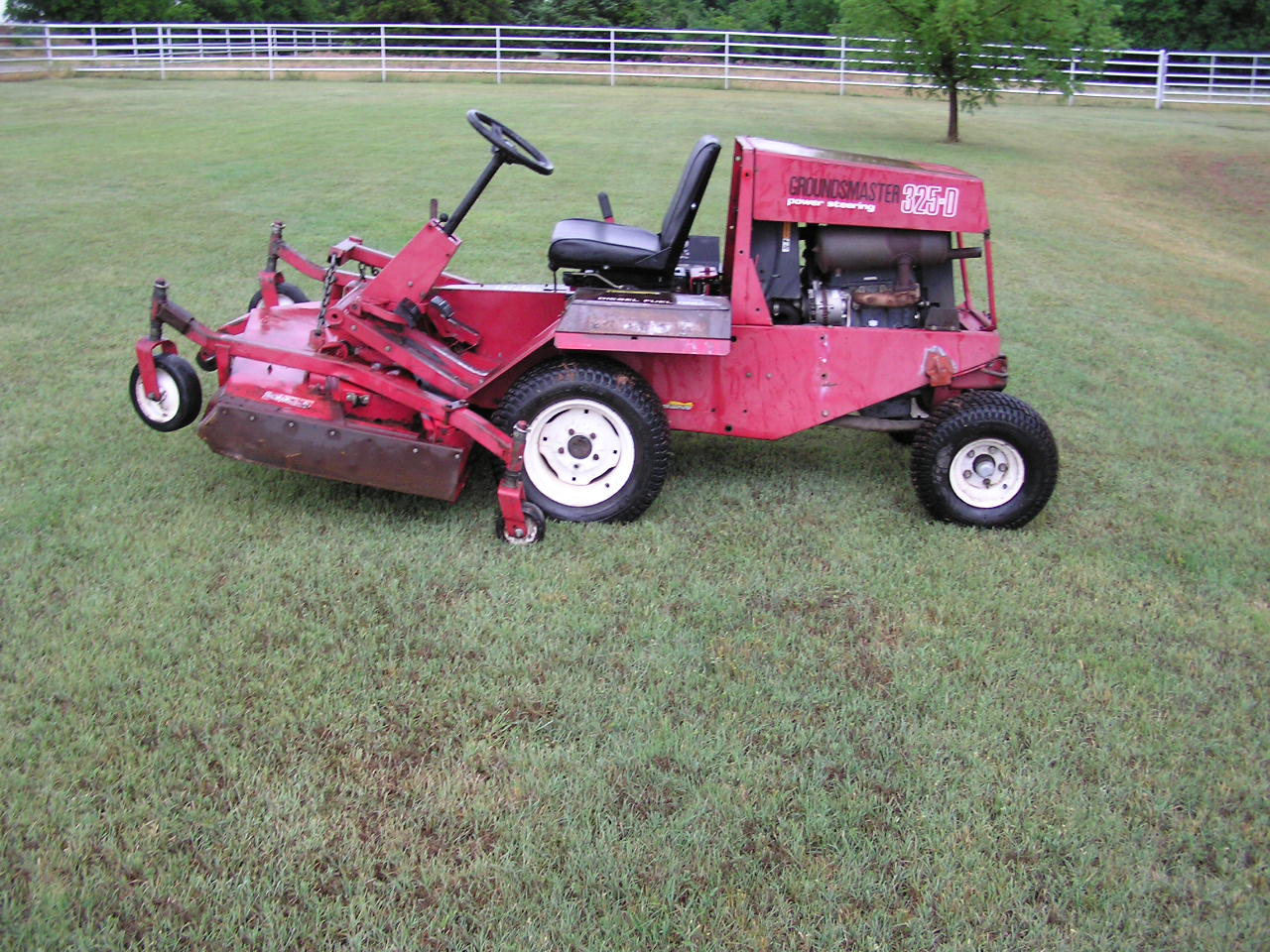

Fourth one is a 1996 325D, from Bell Equipment, Stillwater, OK. Bought it in March 2009, for the 4WD and newer recycle deck.
View attachment 357223 View attachment 357224 View attachment 357225 View attachment 357226

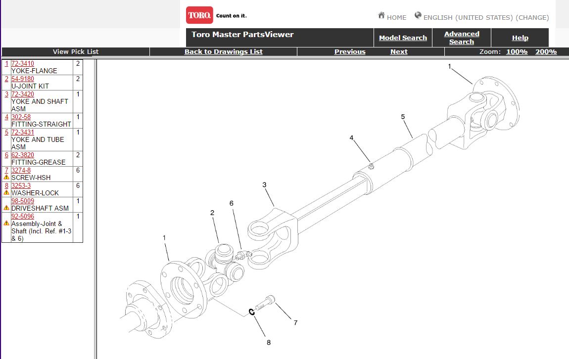

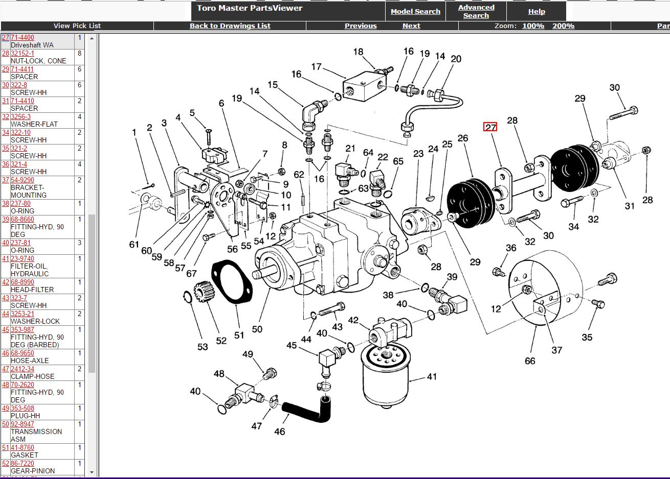

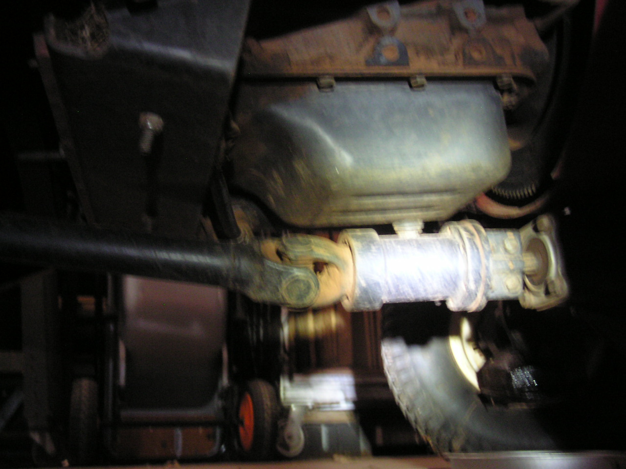

I have a 1998 325D Toro Groundsmaster 4x4. I can not figure out which way the drive shaft bolts in. There is a flange on each end - but they are the same.
I am sure the slip slide is supposed to be pointed one direction or the other.
Could anybody help me out here. I've been searching the internet for over 2 hours now. Can't find no pictures ner nothin.
   / any toro groundsmaster fans on here? #102

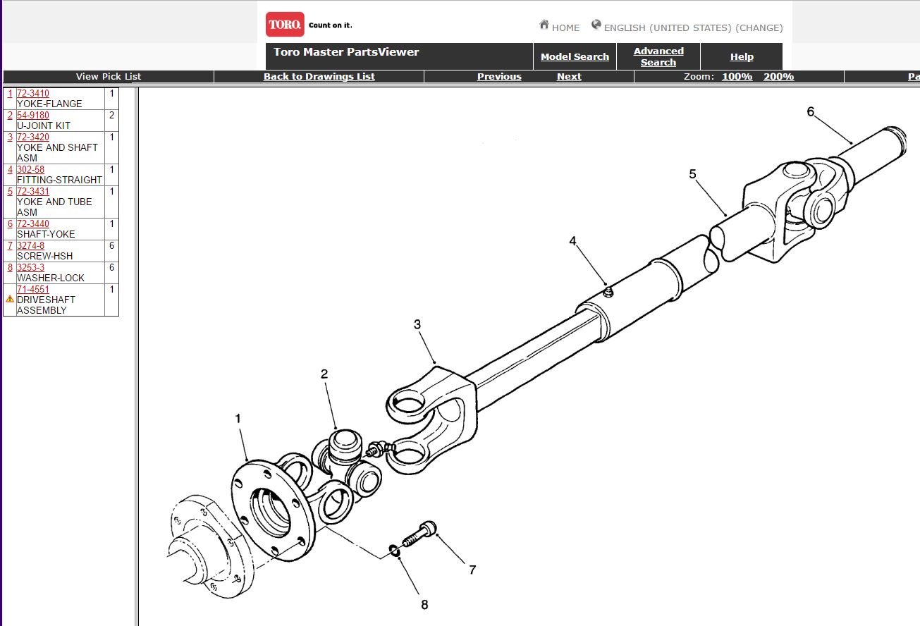

I have a 1996 325D Toro Groundsmaster 4x4. I can not figure out which way the drive shaft bolts in. There is a flange on each end - but they are the same.
Here is the parts viewer for your model 30795: Toro Master PartsViewer
This is the drive shaft to the front axle, but I don't know what you mean by "slip side"
The drive shaft to the rear axle can only go on one way.
   / any toro groundsmaster fans on here? #103
#4 in the bottom picture is the grease zerk for the slip slide. I'm sure it has a real name, But I've never heard it called anything.
My drive shaft to the rear wheels has part #1 on each end.
I do not know if part number 3 goes to the front of the machine or the rear. My 325D has part number 1 on each end. I do not have a part #6
   / any toro groundsmaster fans on here? #105
I found a picture that looks like #3 goes to the rear. I will go out tomorrow an check it. Wrong #3 goes to the front

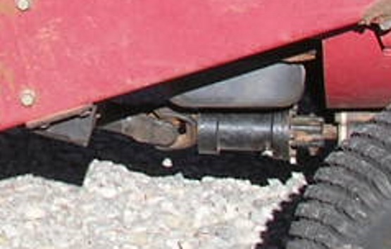

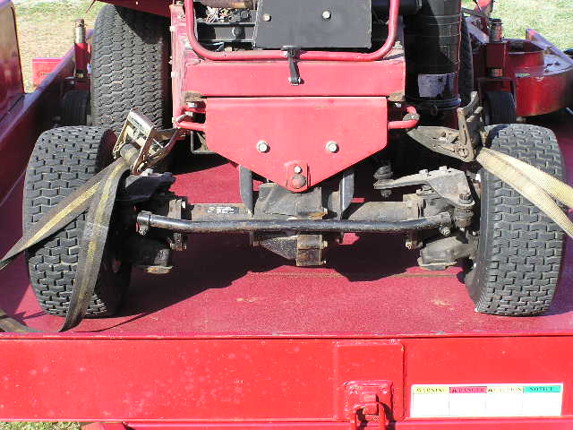

Close up of the drive shaft:

Toro 325D driveshaft.jpgFrom the post I made at Lawnsite. It does not say for my Toro but the driveshaft looks the same. I tried to attach a picture of my driveshaft

Not sure if this is the same, but check at about page 194, slip joint looks to go to the front.

Here is the view from the left side, no flange, the slip end goes to the front.
Here is the driveshaft from a 1997: Toro Master PartsViewer
#3 goes to the front.

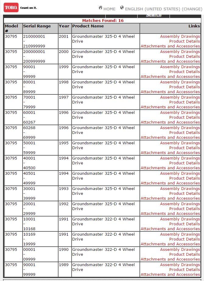

Here is the serial number list for the 325D 4WD model 30795: Toro Master PartsViewer
   / any toro groundsmaster fans on here? #109
Thank you very much. Apparently my Toro Groundsmaster 325D is a 1998.
