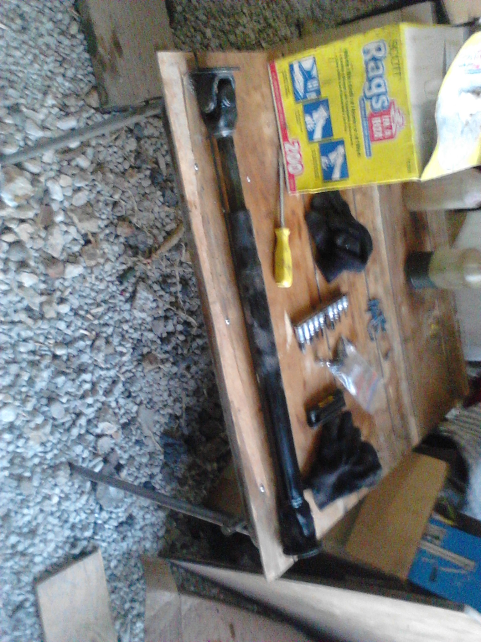

View attachment 485718From the post I made at Lawnsite. It does not say for my Toro but the driveshaft looks the same. I tried to attach a picture of my driveshaft
sehitchman said: ↑
Toro is real good about putting all their manuals online for viewing and downloading. If you have a model and serial number you might give that a try.
https://media.toro.com/servicemanuals/05138sl.pdf
Not sure if this is the same, but check at about page 194, slip joint looks to go to the front.
http://www.lawnsite.com/threads/i-h...the-drive-shaft-bolts-in.461610/#post-5526600
Looks like you have part number 72-3741... which is a "full-time 4wd" conversion kit.
Basically, your driveshaft going to the rear axle is a direct link... as opposed to the one-way clutch mechanism that is pictured in Xfaxman's pics.
It doesn't matter which end you bolt to front or rear (it will work either). My best advice is try it both ways and check your clearances. Go with the direction that provides the most amount of clearance for the oil pan/etc.

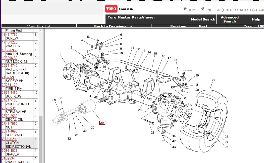

On my 1998 325D Toro Groundsmaster 4x4, Is there a way to turn the drive shaft, to check the oil in the bidirectional clutch, that the driveshaft bolts to, in front of the rear differential?
It says to put the plug at 4 o'clock for roper oil level. So far when I have been doing things I have had somebody there and just moved the mower while she watched or vice versa.

My one way clutch only engages going forward, if a front wheel looses traction. So to check the oil level, I put the jack on the frame behind the front wheel and turn the wheel, rotating the driveshaft.
On yours you would have to also raise a rear wheel, to allow the driveshaft to turn.
This is also a good way to check that the clutch is working.
   / any toro groundsmaster fans on here? #119
Here is the parts breakdown from the 1998 325D: Toro Master PartsViewer
# 29 is the bidirectional clutch that the driveshaft bolts to.

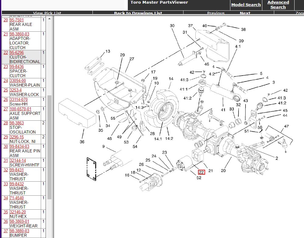

   / any toro groundsmaster fans on here? #120
The 328D uses a different rear axle, but the same bidirectional clutch, PN 95-6296.
