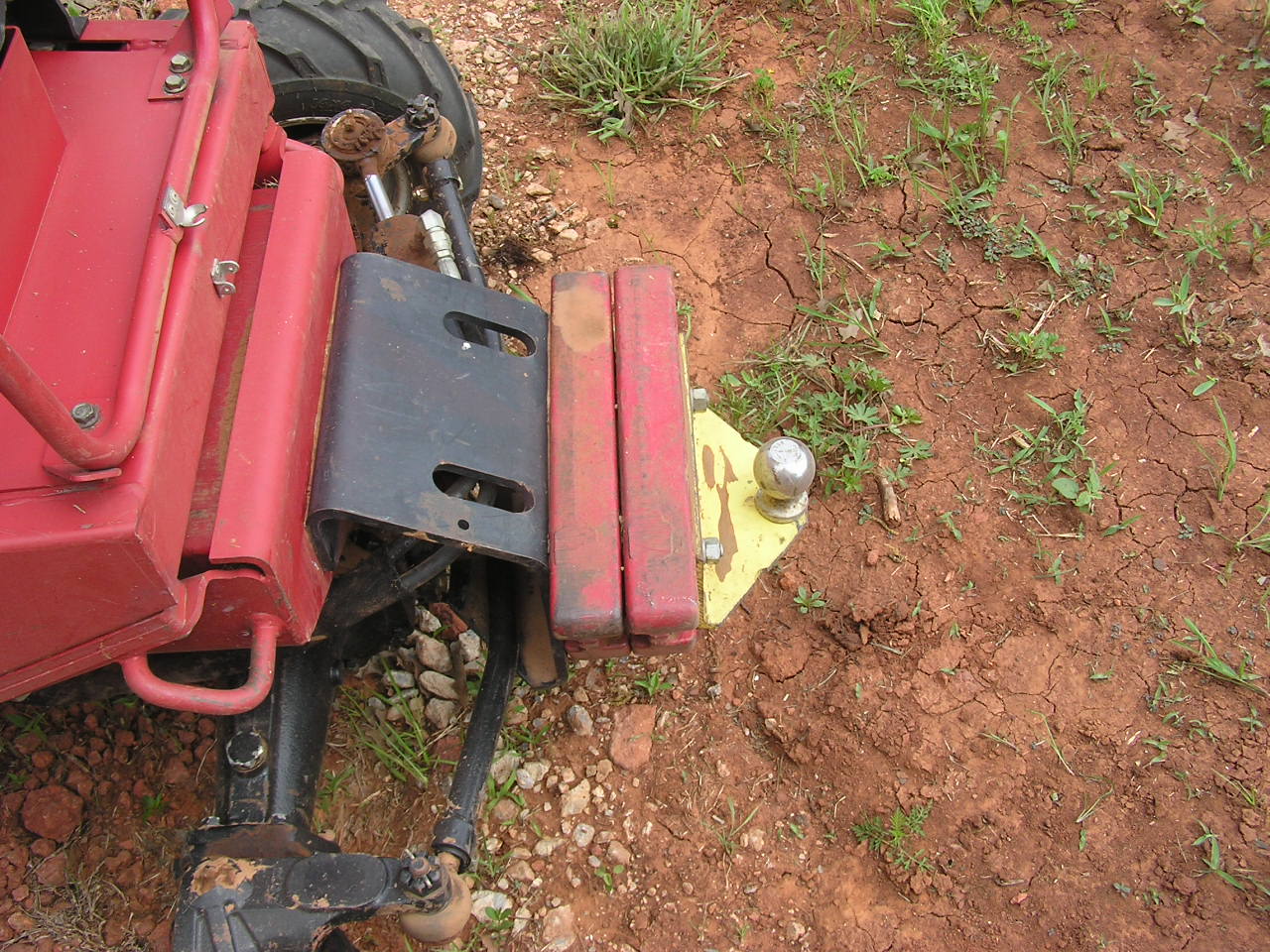

1/2-13 tpi. At least that is what they are on my machine. I used grade 8 bolts.
I had to make a spacer to clear the bolt that holds the axle support pin in place. I made it 3/4" thick, but I think 5/8" would have worked. 3 unistrut washers would also work. I liked the idea of one solid piece.
I don't know that with 2 weights you'd have an issue. With 4 weights I had bolts crashing and had to use 1 washer on the outside and just the right length of bolt.
The bolts thread into the weight inside the axle support bracket.
I saw a picture of a guy that attached a hitch with the weight bolts. As long as a guy wasn't using it much it would be OK. But it does make the machine that much longer

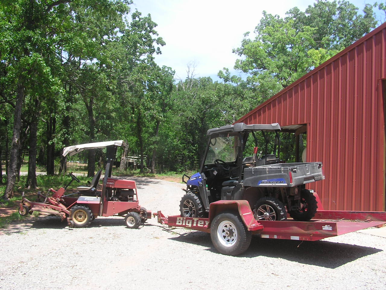

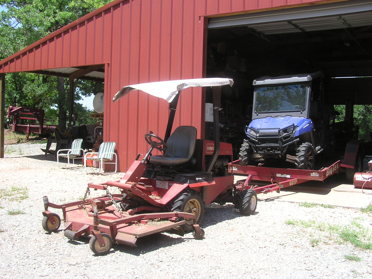

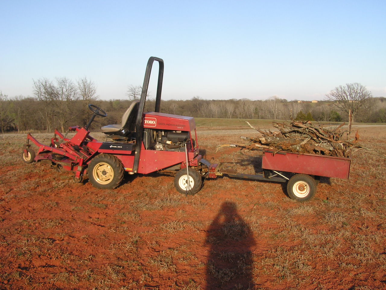

I bolted on a piece of angle iron to the weights so I could pull the little dump trailer:
Last week the EV right rear tire got punctured, hooked on the heavy 6x12 tilt trailer, drove out and recovered the EV.
Backed it into the shade to work on it. :thumbsup:
